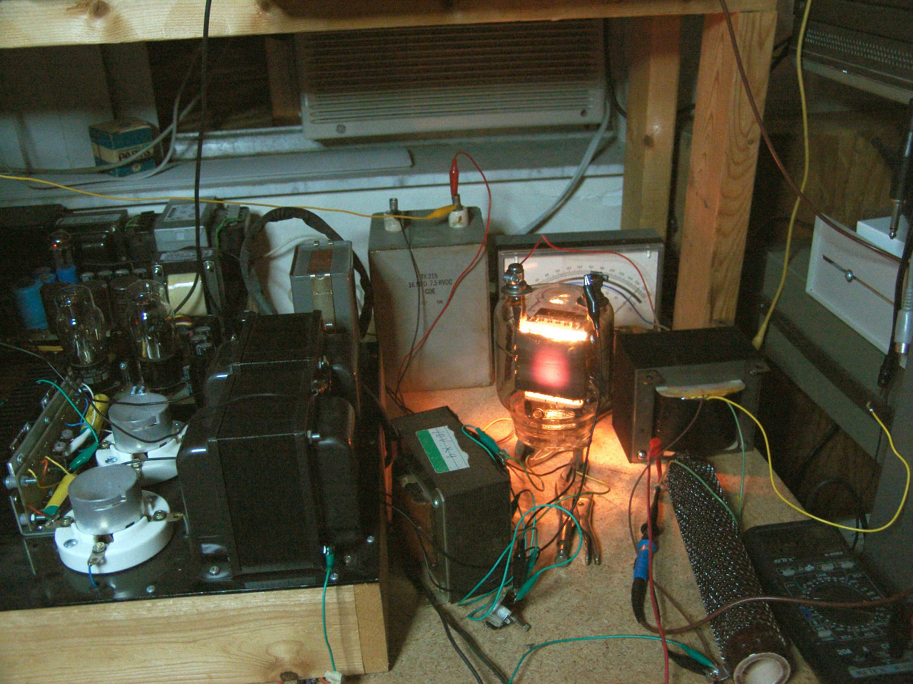

Hide one TI TPA3255 evaluation board (300 WPC Class D) inside a SMPS chassis along with a suitable SMPS, make it look cool and.....done. Meet your criteria?
Real Spud, 5 to 10 WPC. Take one of those "useless" beam triodes for TV HV regulator like a 6HV5, 6HZ5, 6JD5, or 6HS5, connect a power supply and OPT in the usual manner, ground the cathode and drive the grid directly with a source that has a resistance to ground (or add a parallel resistor). I used the headphone output of a Sony Discman portable CD player. Crank the B+ up until the desired plate current is reached.
Note that these tubes have a Gm in the 50,000 to 65,000 range and a Mu of 300 so not much drive is needed. You can't build a simpler amp and it works........
Drawbacks? Some driving power is needed since the tube is operating with zero bias. These tubes need voltage. The plate voltage required to get 50 mA of tube current? About 650 volts. I found that this voltage can be decreased by tying the beam plates to the plate instead of the cathode, but the clip lead furball kept breaking into oscillation. Bass was rather loose since the Rp of these tubes is high.
No further experiments were done.
