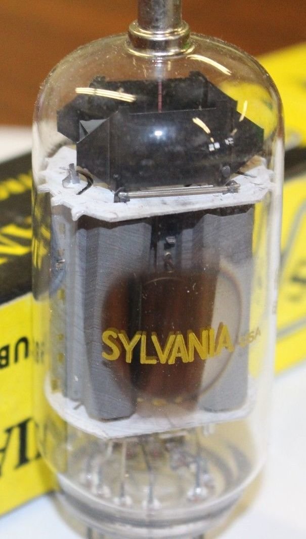

Use a 42/6KN6 tube (the older version with two internal tube sections) and self split that with a hidden Mosfet over a CCS tail into a conventional P-P OT. Maybe 40 Watts output in class A. Since it LOOKS like a dual pentode, bring TWO wires down from the plate cap and let them plug into separate banana jacks on the chassis. With a step-up input xfmr, could drive both grid and gate for twice the gain and P-P sonics (and twice the Watts out in class aB, no CCS tail then).

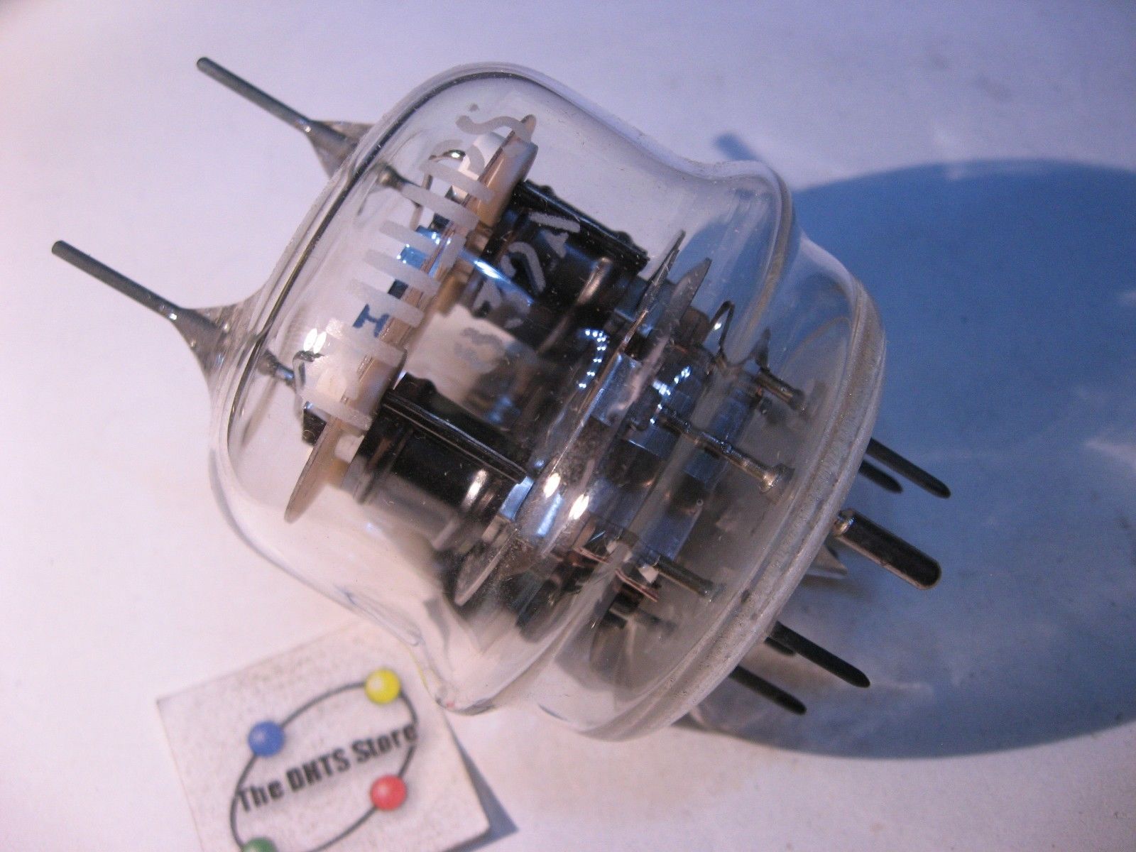

Lets see: 832A or 815A for two plate caps SPUD.

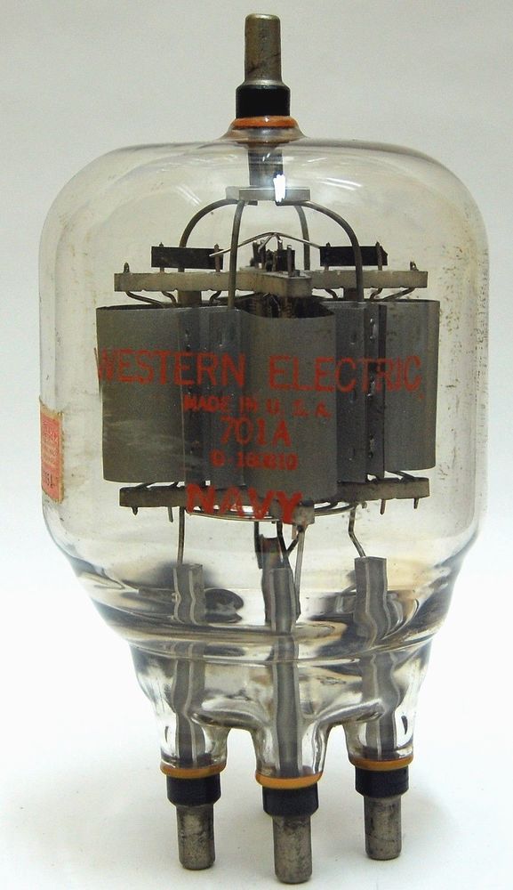

Or 701A or 304TL/TH for cheating 500 Watt STEREO SPUD. 4 plate cap wires (+ 3 Big Mosfets on back heatsink) (or 4 Mosfets for the multiplex case below)

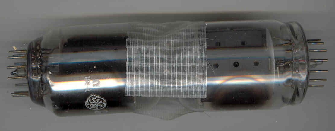

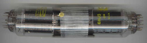

Introducing the new Raytheon double ended 6HJ5 (use a Teflon sleeve!)
Features a 12 pin plate cap with two 24 Watt beam pentodes inside.
And the new GE double ended 12GE5. (pre-production model)

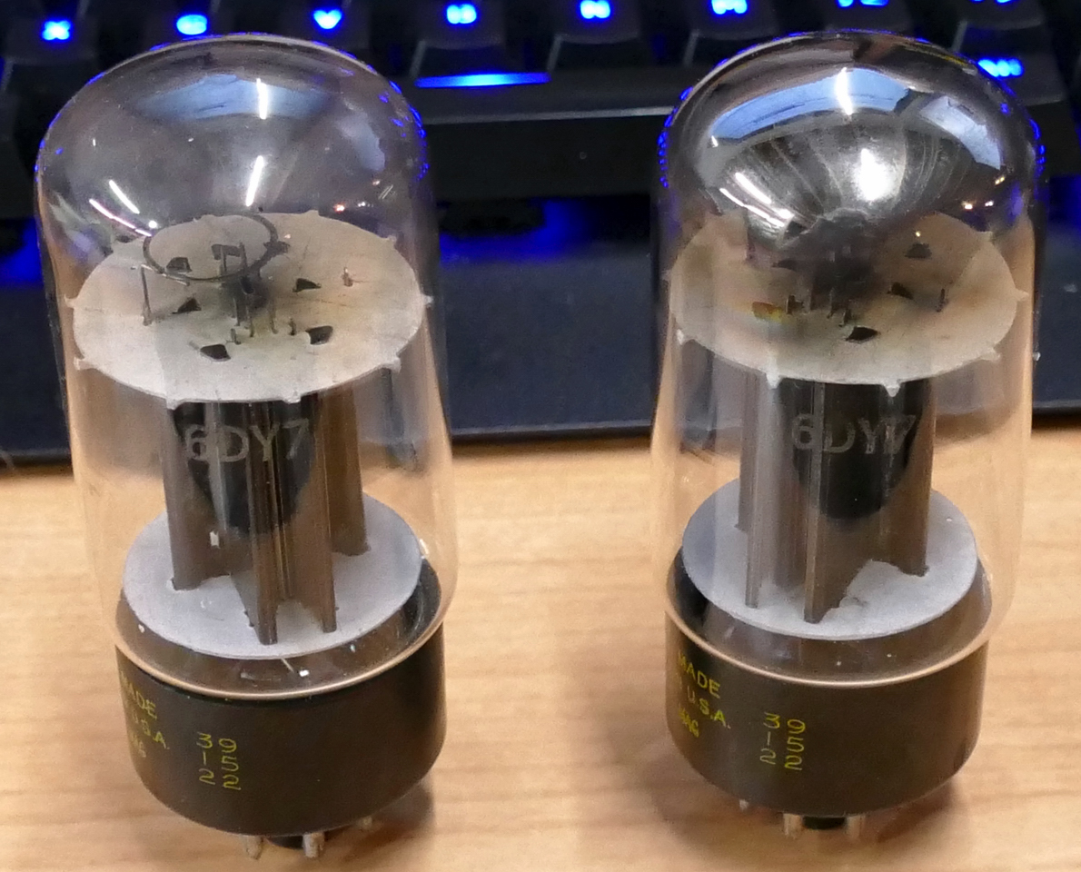

So we are taping tubes together. Why, when the tube makers have already put a pair of pentode audio output tubes together in a single octal bottle for you. Not once, but twice. The Sylvania 6DY7 will give you 20 watts from a single bottle. The GE 6DZ7 is rated for 18 watts of audio output from a single tube. Both are rather scarce today though. I found my 6DY7's. Don't know where the 6DZ7 is, or if any of these are good. One looks kinda toasty.

The 80 Watt 6KN6 idea was for using a hidden heatsinked Mosfet for the other P-P side in class aB. And 40 Watts was for a self splitting, class A, P-P using the hidden Mosfet. Hence the "Cheating" SPUD title. (post #1) Just rough guesses on the power capability. I don't even have a 42/6KN6 tube.

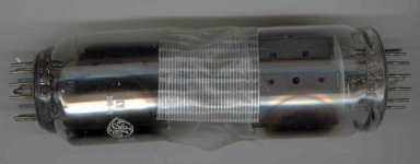

How about if I put two TV Sweep tubes in an evacuated "bottle" with feed-thru's, like below. Does that count as a SPUD tube?
Phone still not working. From 40,000 out of service last night, I got power back when it got down to 250 out of service this afternoon. Guess I'm not a real priority!
