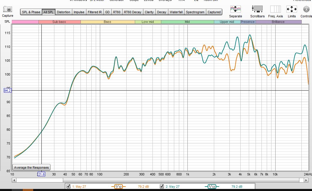

Well, your speaker may be cheap but your diagram is misleading because of the scaling. Peaks and dips over a range of 25dB (not counting the top end) isn't exactly HiFi. If it's just "I've got the cheapest" then fine, take anything from eBay or Alibaba and put a piezo on it.

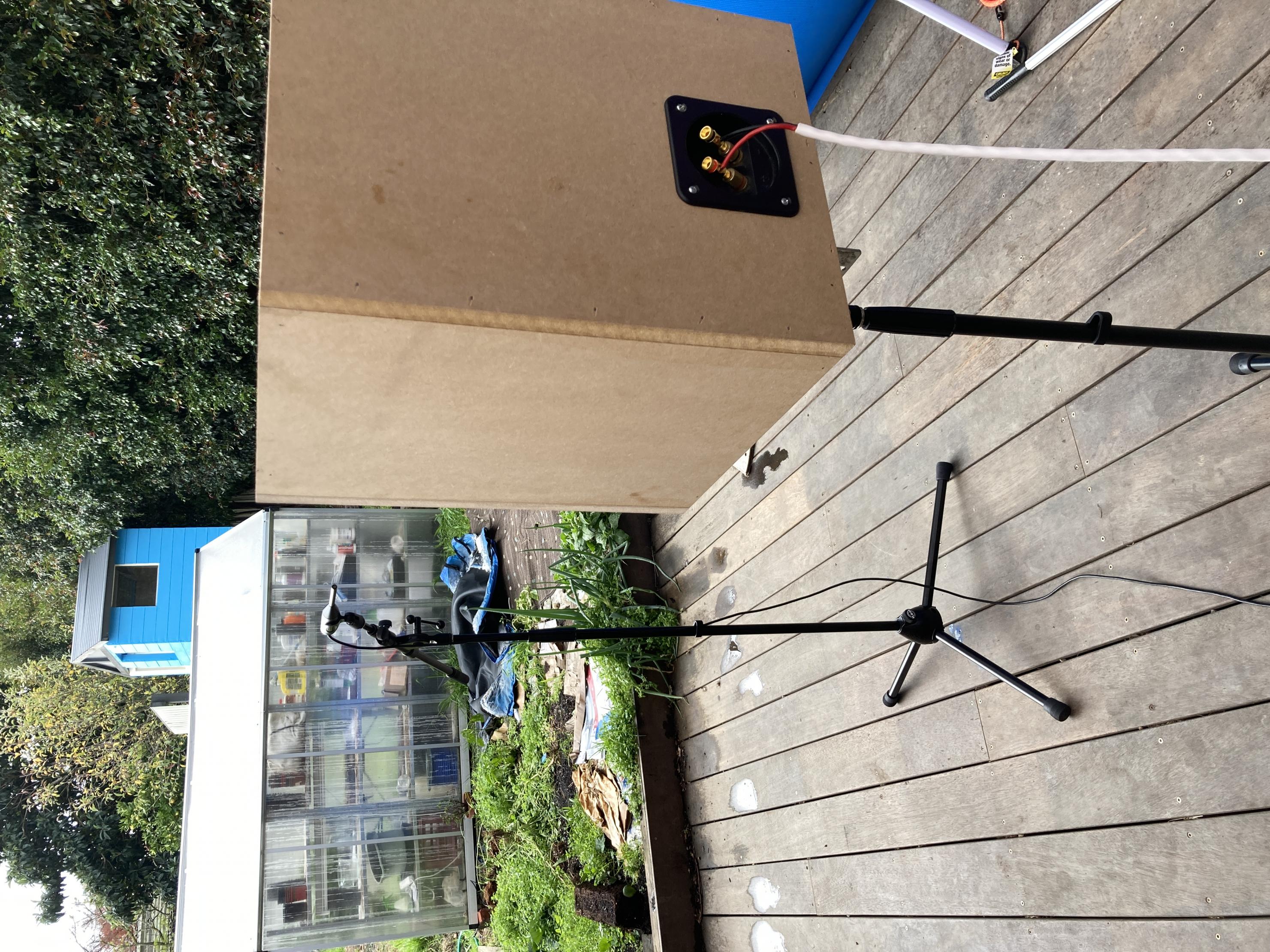

Aside from that, measuring a speaker like that:
954576d1621924703t-cheapest-speakers-build-roadkill-jpg
makes your measurements practically useless because of the reflections of the floor.
Baffle step, woofer only good to ~2K, tweeter from 5K.
Not good, these are not suitable together.
Time to try something else.

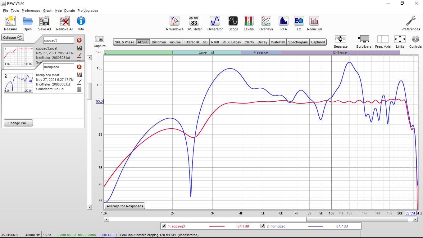

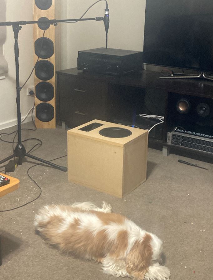

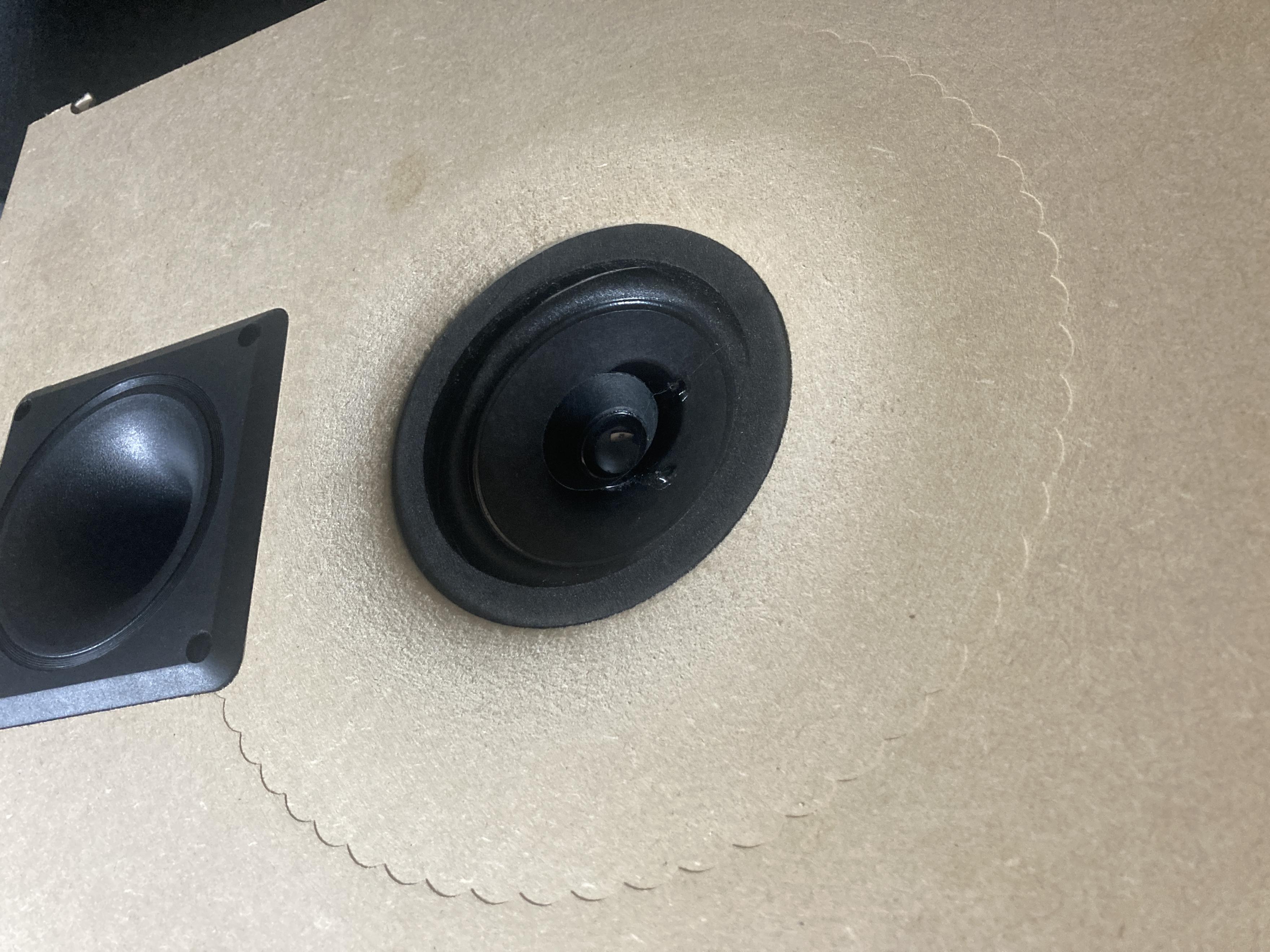

seems I can't find the Monacor SPH-60X here in Australia, The room I have for measuring is very small, what would you suggest as a direction? Or am I using REW incorrectly?
Set up the mic and the speaker how they got both the farthest away from reflecting surfaces like walls, furniture, floor etc. With a non-gated measurement of the impulse response the first reflection is visible, it looks very similar to the direct impulse but with a smaller amplitude. The window/gate should be set just before the first reflection. With the gated impulse measurement REW should be able to show the decay waterfall.
'Should' because I don't use REW, I don't know, you can find help and useful existing threads here in the forum. Alternatively you could have a look into the manual.

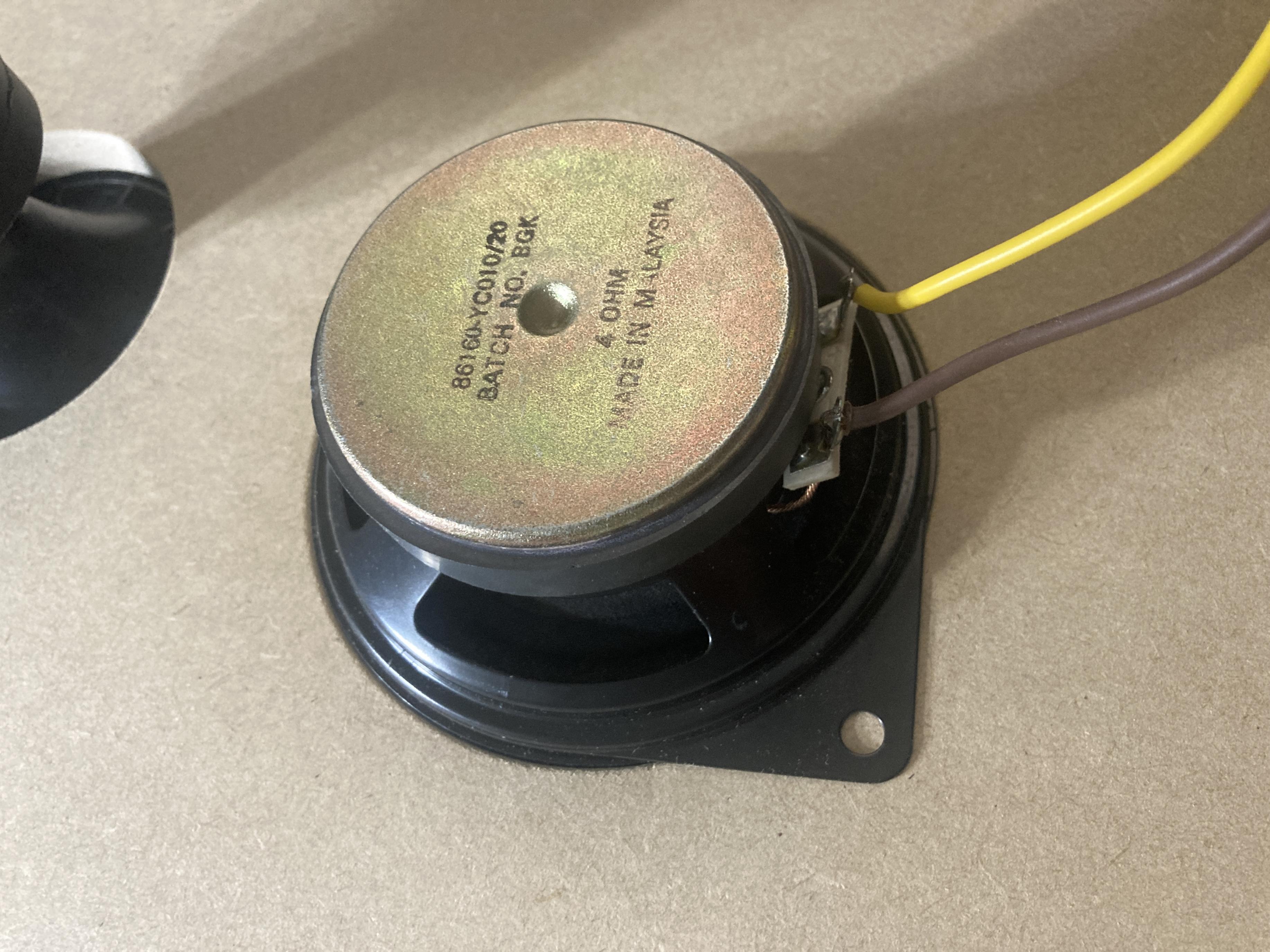

$5 ea, 3.5in, found at local junk store. "Pete's Bargain Centre"
Melbourne in 7-day lockdown, must drop past and see if I can grab some more before midnight
The piezo horn can be nice if you cross it over at 4+ kHz. A serial cap, calculate it (one of the few times you actually can roughly calculate something in a crossover) with a 22 Ohm resistor parallel to the piezo, use ~20 Ohm as impedance to calculate it, probably 1,5-2µF.
The fullrange should be able to reproduce treble at this size, looks like ~8cm. It could be a good fit for a PC speaker system. Nice work on the waveguide, really neat!

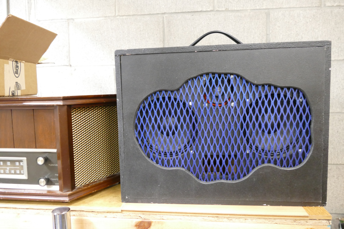

While not the cheapest, my build was made to a budget with three main goals:
It had to sound good loud since outdoor amplified loud music was on the menu.
It would be used for testing new and unpredictable amp designs, some of which are in the 100+ WPC range, so cheap drivers had to be used. High power handling capability is a requirement.
Small size and light weight is needed. One person can carry a pair.
I built these nearly 10 years ago. I did two outdoor concerts where each cabinet ate the output of a 125 WPC tube amp pushed to the edge of clipping doing PA for every instrument in the band except bass guitar and drums. We tuned the volume to match the level of a drummer known to beat the crap out of his drums. The bass player had a class D amp with enough power to knock people down.
Despite serious abuse I have not blown a driver yet, and have only needed to tighten the bolts holding them in a few times.
They are an MTM design. The 6.5 inch drivers are Dayton Audio PA165-8's. I got them when they were $20 each. The tweeter is a cheap "Titanium Bullet Tweeter" that came from one of the low buck vendors, Pyle I believe. The crossover is a few poly caps wired in parallel feeding an L-pad. I turn them completely off when playing a distorted guitar amp through these boxes.
Being used for testing here:
