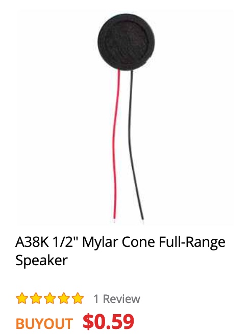

What is the objective of this thread? That isn't close to the cheapest speaker you can build but regardless, the entire premise is a race to the bottom. The "winner" is only going to be awful.
My entry: a naked open baffle full-range speaker for $0.59. I admit that it's somewhat SPL limited 😛

I guess 20 to 20k or at least as close as possible
You would need to set an envelope as well, such as the ubiquitous +/- 3dB.
Unfortunately your own FR chart only manages about +/- 7.5 dB from 20-20k.
As for my entry, my dog ate the chart 😉
