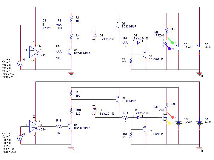

Better driver-curcuit
I Have siulated the performance of the totempole-driver but i cant find any serious faults with it. I tried to ad a lot of parasitic inductance but it only made things a wee bit worse.
-But anyhow i decided to try another driver-curcuit in the simulator. Two different schematics are added to this post. The top-schem is a little faster at turn-on because off the "kick/boost" from the C1, R2-connection around Q2. The timeconstant is so small that C1/R2 are only conducting the first 100nS of the switching action but the give a good kick to turn Q1 on faster.
C1/R2 does the "AC" switching and Q2 does the DC-switching...?
Both Curcuits seems to work fine, but they will be harder to implement with leaded components as there are more componets in the critical loop driving the gate.
Comments? Ideas?
Sim-results will be in the next post.
TroelsM

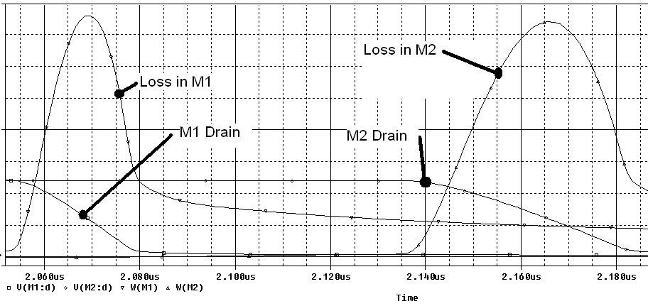

Sim-Res.
Here's the sim-results. The sim's are done without any parasitic/PCB-inductance.
M1 are clearly turned on faster and the loss (area under curve) is therefore smaller. Not a big difference but it's there.
The inverters in the sch might have to be made up off 2-4 inverters in parralel.
TroelsM
EDIT: just tried the totempole-driver from my original-schematic. It gives the same switch-times and losses as the best of the two "new ones". The Totem-pole is, as i mentioned before, a lot simpler to implement though.
