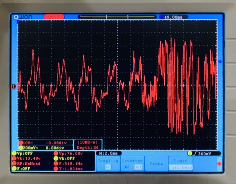

I just cranked it up to 100w on my TL speakers. Still sounded clean - party levels loud!
Some electronic dance music here at 76Vpp, no clipping to be seen yet.

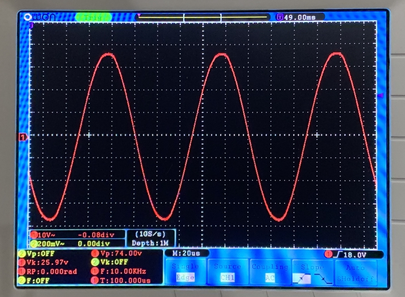

With a 300VA 32v trafo, I was able to get 74vpp into a benign 10ohm resistive load for 68w continuous. The voltage rails sagged to 38v under full power before clipping. Looks like you need a 40v traffo to hit the solid 100w+ continuous load.
