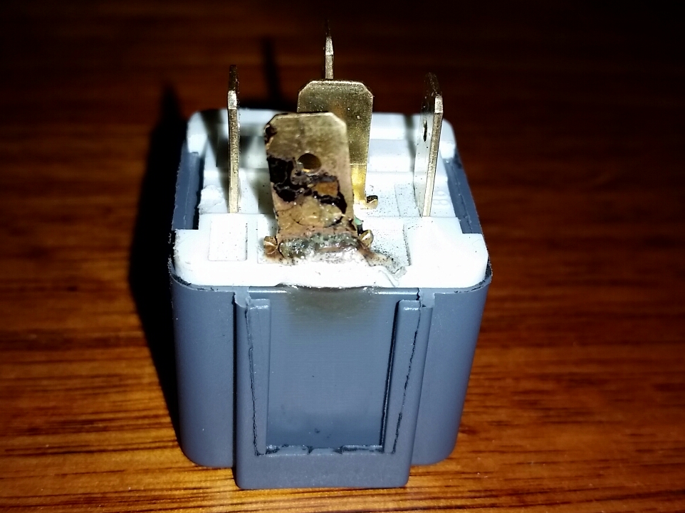

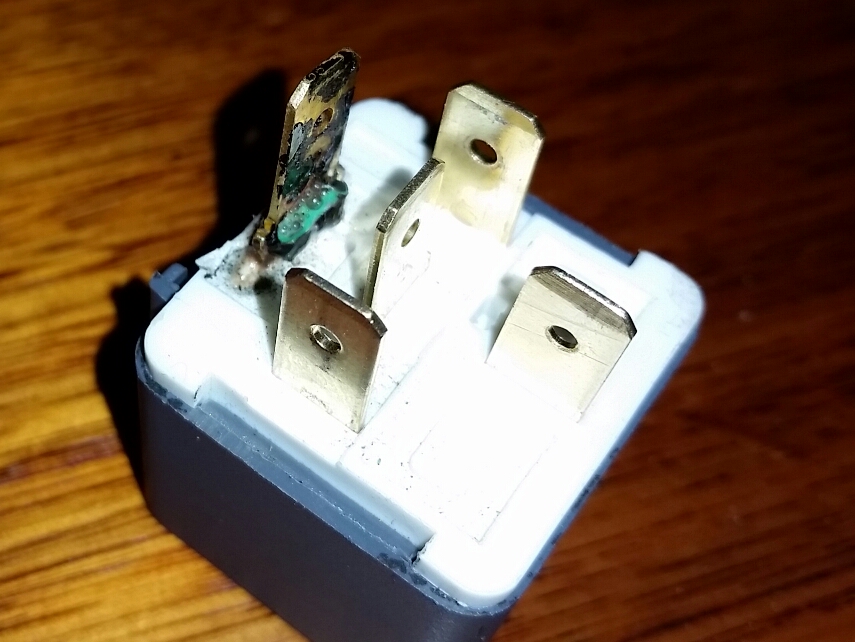

Well, the girlfriend's Ford Expedition (our family car) has been eating PCM relays off and on since March, and just this week killed two in one day (we carry spares) so it came apparent that it was time to fix it. Research shows that the issue is intermittent/poor connection to one of the terminals on the relay, causing them to overheat and fail, and apparently it's a pretty common issue with 2003-2004 Expeditions in particular. Pulled the fuse/relay panel, and found a pretty oxidized connection on the board, with very loose contacts, and a broken solder pad connection to the trace. Cleaned the contacts, used needle nose pliers and squeezed the connector to provide better tension, and added a wire jumper from the solder pad to the trace. Fingers crossed, but I'm pretty confident it should work now. Worse case, we spend the $300 on a "new, improved" fusebox that "may" fix the problem.
Car started right up, so that's a good sign 🙂

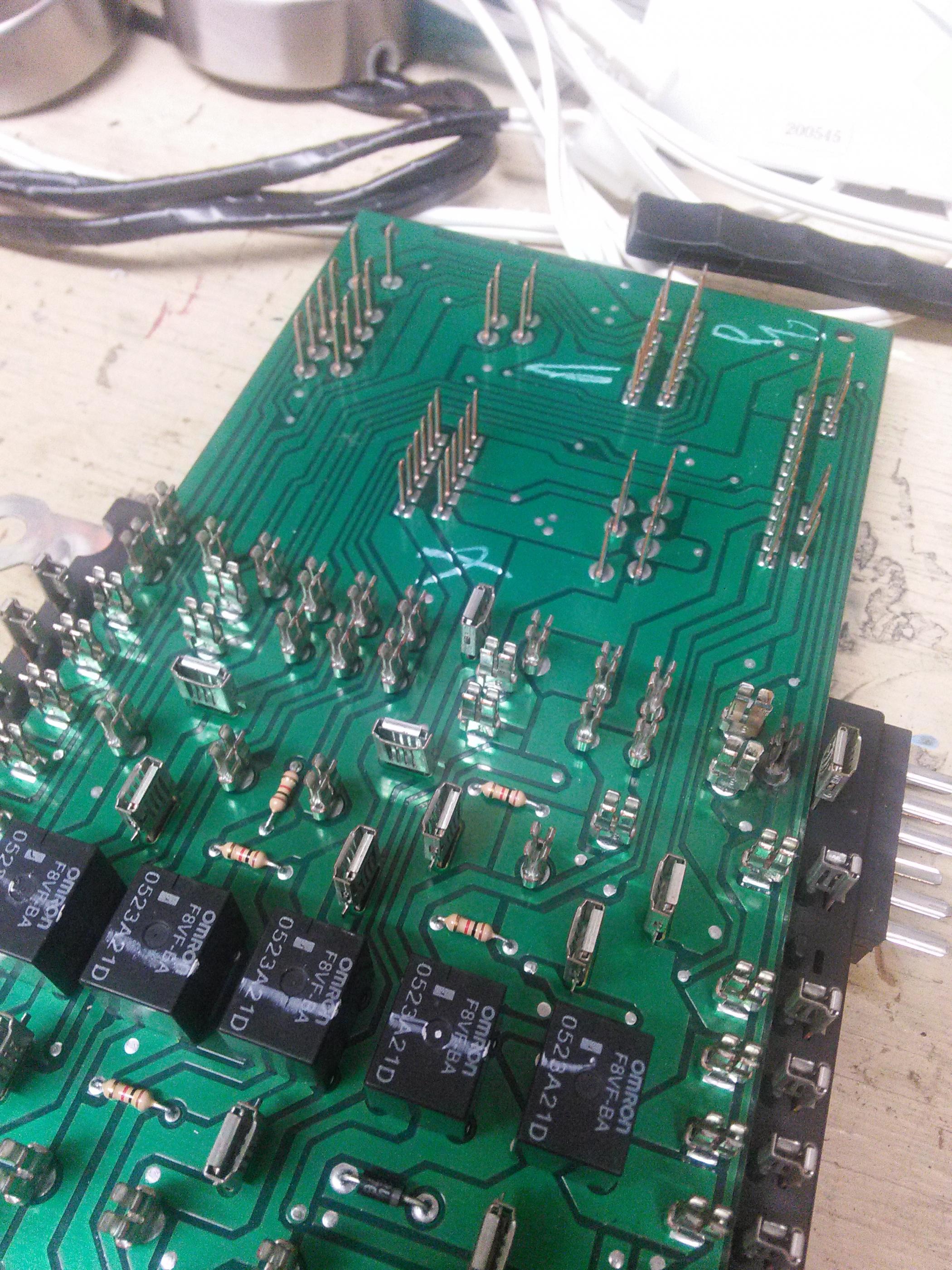

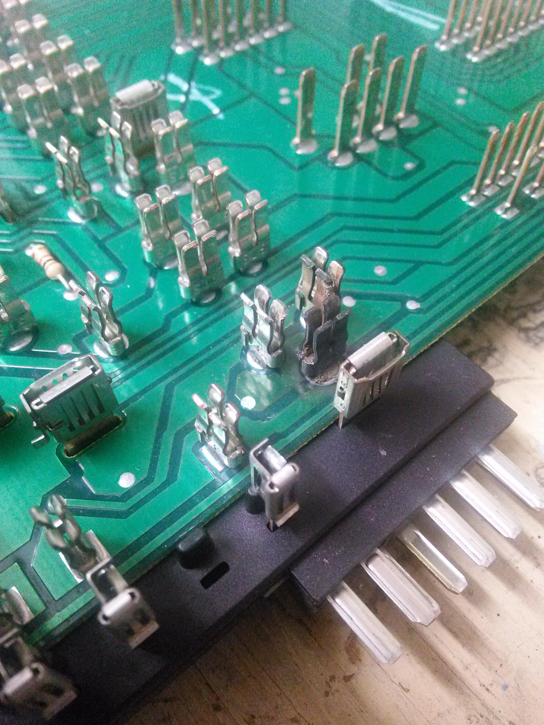

I recently had a melted relay and melted 30 amp fuse due to oxidised connections!
I'm going to be putting in a separate start switch to bypass my dodgy ignition switch tonight. Key will still be used for unlocking the steering and the normal ignition functions, just a separate switch to press for the starter.
I'm putting in a relay so that it can only be done whilst the ignition is turned on as well (not that the car would start without the ignition, but figured a big red button my be tempting for little fingers which would not be good if car was in gear!)
