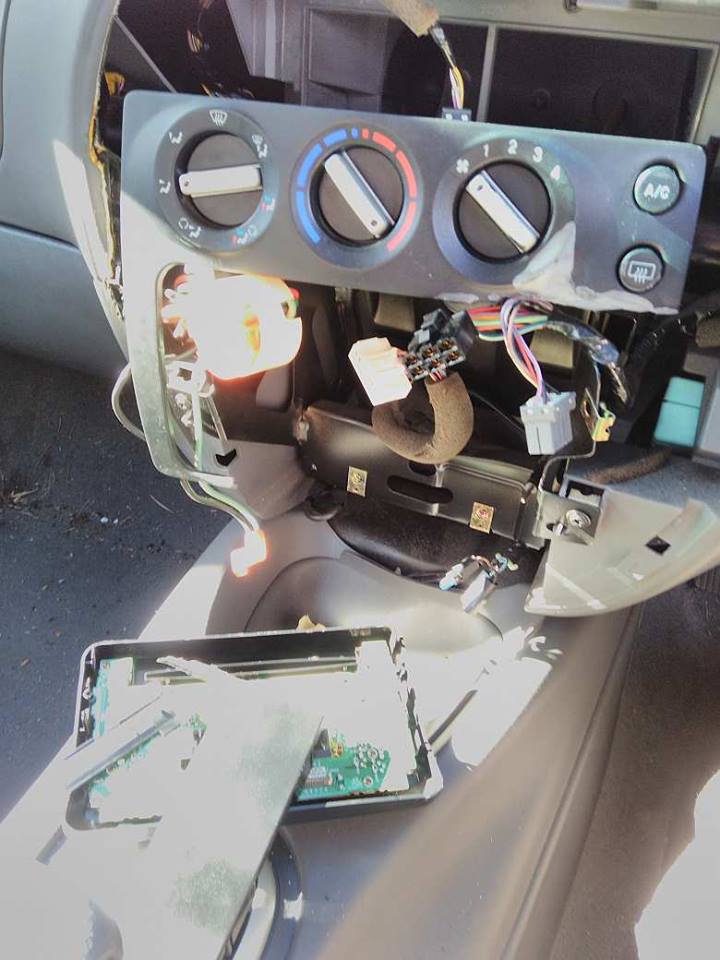

I'm trying to replace the heater blend door motor control on a 2005 Mercury Grand Marquis (Ford Crown Victoria) without removing the dash. 😱 I've made it far enough to get a visual on the offending assembly. but am having trouble with three fasteners attaching it to the air plenum.
I hate dash work. I remember just assuming the flasher was on or next to the interior fuse block of my Ford Contour as it is on most cars and disassembing a big part of the dash before googling it to find out it was underneath the steering column trim.

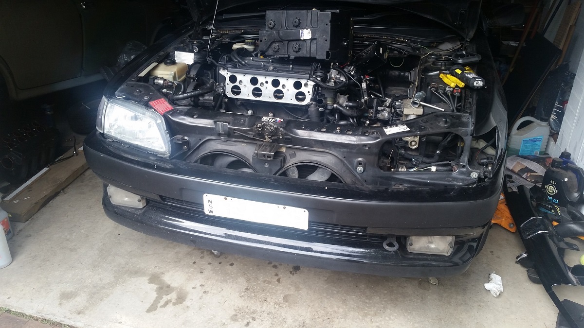

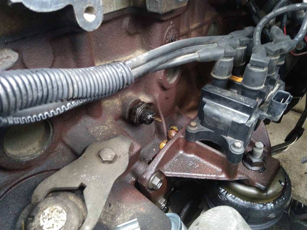

And here is the job that I done replacing the oil pressure sensor:
It was a lot easier once I got the fuel rail and intake manifold off. The coil pack being underneath the intake manifold and fuel rail is just another silly design flaw by ford. Its virtually impossible to remove the coil pack from underneath the car or from the top because the intake manifold is so huge and you cannot get your hands in to do the job. Its a sort of job that if you were to do it without removing the intake manifold that you would need those ratcheting swiveling o ring spanners and get to it from underneath while its on a lift.

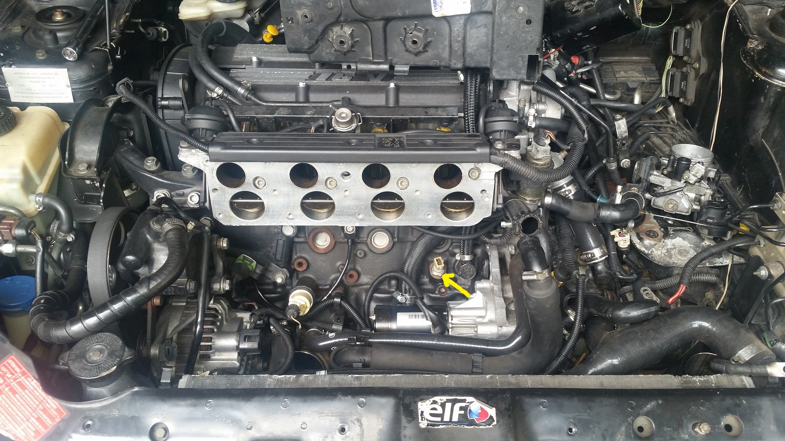

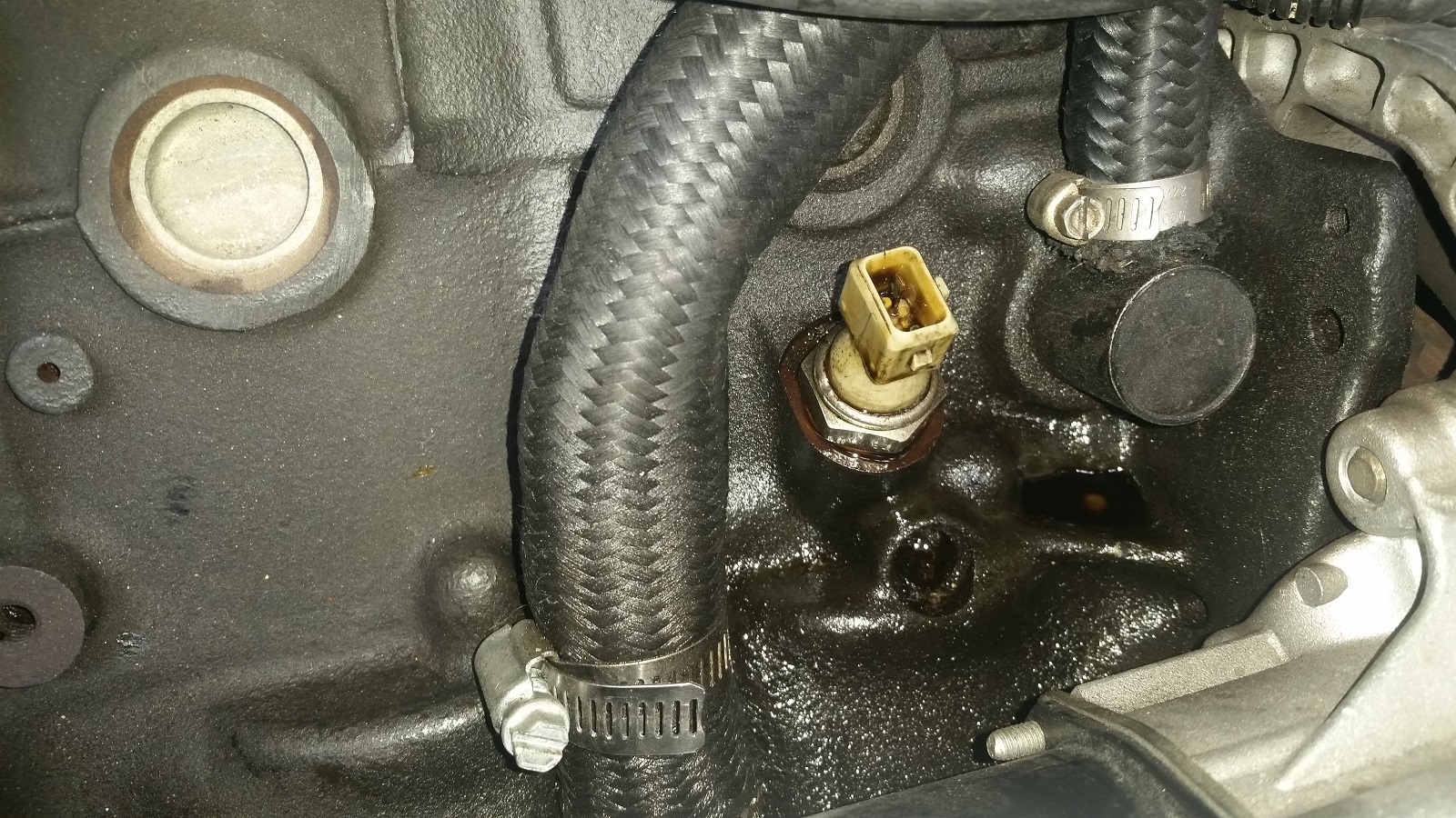

Looks like yours suffered the same fault as mine! ie sprung a leak and pissed oil everywhere!
Similar drama's to do mine (if you think fords are bad try working on a French car 😉 )
I've got it down pat now (having pulled the gearbox and the starter motor as well).
Battery box out.
grill off
headlight out
throttle piping off
Throttle body off
Inlet manifold off
Ah that's better!
I've learnt with the pug, if anything at all is making access difficult it is best just to remove it!
Oil pressure sender arrowed.
Tony.

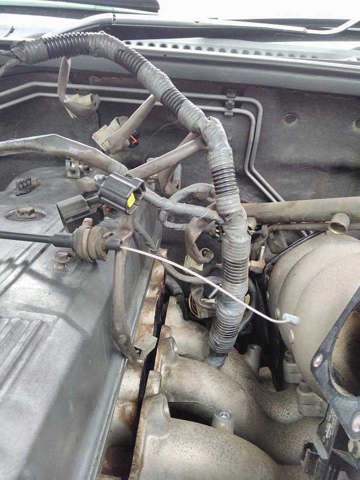

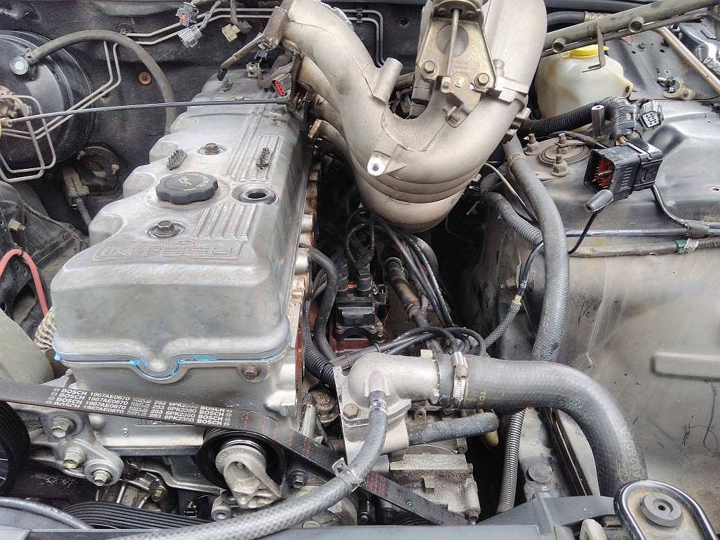

haha neat.

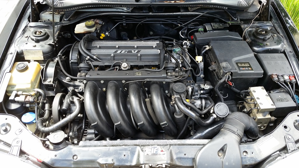

Though On mine you cannot remove completely the intake manifold which disappointed me somewhat because I wanted to clean it out and replace the gaskets, because the wiring assembly goes through one of the gaps. To remove the intake manifold I bet you would have to remove the entire wiring going all the way back to the gearbox, or cut a notch in the intake manifold where theres a bit of streghtening/stiffening metal that goes across between one intake plenum and another.
Thats why in the first picture the intake manifold isnt completely removed its just crocked up there on the side of the head.
You can see in the second picture where the wiring assembly goes through the gap between two of the intake plenums. You would think to yourself that you can simply feed the wiring loom through the gap or simply move it to the left, nope, because there is a huge connector that is on that wiring assembly and that connector doesn't fit through the gap. Goodness knows how they managed to get this thing together the way they did at the factory, I guess it was all made in combination with the intake manifold.
Anyway I cleaned the intake ports out as best as I could with some degreaser and a wire brush, replaced the oil pressure sensor and put it all back together.
Mine comes off completely with the removal of a few vacuum hoses. The first time I pulled it off was at about 245,000KM it was really really gunked up inside! The crank case breather circuit puts quite a bit of oil vapour through it over that many KM!
