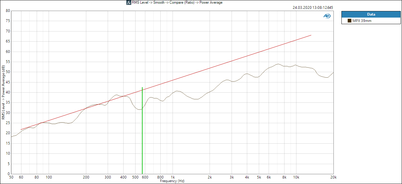

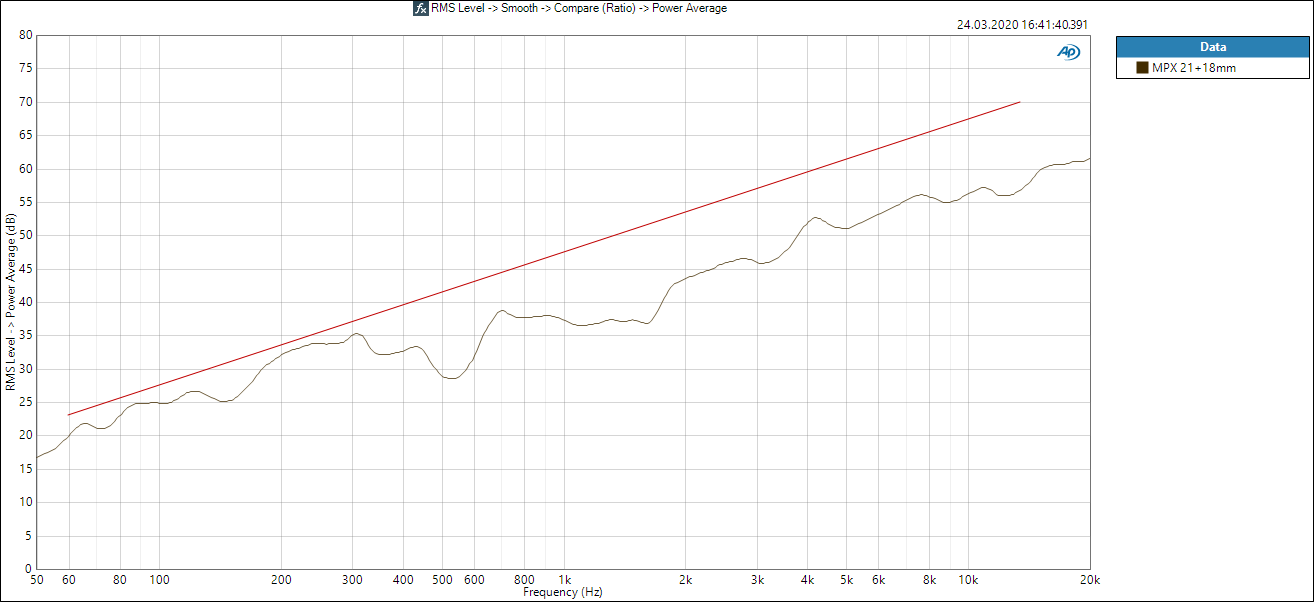

MPX 21mm + 3mm rubber + MPX 18mm vs MPX 38mm

Graph says what? Acoustical measurement close to side wall? Box size (approx.)? Old measurements from 2020 ! (date of graph upper right corner)
Please elaborate further ... how much damping have you achieved compared to which level? (at listening position)

Maybe the convincing result of the Acoustic Energy AE500 in the video comes from the total 3-layer construction (CLD) for all cabinet walls!?

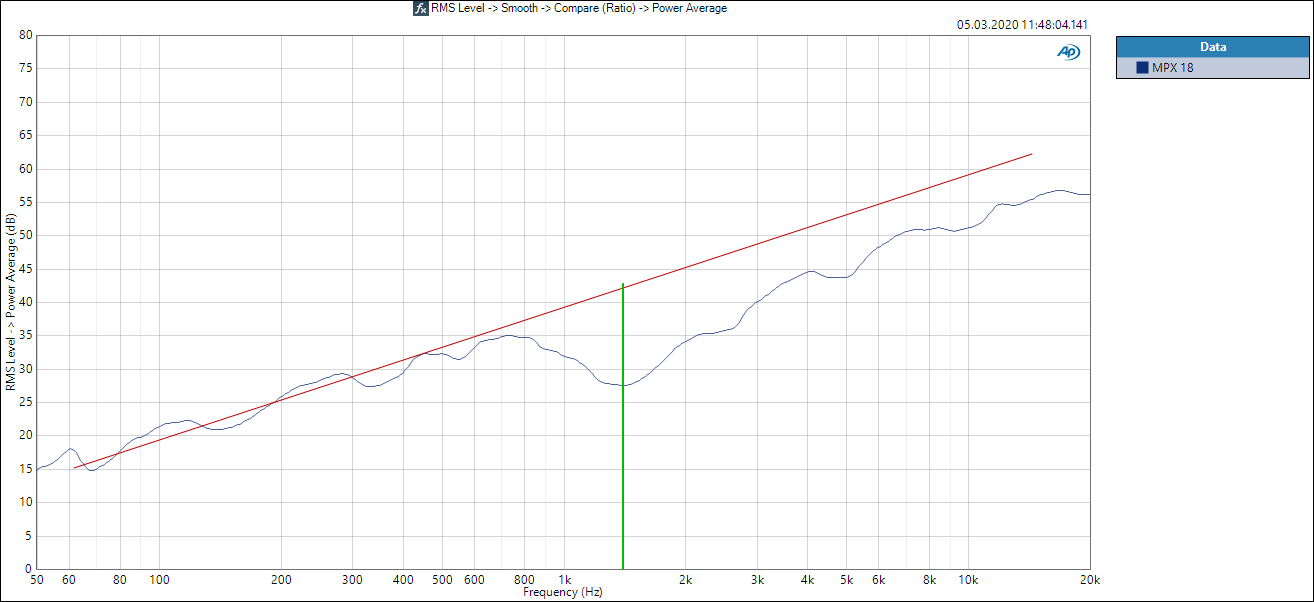

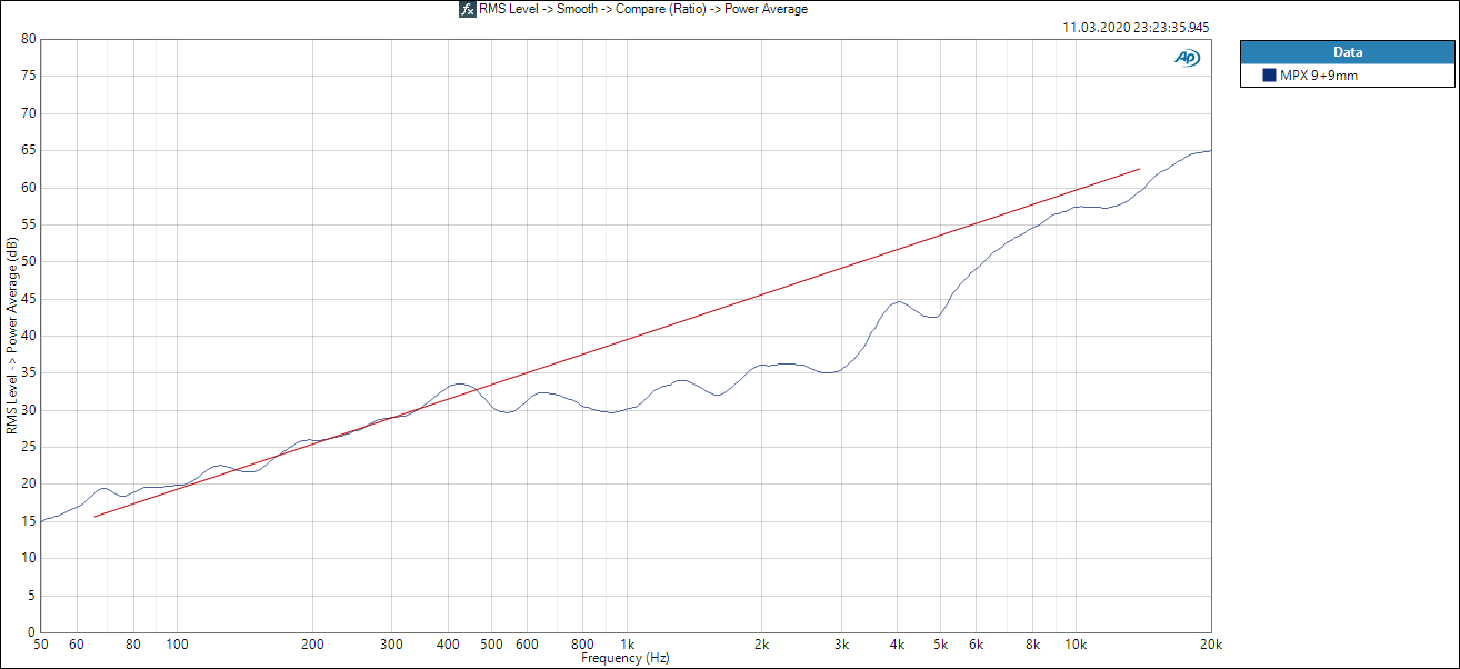

This is dampening of air sound waves of material sheets of about 1x2m size.
Red line is the Berger's mass law theoretical value, green line calculated coincidence frequency.
That's the behaviour of the material alone, not an enclosure with bracings or edges or other influences. And it is surprisingly close to the theory :cool:
Just to get a feeling how much different materials differ.
