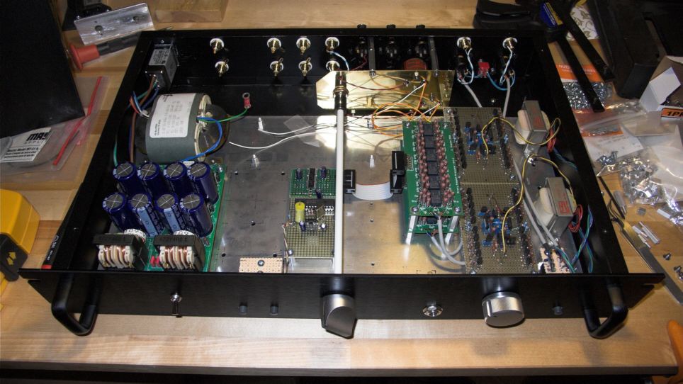

jacco vermeulen said:Any chance of a Chad-UGS close-up pic ?
Even more interested to hear how it held up against the DumpLin and STUSY-tube pre's.
Unfortunately, we did not do a straight-up comparison between these pre's. The C-UGS was off in the side room, and hooked to different amps and speakers. I didn't take a close-up at the event, but here's one I just took now:
To the left side, you can see the power supply, which was not hooked up. This is a flying-cap supply, which provides two floating outputs from a single secondary winding on the R-core trafo in the back corner (bought surplus for $5). Next to the FC supply is a spot for the 12V supply. Hence, the bench supplies I used at BAF.
Center-rear is the input jacks (not all wired up yet), with rotary input-select switch mounted on the brass sub-panel. Also mounted on the sub-panel are the Cinemag input transformers.
Front-center is the PIC volume controller I hacked together in the days leading up to BAF. It merely reads a voltage from a pot behind the volume knob, and drives a pulse to set the latching relays in the stepped attenuators, connected via ribbon control cable to the right. Once the relays are set, the control outputs go high-Z, so there is no (well, less) noise transmitted from the control circuit via stray C. Each attenuator board is mono, fully balanced, but I designed the PCB such that it can also be configured for stereo single-ended use.
On the right side, we have of course the C-UGS prototype perfboards, wired up through CMOQ-3H output transformers. A switch on the front panel will connect the secondaries to either the headphone jack or the rear outputs, but always leaves the rear outputs tied to a 600R resistor so that they don't go open-circuit when you select headphones. Zero DC on the secondaries also guarantees that there are never any switching noises, unless the power amp input has some leakage current back to the preamp. Finally, on the rear panel, I included a ground-lift switch for the balanced jack pin-1 connection - either short to chassis ground, or AC coupled via a 10nF cap. This provides RF shielding at all times, but the option to break ground loops with whatever power amp may be attached.
The empty space in front of the brass panel is for the Rakk DAC mkII board I have, and an additional pair of standoffs will hold a small board with the DAC's LL1544a output trafos, configured as 1:4 step-up. The empty space between the control circuit and attenuators is for the main voltage regulators.
