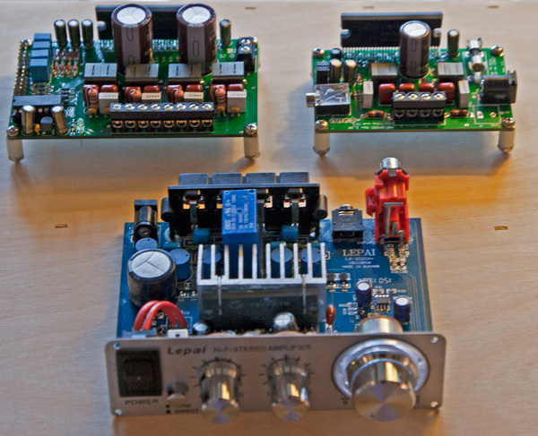

- My amp6basic came couple of days ago, yesterday i finished it and tested it. Works like a charm.

My amp6basic is not working properly as one channel is faultering but it turns out that it's the bad chip problem announced on 41hz. Have been trying to get in touch with Jan to get a replacement chip for over 2 weeks now, still no feedback what so ever concerning my matter. Anyone know this guy? Getting a bit frustrated as I'd like to finish the boombox...
How soon do you need a new TA2020? I have one that's never been used and guarenteed not of the faulty batch (it's one of the originals from Korea, not the newer ones from China).
Otherwise try to contact V-bro either here or on the 41hz forum (which is down at the moment as they update the website this weekend), he has good contact with Jan.
