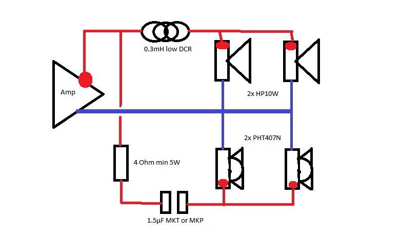

It's the filter I designed. I have since redrawn it.
Note that the 4 ohm resistor can exchanged or varied between 2 and 4 ohm depending on taste. Changing the resistor value between these values doesn't really attenuate the tweeter response as a whole as the lower total impedance at the same time also sets the cut-off higher resulting in pretty much the same overall response. It does however change the amount and shape of the very highest frequency boost which is there to compensate for loss at off-axis response at those frequencies. Also, people who generally prefer electronic music also tends to prefer that. Try it with 4 ohm and 2 ohm and see which you prefer. Or for example 3.3 ohm if you like. I prefer the 4 ohm as it gives the most natural sound with a distinct acoustic feel.

Additionally, does the filter still work properly with the way I have it wired? Which is 2 x hp10w wired parallel to one channel and 2 x pht-407n tweeters wired in parellel to one channel.

The filter I have designed works best on a single channel. It is optimized for how the two filter parts affect eachother. Although you'd normally think that bi-amping is a bonus I don't think it's a good idea in this case unless you have an active filter, like a miniDSP, instead. Maybe save one of you amp6s for a future project (or keep as a spare)?

I cannot see any reason why you would want the dsp to feed a passive crossover. And I can see many reasons why you would not.
The trade off for using the optimized passive filter I'm afraid. It attenuates the response from basically low midrange and up so that it sounds balanced but with the drawback that it is obviously less sensitive. It's not more than a couple of dB overall though.
I suppose I could revisit it and make a new passive for bi-amp'ing but people that do bi-amp'ing also tend to use a miniDSP, so I'm not sure I can be bothered. Optimizing a passive filter is a long and tedious process of calculating, measuring, listening, tweaking and doing the whole thing over again several times until you nailed it.
The lack of volume can naturally be helped by using a more powerful amplifier. For example a TK2050 on 24V (which is the most common) or a TPA3116 on 18-19V (3x 6V SLAs in series or 6x LiFePO4 is series). Or the cAMP when that is finally ready for sale (which looks to be late winter/early spring now).
At aterren says above. You either use active or passive filters, not both, except in those special cases where you add a big series cap to the tweeter for DC protection, for example with extremely sensitive or fragile drivers.

I wouldn't waste your time calculating the specs for passive filter on a bi amp project. You have provided more than enough help.
