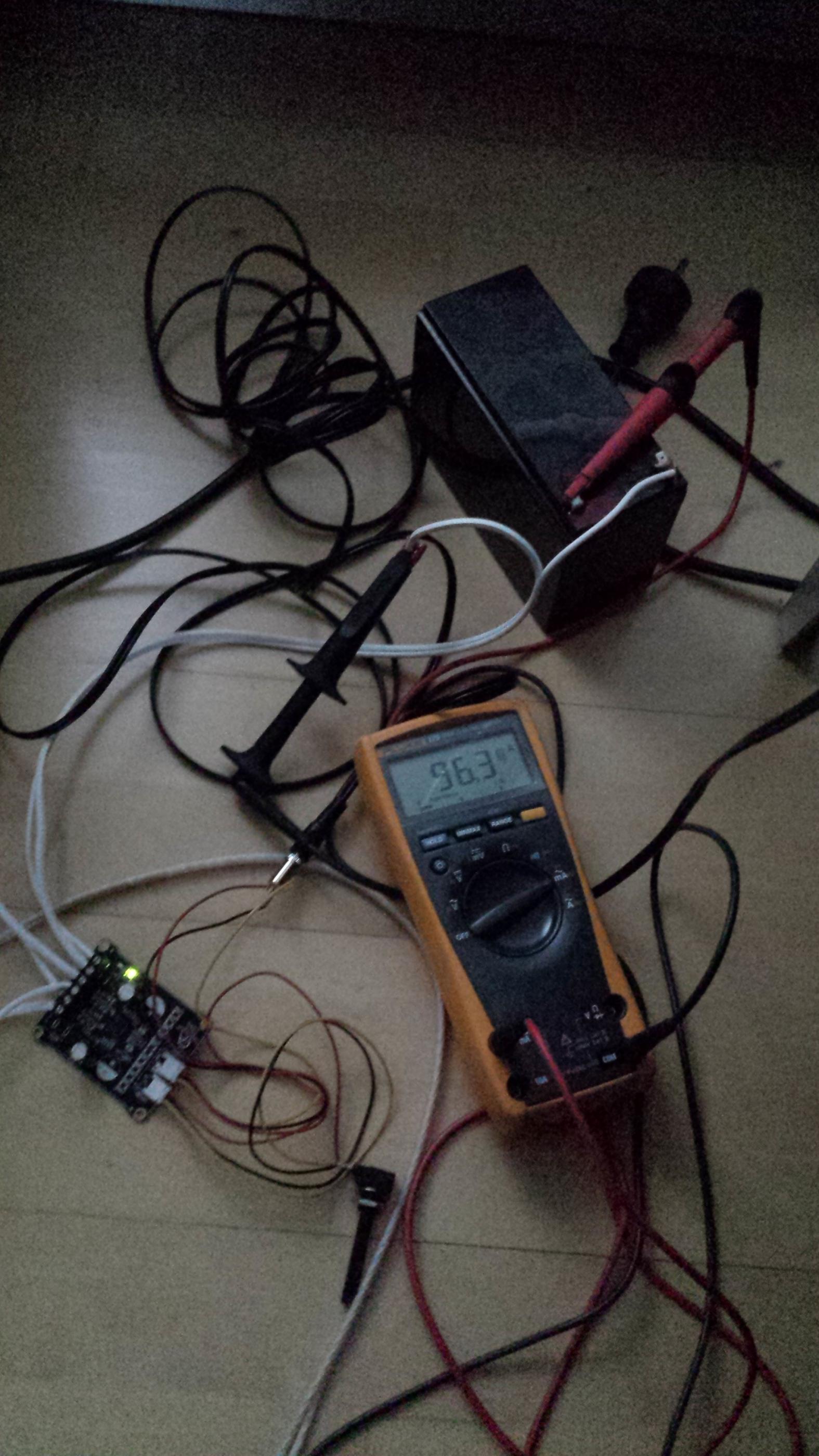

Maxamp20 idle current
Hello fellow builders!
A long time reader of the thread here.
I am about to build a halfinator and have recieved the maxamp20. I have just tested it with my home stereo speakers (8 Ohm) and i was pleased by the sound with my android phone, but not with my work phone (iphone).
On to the point: When i measure the current consumption i am a bit disappointed. I measured 100mA from no sound, all the way up to 3/4 volume. I read somewhere that it should be around 55mA. When i disconnected the speaker wires, the idle current is 45mA.
My question is: Is it normal to have the same current consumption no matter how high the volume is up to 3/4 of the volume?
Thanks!
My MAX9709 amp modules consume around 20mA with no load connected. (3mA are for the LED)
Thanks!
This might belong to your speaker-internal x-over or too long wires. Have you tried with a single chassis? Is the IC getting warm without signal?
doc
Thanks for your reply doc,
No the IC is not getting hot after 20 minutes of idling with current use of 95mA.
The speakers i use for testing is the B&W 685 with short speaker wires.
Guess i'll just have to make sure the boominator is turned off when its not playing music.
Regards
