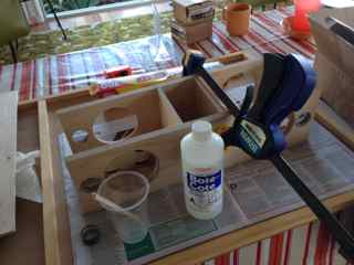

Started my Boominator Micro yesterday:
Laser cut enclosure
Electronics compartiment. Very thight fit indeed!
Glued the woofers to the baffle
Testrun
Bass is completely lacking at the moment but that should be fixed when the enclosure is airthight (I hope... ;p).

Looks nice. Did you add any stuffing to the enclosure? Saturnus said stuff fairly hard.
Yeah, pretty vital.
I will do that!

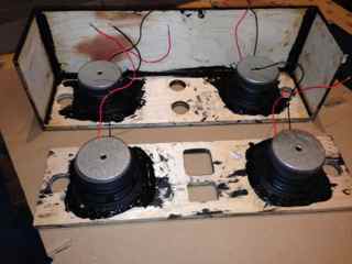

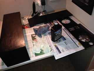

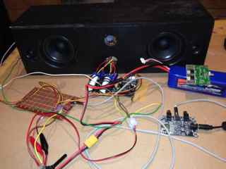

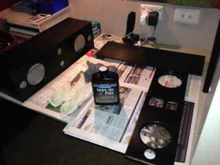

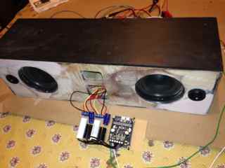

Mini v2 4 ohm build
Am building a mini v2 with 4 ohm sp60's because this is what I'd ordered on spec after misreading an earlier post. duh.
Only previous experience was also with sp60s in a ported enclosure.
Cutting out was a challenge, very difficult getting the cuts exactly right, but I did end up with perfectly square right sized pieces - major changes were to allow for a 73 mm centre compartment and an additional 1mm in the depth.
Thought it would be easier to build a half shell with boat building epoxy - more or less worked, but you really really need clamps that span the whole length. Ended up in a bit of a mess with epoxy everywhere, so cleaned it up and thought it might be better to stain it first. Bad move, because the stain need to be so dense I might just have well painted it.
Next was assembling the speakers. First layer was fine. Used Chemical metal and man that stuff dries hard. Second set was with chemical metal and fast setting epoxy gel, good idea but honestly there is not enough time, You would have hear my yells of panic km away. Stuck fine, but much work with bog and belt sander needed to fix alignments. And ruined the stain.

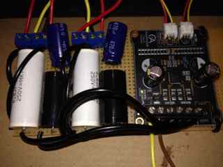

It needs to be bi-amped, and as I really don't know what I'm doing, so I've put the amp and cross over on a card. This fits well into the wider centre space and I can fix any mistakes.
Tonite I ran a test run. Inside of course, and not fully sealed without stuffing, but I'm blown away with how good this sounds. No idea yet how all this electronics will fit into the available space!
So for aspiring builders:
- this is quite tricky, take your time
- don't use 5 min epoxy - or if you do, do one bit at a time
- use lots of clamps and work out first where they will be used
