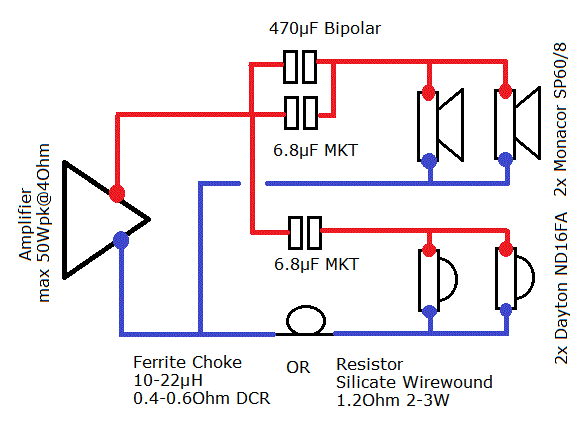

I'm finally back.
After having done extensive calculations. Scratching my head and redoing them a couple of times, I can now finally say that I found out what the problem was.
It turns out my calculations were correct all along and that WINISD online calculates both closed and reflex cabinets incorrectly. Please be warned about this. Please use a different cabinet calculator or use the actual formulas.
That means the sketch-up drawing already posted of the MINI is correct except that you might wanna exchange the double front with a single 12mm instead as commented earlier.
To the filter there's not much to say. It's pretty self-explanatory. However, I strongly recommend using the ferrite choke if you are using a "filterless" class D amp like a maxamp20 or a Sure TPA3110. Even if you are not it is the better sounding option but the chokes that match can be tricky to find.
The filter is for the MINI only. Another one will come for the Micro or a dual amped MINI. A dual amped MINI is basically to get the very most out of the speaker you can use the SP60/4 instead of SP60/8. That means each side of the speaker is effectively a Micro and so must be dual amped and use the filter for the Micro.

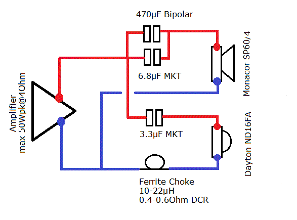

Boominator Micro DIY Filter
Here's the filter for the Micro. Note that here you must get the chokes.
It won't matter too much if the 6.8µF is exchanged for a 3.3µF so it's easier to buy bulk.
Any reason why the crossover frequency is now at 8000Hz instead of 3900Hz? Or am I missing something? 😀
Indeed. 😉
As far as I can tell:
The woofer has 476.8uF in series. This will reduce the hump from the small sealed box and extend the f0/f3 by 20Hz or so. I don't know what the effect is of the second smaller capacitor parallel to the larger one. Any comments on that? No low pass filter so roll-off will be the woofer's natural roll off.
The tweeter has 3.3uF in series. Being an 6ohm load this would result in a 8000Hz first order high pass filter.
I have no idea what the inductor does in series with the tweeter...😱
The choke is simultaneously a resistor. Read the 0.4-0.6 DCR requirement. And a resonant inductor to help the class D amp due to the very low self-inductance of the tweeter voice coils. It's also actually about 7200Hz as the impedance is only nominally 6 ohm. It varies. But really not at all. It's a very soft roll-off that is assisted by the cabinet diffractions and you must not forget the natural frequency response of the drivers either. Speakers don't reproduce flat frequency response curves. Far from it. Please consider all factors that can and do affect reproduction before designing speakers.
I guess I'm asking for when it was 3900hz as you imply?
Would a resistor in series with the inductor also work? As you said, a inductor with 0.4-0.6DCR is very hard to find, while a low DCR inductor + a simple resistor can be found easily.
They are not more tricky to find than I could find them on all major electronics suppliers, ebay and aliexpress within 2 minutes.
For example B78108S1153K EPCOS | Mouser

Yes, it is true that when cabinet is basically unknown and thus we don't know exactly what effects it might have then using a 6.8µF on a Dayton ND16FA crossed over to a Monacor SP60/8 is a good starting point that in most cases with achieve an acceptable result.
Here, I know exactly what cabinet it is in, the exact distance between drivers and so on, and therefore I can design the filter specifically for this.
They are more tricky to find than I could find them on all major electronics suppliers, ebay and aliexpress within 2 minutes.

Would a simple panasonic bipolar capacitor suffice for the filter or would you use a audio grade bipolar capacitor?
