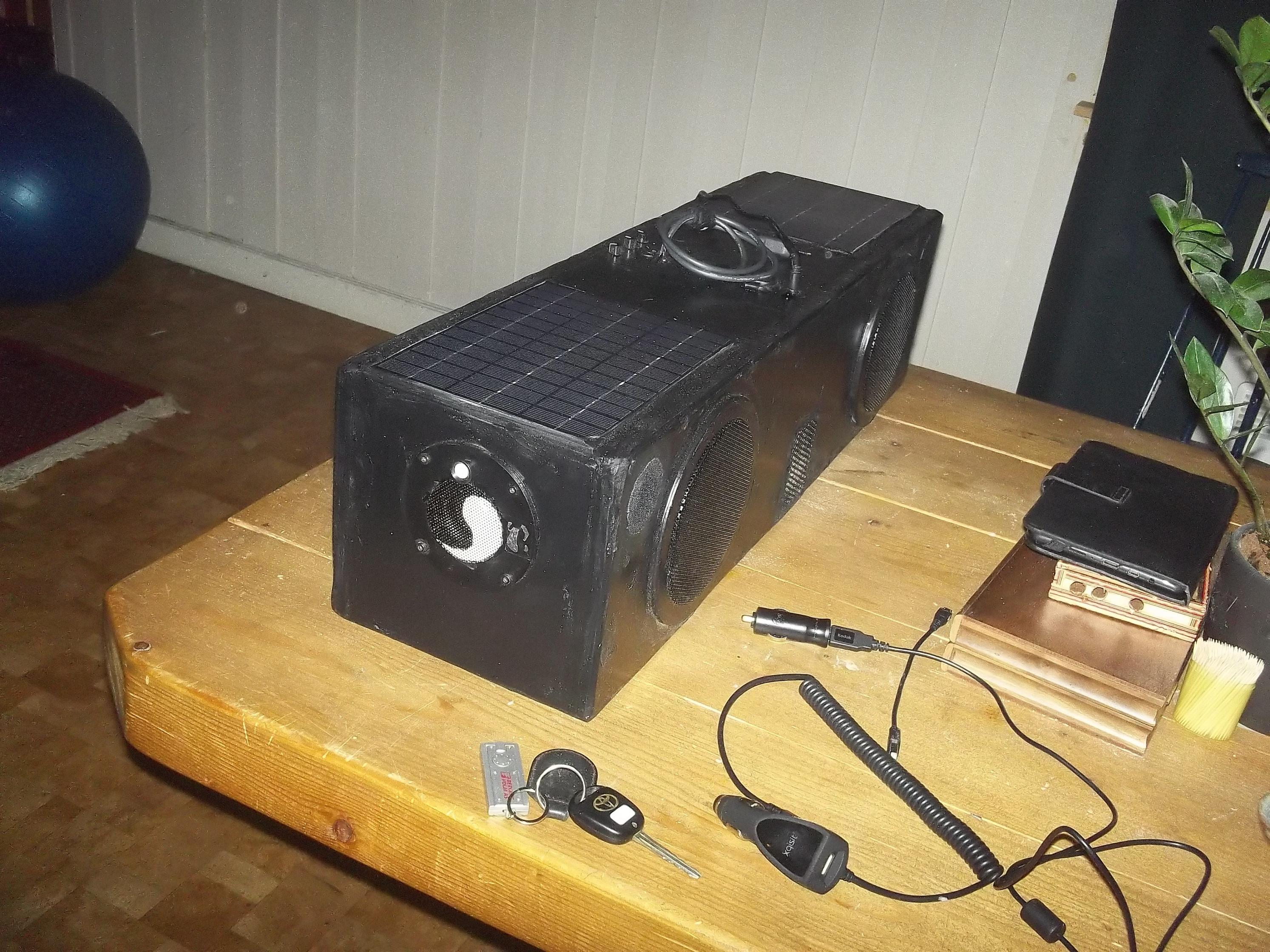

Hi i just finished a boominator mini version made from a pair of recycled floor standers. Its been a great experience, and the learning curve have been step.
For my next built i will attempt to build a boominator, with miniDSP and 2 maxamps, or miniDSP and miniAMP stacked.
Have anyone tried the miniDSP and miniAMP stack?
I will use a 12v 18a lead acid deep cycle battery and keep it relatively simple with On/Off, cigarette socket, analog voltmeter, and bluetooth.
I have ordered P.audio HP-10W and P.audio PHT-410 from Ljudia (They don't have the P.audio PHT-407n)
But i am afraid the P.audio PHT-410 is to wide and deep, and may cause increased diffraction and airflow problem in the port/handle area. How do i work around this potential problem?
I was thinking of mounting the P.audio PHT-410 from the inside, but might have to mount it from the outside and maybe move it higher up to get it away from the handle port area.
Any suggestions?
