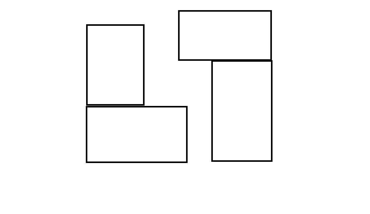

Note however that the increased length makes it a lot harder to carry alone. Any reason you can't stack 2 standard 7Ah batteries on top of eachother as intended?
Because, when I looked at the sketchup drawing yesterday the height was 287 mm and one 7.2 Ah battery is 151. So they won`t fit if I stack they on top of each-other?
I have looked at three different batteries and everyone of them has this dimension:
151 x 65 x 99mm
Or am I missing something here? :)
151 is the width. Not the height.
99+99=198mm height. Easily fits ;)

I fit 4 7.2A SLA in mine+ dsp and amp9
Stacked someting like this:
