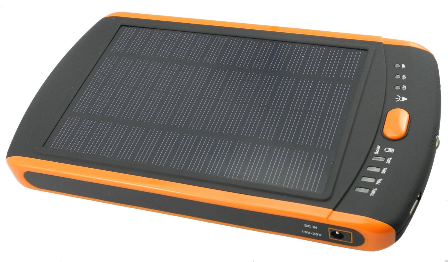

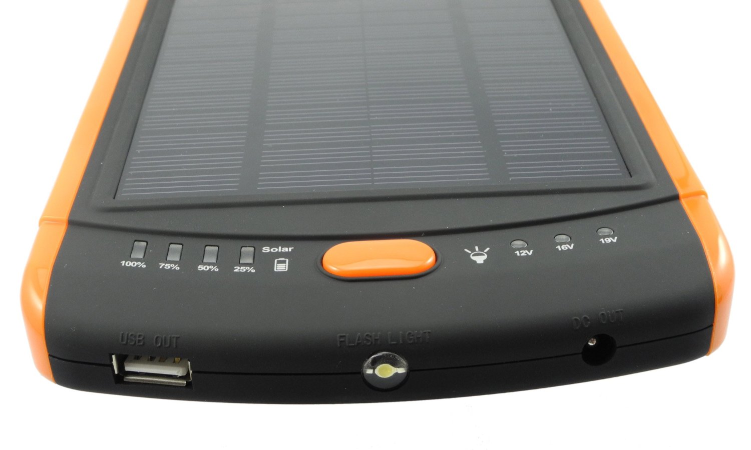

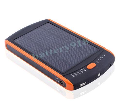

23,000mah Solar Battery/Charger, will it work with the Boominator?
Are there any drawbacks in using this kind of Solar/battery charger?:
23000mAh Solar Charger Backup Power Bank Battery for Samsung Galaxy S3 III S9300 | eBay
It seem like it could be more versatile in that it could be used for other things besides just powering the Boominator.
"...Brand new High capacity 23000mAh Solar battery.... 12V/16/19V laptops, such as Acer, HP, Asus, Dell, IBM, Sony, Benq, Toshiba etc....With advanced intelligent protection chip, the overcharge protection, discharge, discharge protection, overload protection chip, short circuit protection, leakage protection, and five heavy security protection.
SunPower Solar panel High-efficiency Monocrystalline Silicon solar panel, conversion rate > 22%, normal life>20 years.
Battery Type: Li-Polymer 5159115PL*6 Battery
Capacity:23000mAh
Input😀C 9-12V 2A Solar Charger:10V 220-230mA
Output: DC 12V/16V/19V 2A USB 5V/2A
Dimension:222*126*21mm
Weight:649g
Charging time:about 8h for DC Charging...."
For $116 USD, it seems to be more convenient than having to put together the battery, solar charger controller and the solar panels yourself. But will it have enough to power a MKII Boominator at full volume, and for how long? Anybody know? Thanks in advance.

Amazon (USA) has a one also, but the output specs is different:
Output: DC 12V/16V/19V 3000mA USB 5V 2100mA:
Amazon.com: Ycpower Mp-s23000 II Solar Charger 23000mah USB External Rechargeable Portable Battery Pack for Laptop Cell Phone: Computers & Accessories
It looks like the same unit, but not sure. IF this unit can power at 3000mA, wouldn't that be enough for the Boominator? Anybody have any experience with this product? Thanks.

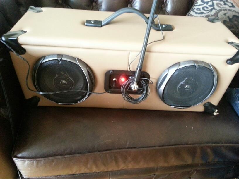

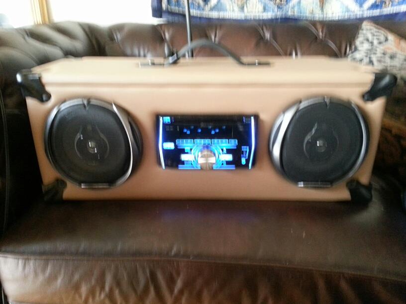

Hi guys I am not exactly looking to build a boominator at the moment but something similar so I thought I would come here and let you know what I planned on doing.
I was planning on using an old ammo crate as my box and using focal access component speakers all around. I'm probably just going to go with a car stereo since it seems to be the most user friendly and full of features. Bluetooth audio, usb, cd, EQ and so on. I was also planning to use a 12v 20ah lithium ion battery but I see the post above Saturnus says not to use them. Which is really what prompted me to post.
Just like to know from people with experience what works and what doesn't.
Oh also I didn't have time to build anything right now so I had someone build a small box for me. I was planning on using the same headunit in the ammo crate. I added a couple of pictures. We use it outback when we BBQ.
