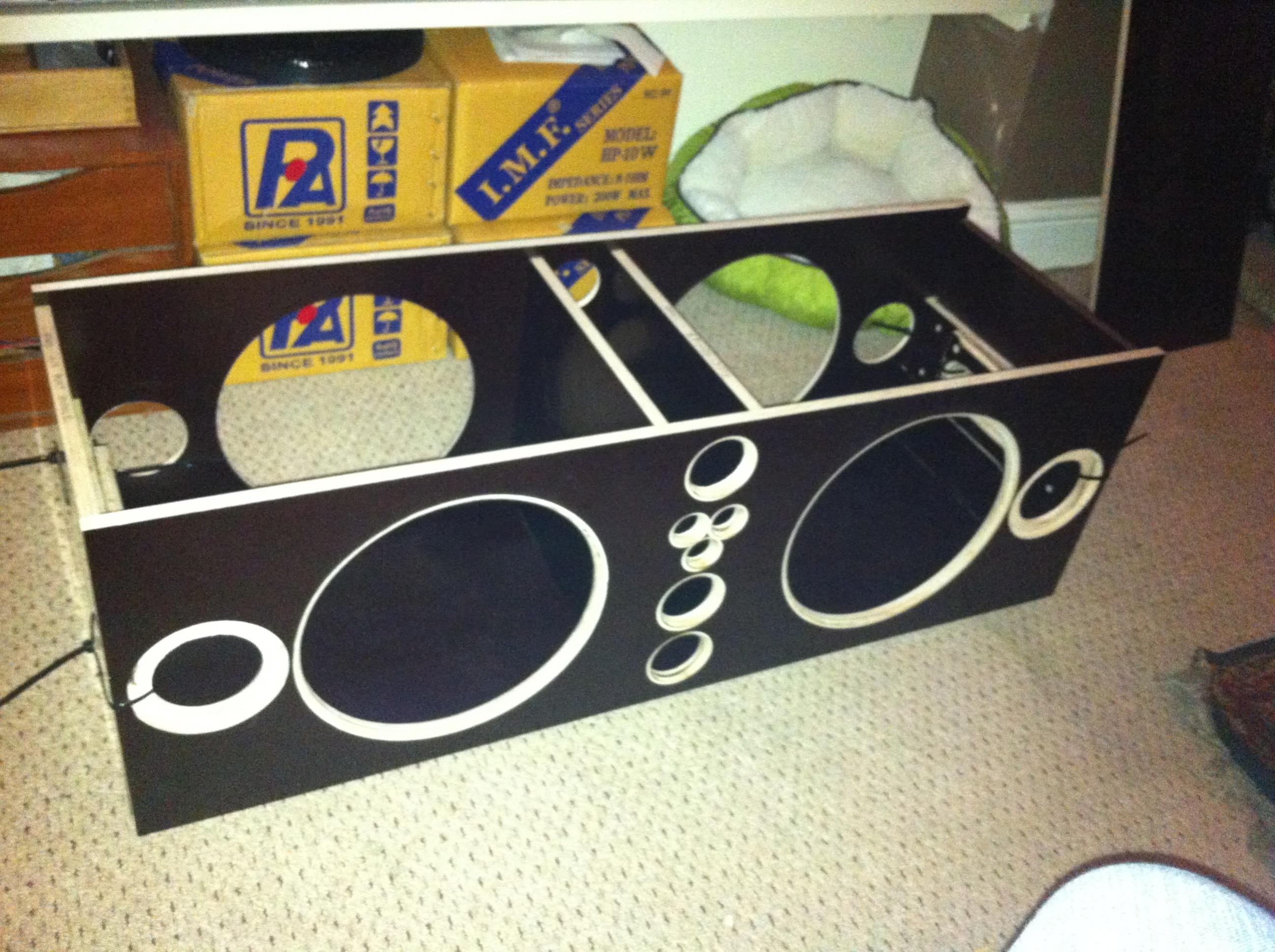

HEhehe, as you all may or may not know, Easter holidays are upon me, and I thought I would do a mission to get my boominator in a configuration I can use for the camping trip tomorrow.
Using a crappy Lepai amp that I've have used before, as I haven't finished my Amp6 Basic's.
I have wired up for charging the batteries, and also wired up a usb adapter so I could keep my phone charged.
Closed everything up and took the unit outside.
Now to the right hand side of my house is a 'paddock' roughly 1/2 an acre, and placed the boominator a good 30 meters from the house accross the grass.
I powered it up and started playing some Led Zep remastered.
Volume about 30% I wandered around the unit a few times listening at different points , beer in hand... (mind you this is about 8pm, dark, no spot lights, after reading to the kids and the kitchen window open).
This was sounding quite good, so I crank up to %50, nodding my head and grinning with the unbelievable possibility that I put this thing together in the first place 🙂
I left the boominator out on the grass and wandered back to the house (this is a high set house with the top level with a wrap around veranda 4 meters off the ground, kitchen, dinning then lounge and bedrooms).
I got up to the veranda and it sounded clear as a bell! awesome..... then the wife comes out of the house...
"What the heck are you doing?... the kids are wondering what that noise is! and I can't hear the Television!"
test mission successfull!!! Ready for camping, but I think I may have to keep a restraint on the volume. lol

Finally started assembling my box and now it's time to fasten the woofers to the baffle!
Unfortunatly I ran out of silicone but I do have an opened tube of SuperSet - Casco , will most likely not be used before it gets to old anyway. Shouldn't be a problem using this instead ?
Also wondering if it necessary to fasten them with screws aswell ? Will the presure on each side och the speaker be enough will the glue and chemical metal settle?
