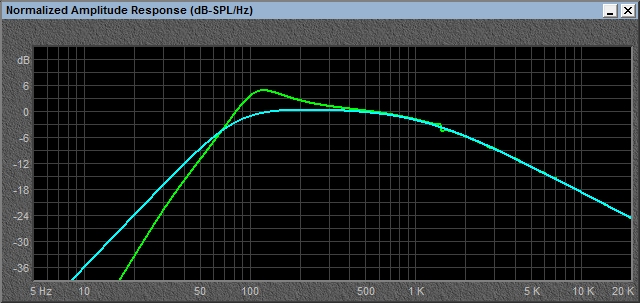

Upon further reading, I can see that it probably needs to be ported/vented in order to maintain a high efficiency. Do any of you have any suggestion for such a build?
Vented is better in this case, approx. 3-5dB extra between 80-200Hz
As i see it freq below 60hz is not interesting
Green: Vented, 40,0l, Fb 71Hz F3 68hz, port dimensions 100x22 or 2x 100x125mm (round)
Blue: Closed 48,5l (Qtc: 0,707), F3 77Hz
i you give me th inner dimetions of the box, i can caluculate a rectalgle port instead.

And i agree that anything below 60Hz is unnecessary, since this is for outdoor use.
If you have any other ideas, then please do let me know, since I'm pretty green with DIY-audio 🙂
