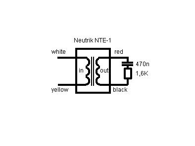

col said:
V-bro That would be awesome! There are a couple of us using the NTE-1 to balance up connections with the Tripath/41hz amps over here now. It's a must connecting to pro-audio gear.
col.
Well I did the measurements!
The NTE-1 needs an 1,6Kohm resistor and 470nF (0,47uF) cap as a correction network.
I have used a 47Kohm input impedance, but this didn't make a dramatic difference, the circuit is generally usable on any type of input.
Here's how it's done:
