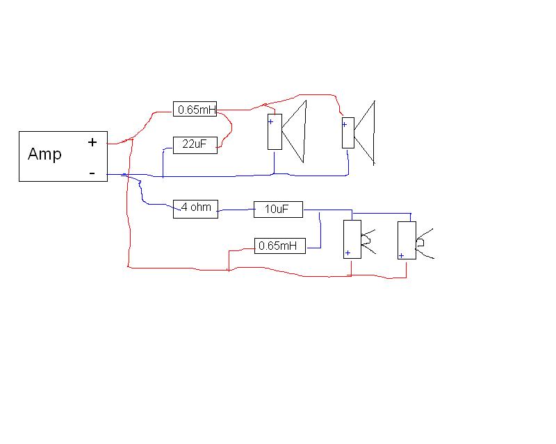

- You need a filter. Several options here with pure passive, passive and passive level combined, active, or digital filter. Name your preference.
I would go for an Passive filter if it is going to be this dessign unless it is not good. It is just to keep it simple. What Capacitors and resistors do you recommend for those drivers ?
Yes, just one 12mm on the inside making it 24mm deep.
Search you local hardware store for a pvc tube that fits.
You need a 2nd order Linkwitz-Riley high-pass at 2000Hz and a 2nd order Butterworth low-pass at 1400Hz. Which together with the actual frequency response of the drivers gives an acoustic 3rd/6th order Bessel filter at 1800Hz.
Remember to invert the tweeters and dampen them by 3dB with a series resistor.
Here's a simple and fast drawing of how it should be connected. Please note that I made a mistake. The plus on the tweeters should be connected to minus on the amp, not the plus on the amp as I have drawn here.
Oops. That should have been that it's a 6th order Bessel filter at 2100Hz on both the high and low pass slopes acoustically.

Actually to accurately illustrate the transfer function of the tweeter filter and how it works you take the frequency response from winISD (PRO alpha version) of the s2010 woofer in the Boominator cabinet. That has a hump in the frequency response more or less equal to the pht407n tweeter if you just multiply all frequencies with exactly 20.
Now you add a high pass filter function in winISD. User SOS, fc=100Hz and Q=0.5 which is a 2nd order L-R filter. See how straight and smooth the response is now?
The crossover frequency is the frequency where the the output is -4.5dB for this filter because the total Q of the filter is between the drivers Q (0.66) and the filters Q (0.49). Actually the drivers Q is 0.42 but since there's a 4 ohm series resistor in series with the 2 paralleled drivers it changes to roughly 0.66. So the total Q for the filter is 0.57 which is a Bessel filter which crossover point lies at -4.5dB.
Similarly the woofers Q at the crossover frequency is also roughly 0.57, as the base Q is 0.31 plus the 0.06 added from the series resistance in the coil, and the Butterworth filter function has a Q of .71, which also gives a roughly 0.57 Q of the Bessel filter.
