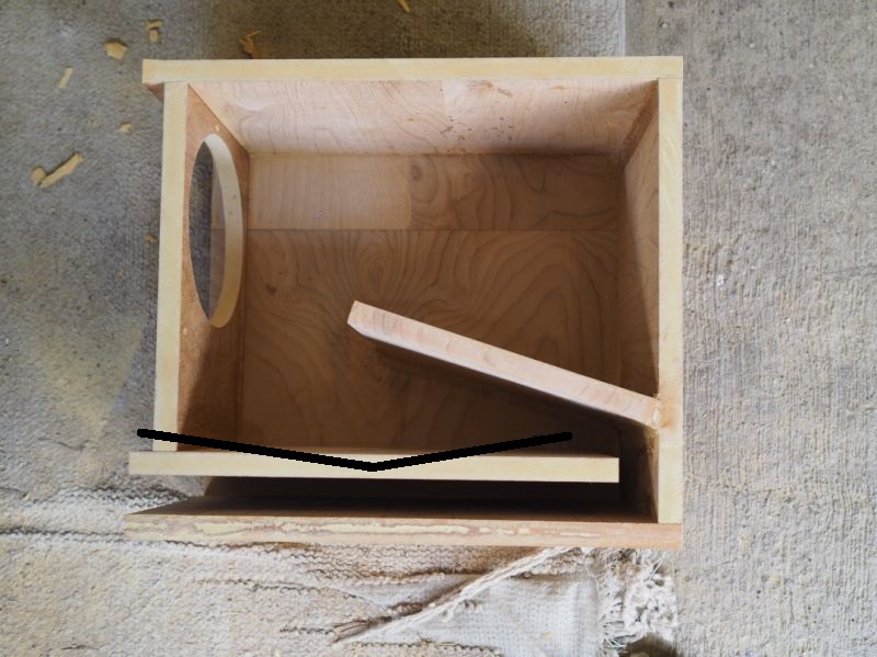

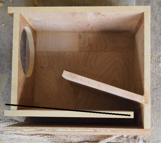

How do you tell the angle of panel E?
there doesn't seem to be any data to get this from without measuring the horn from Hornresp?
No need to - the "Guides" sheet in the workbook for the Boom Unit gives the locations for the guidelines to be traced on the side panels for the position of panel E and the other panels.

I keep coming back to this after you shared it in another thread; I really like the profile and how small this is and would love to build something mighty with a small 8 inch driver. Even more fun is that it's an inexpensive driver. Would you mind entertaining some questions? Forgive my green gills. The front baffle, does it have to be recessed? Was that done for internal volume and spacing or for aesthetic? The angled shelf inside, what angle is that measured to? I tried to model it in Hornresp but didn't see this part. The rest of the folds look straight forward, I think. I may try this with 3/4th inch Birch ply that I have on hand. Was thinking of something small, skinny with an 8" driver that can competently do 30hz ~ 80hz on low power.
Very best,
Very best,
The baffle does not need to be recessed. I did that primarily to protect the driver. Keeping the layout and removing the recess will move Fb up, but I think the change is going to be very small.
I don't know offhand what the angle of the internal panel is, as I used the guidelines generated by the workbook to position it inside the box. If you're going to use 3/4 ply, you're going to need to use the workbook to adjust the dimensions accordingly and then you can follow the guidelines suggested in the workbook to properly locate the internal panel.
