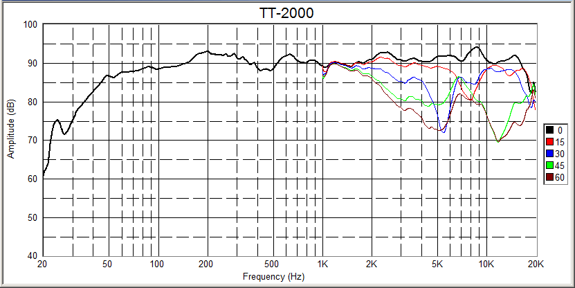

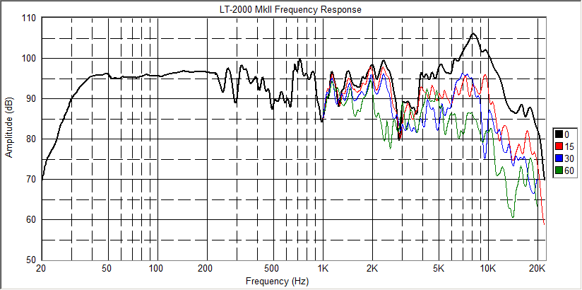

I'm not 'getting' a few things, though. The lowther drivers are kings of the 'rising response' and there is no acoustical attenuation in this design to flatten it out.
The thing is that you don't listen to Lowther or any other wide-range driver on axis. Once you are 15* off axis, the FR is fairly flat. The whole rising response thing is gone.
On the other hand, the Tang Band W8-1772 with a little, OK, a lot of BSC comes out pretty flat on axis out to 30*. A Bud said, once the FR is reasonably flat, the sweet spot expands and the speakers disappear. You can walk around the room and these speakers don't change sound much.
Bob
