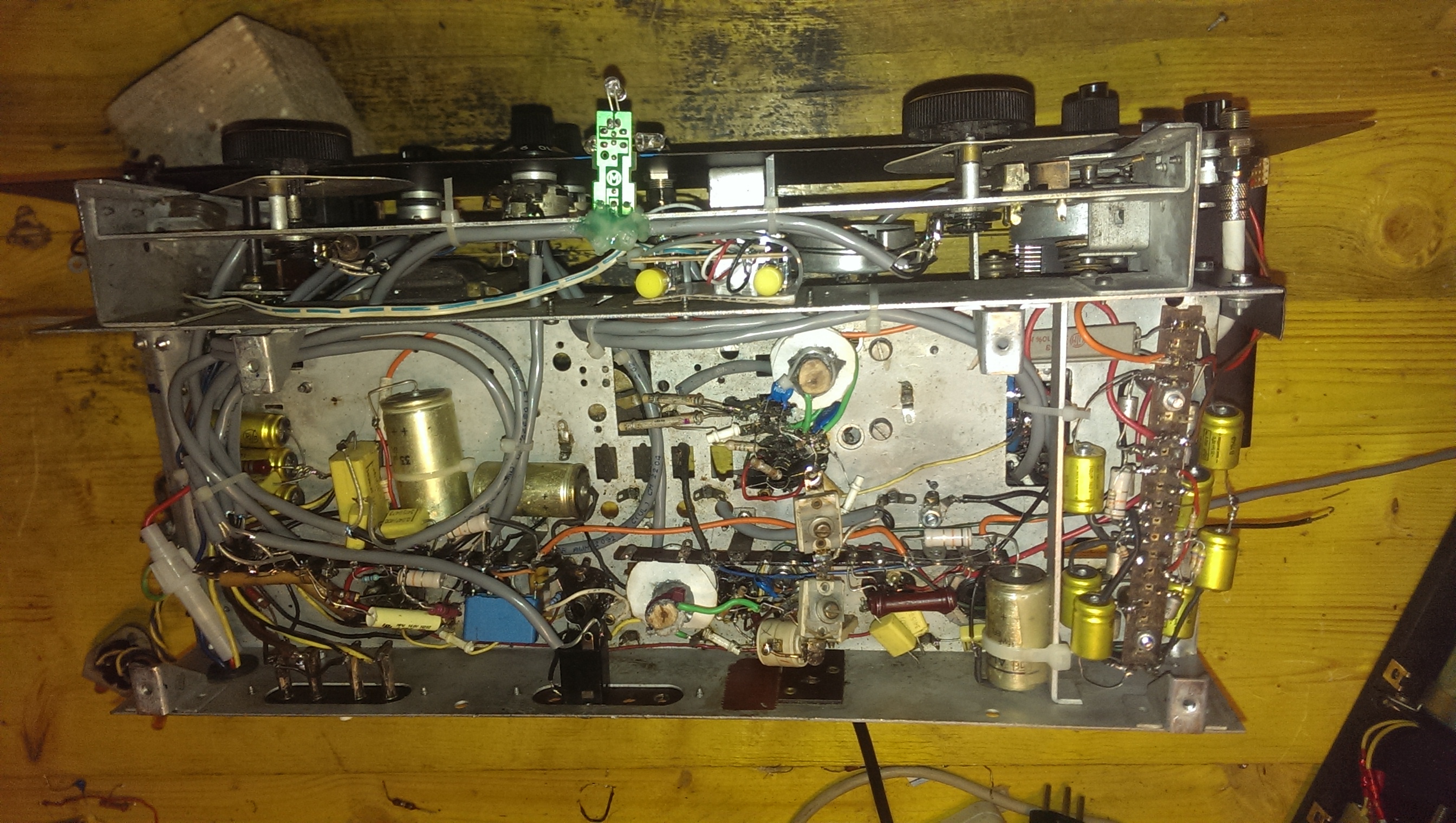

I made a theremin from an old philips vacuum tubes radio and other recuperated parts. I called that instrument the Black Star because a buddy have a very funny border collie named Star.
This was really a challenge to make it because that instrument mix audio and high frequency. For those that doesn't know how a theremin work, you have a box with 2 antennas, one to control the volume, the second one to control the pitch.
The pitch circuit is the easy part. You have 2 high frequency oscillators, a fixed one and a variable one. Their signals go into a mixer and its output f1-f2 is the audio.
That audio go though a VCA. The volume antenna control a third high frequency oscillator, a variable one which control the gain of the VCA.
It is also an audio amp and a speaker.
The original radio:

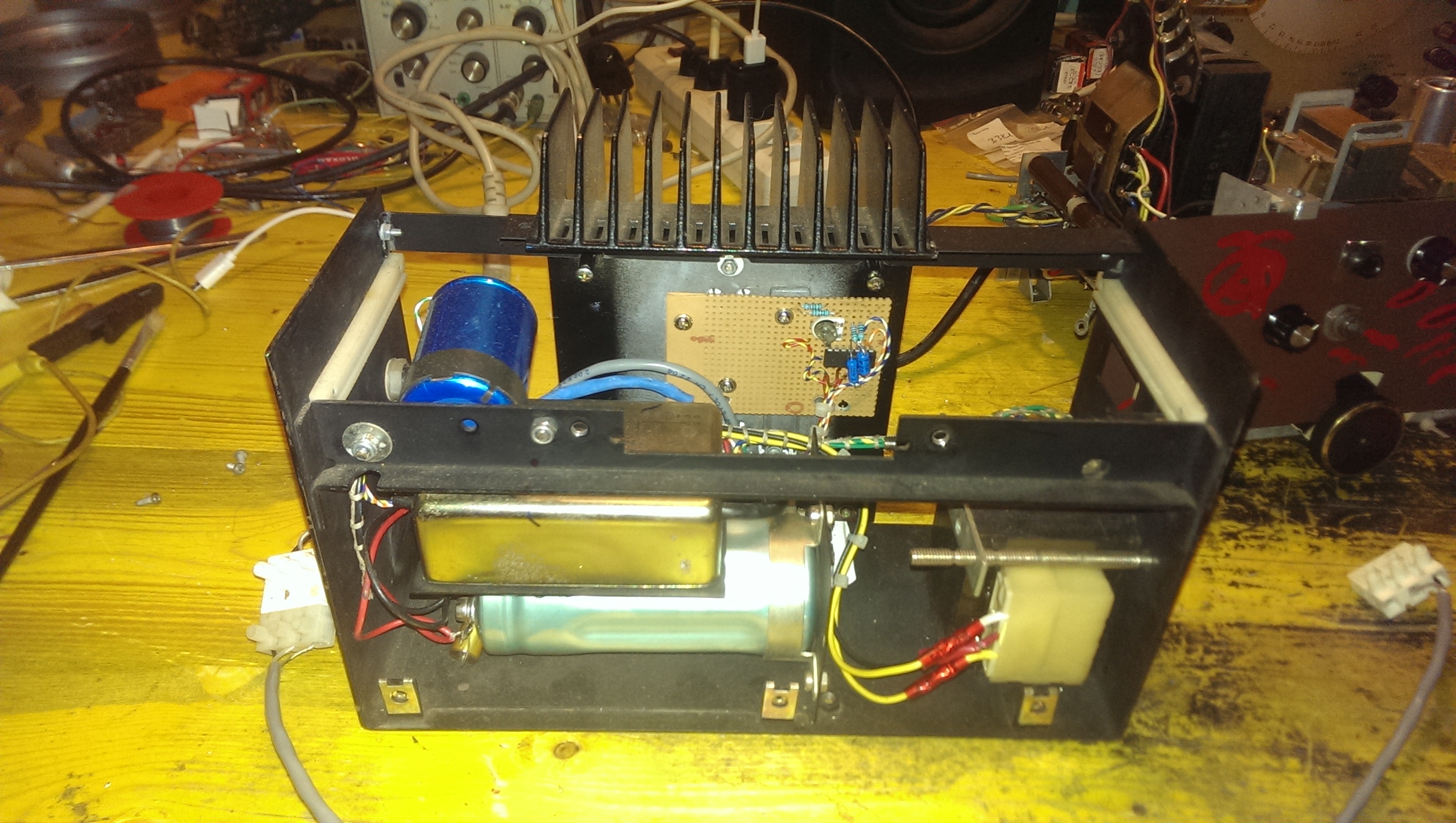

An external DC heater power supply with slow startup (the theremin work fine without it):

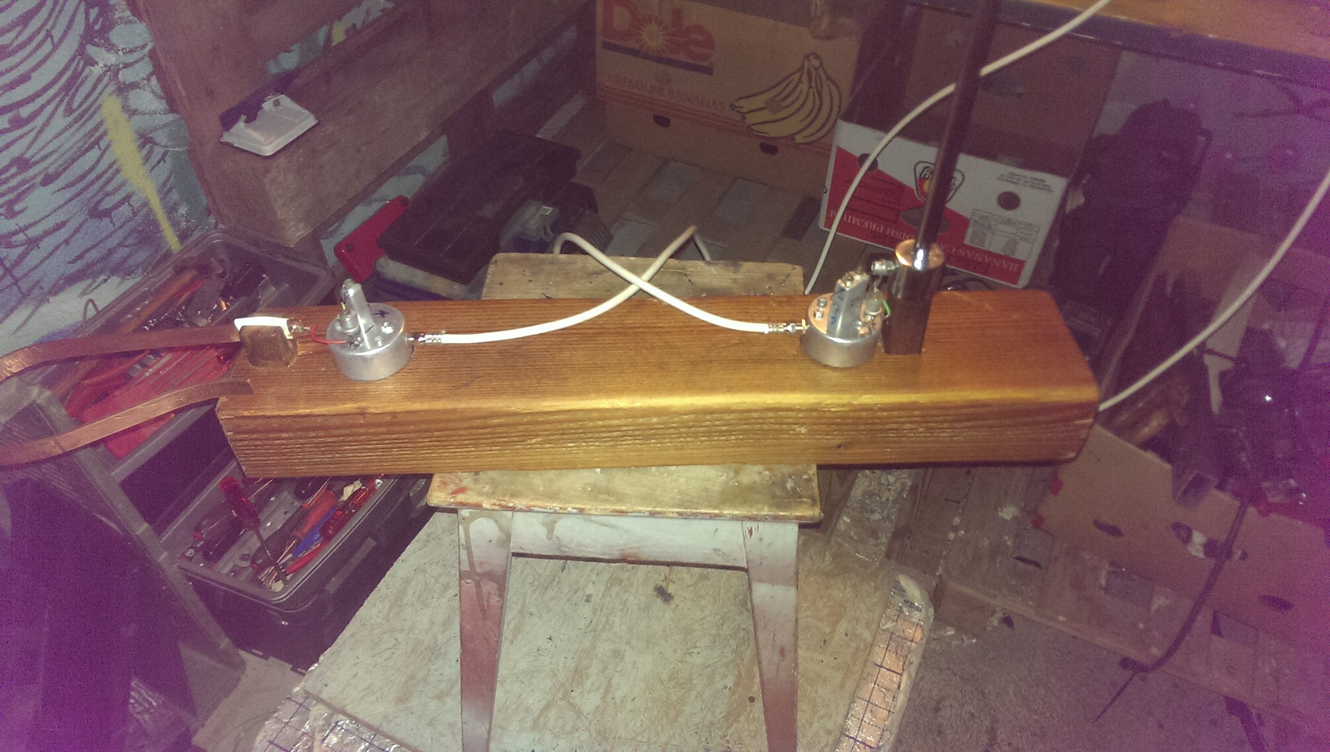

The 2 antennas. It is the only theremin I know with external antennas. For that to work well, the whole LC tanks of the oscillators are with the antennas:

Practically, the major difficulties was the selection of the condensators for the oscillators, in some cases only mica or air condensators was working good enough. And the ground strategy. High frequencies find the shortest way into the metallic chassis when audio frequencies must have a separated ground circuit.

Very good idea for upcycling an irreparably defective tube radio - and only for this one!
I would have mounted the antennas directly to the case, though, thus avoiding these long cables.

To have separated antennas is a feature: I just wanted to be sure the case of the radio is not in my way when playing. It you look at the existing theremins, the transistor ones are small enough for the placement of the antennas to not be a problem. The vintage ones are very big devices and the antennas are always placed at or near the top of these devices, when in an antique radio like this one, the electronic is at the bottom of the case. Also, the vintage theremin are using very big air coils, which facilitate the placement of the antennas at the top, when this radio, one of the last ones made by philips with tubes, already use relatively small ferrite coils. The antennas are parts of the LC of the oscillators, the hand act like a small variable capacitor in parallel with the C of the LC. With the Clapp (or Franklin) topology, the distance between the LC and the tube is not a big issue, and this allow to have them separated from the device.
When making that instrument, I try both the Clapp montage as in the Clapp original paper (which is on the website) and the Clapp as in "Vaccum-Tube Oscillator" by Edson and Sarbacher. The later is not a real Clapp oscillator and didn't worked well with separated antennas. It was funny to see how a 488 pages theory book on just tube oscillators can be wrong on that particular issue.
