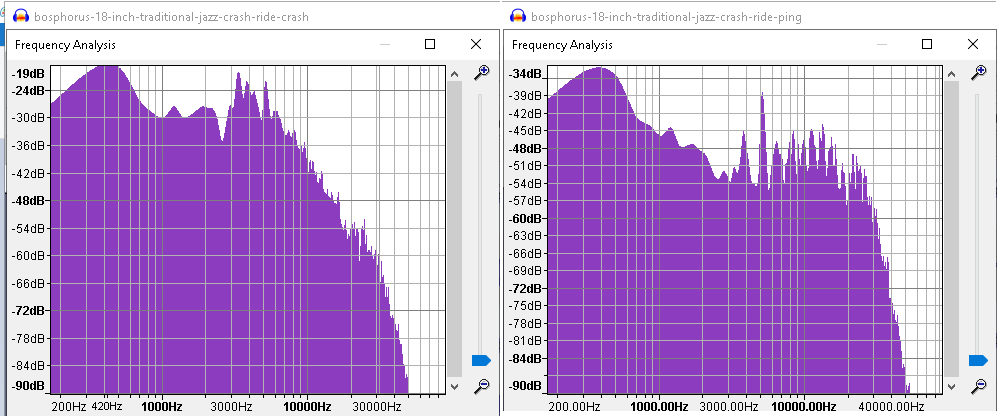

Cymbal Reviews with Spectral Analysis | Drummerworld Forum

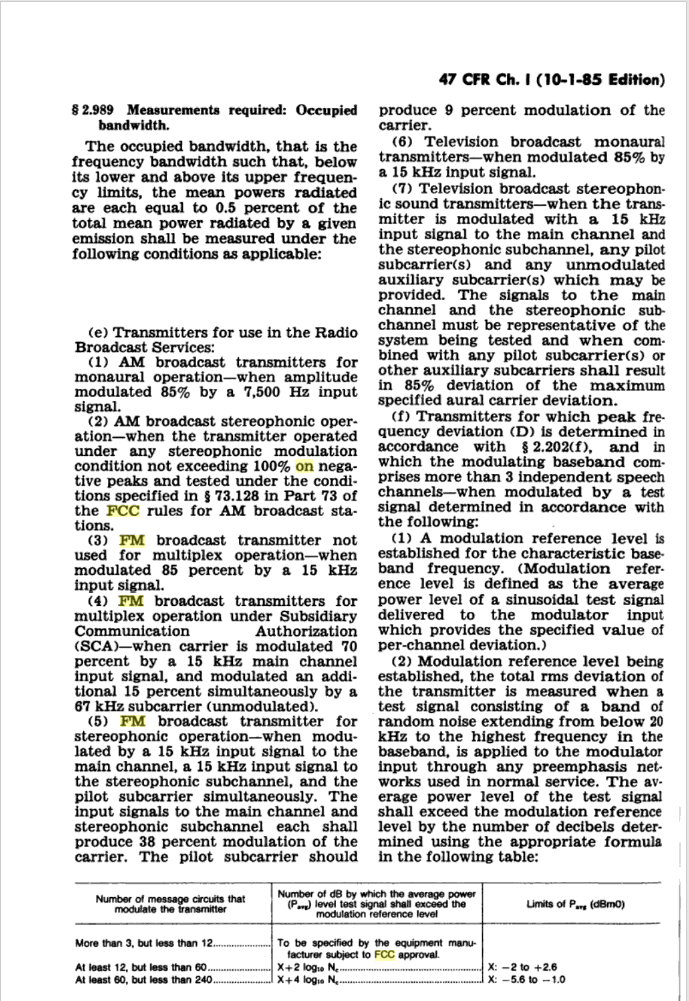

The fundamental and first harmonic are within the legal frequency FM transmission range. However having a spectrum analyzer and looking at the commercial FM stations, one can identify when the Federal Communications Commission folks are in town and checking up on performance. Otherwise I have seen as much as 250% modulation.
The station in question was tapering off around 5,000 hertz. Too much level into the link was causing compression after the high frequency boost is the most likely culprit. That would have been done at the wrong stage of the broadcast signal chain to make things sound louder.
(I was once in a local FM station's chief engineer's office when he got a call from a friend telling him the FCC was in town!)
I see, thanks. What’s the fine in case they are caught?
Btw, a lot of high sampling rate (176400Hz) cymbal wav samples here, download and do your own analysis.
Welcome Secrets of Home Theater and High Fidelity
