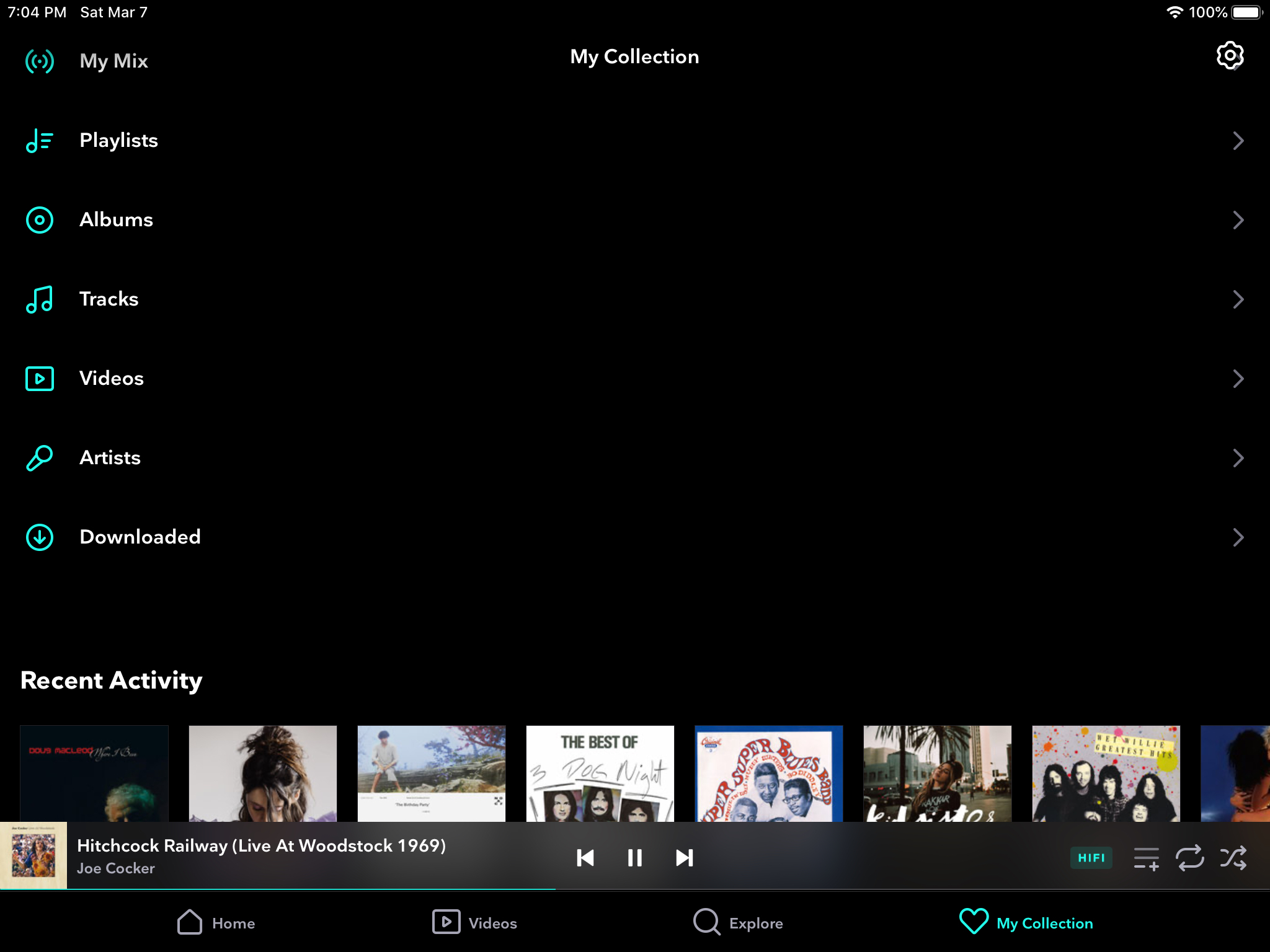

Anyone on here ever tried to copy a streamed download?
Looks as though you can with certain apps/programs.
Once you get into high res streaming it’s really quite awesome, it also doesn’t mean you have to give up your physical collection.......even though I haven’t touched a cd in almost 2yrs!
I can’t wait to bring it to the next performance level.
That would be theft - right?

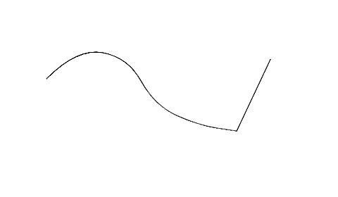

From what I can see, Richard is saying that signal processing that assumes steady state is insufficient for non continuous signals.
Are you saying something different?
Yes that statement is wrong, the transform is defined for any length time record and no information is lost doing the inverse transform.

The argument that signal processing that assumes steady state is insufficient for non continuous signals crops up from time to time but I don't understand the thinking behind it, perhaps because I don't fully understand the terms, is it, as cbdb implied merely the starting and stopping?Yes that statement is wrong, the transform is defined for any length time record and no information is lost doing the inverse transform.
Well, an uninterrupted non-continous signal would be something like a smooth bezier curve that all of a sudden was making an e.g. 80 degree turn. If you zoomed endlessly into that turn, or corner actually, it would still be a sharp corner.
Can of course never be produced in the real world - even less with a real music instrument.
And if a clarinet would magically produce one, nothing would be violated as the A/D LP filters would take it away 😉
there’s a place for downloading to your device right on the tidal app. It doesn’t go into detail about what you can and can’t do with it after the fact......I’m going to guess if it’s just for personal use and not resale its ok maybe? Idk for sure.
