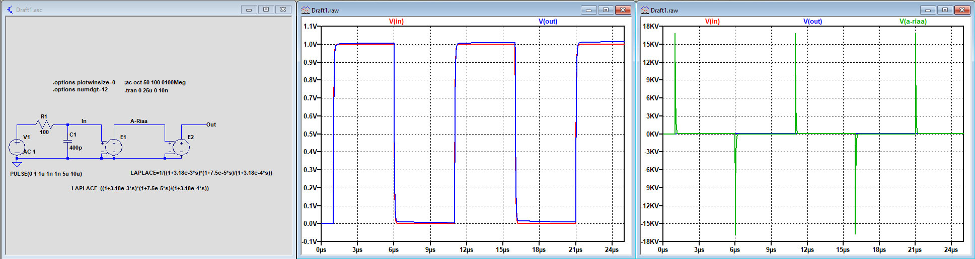

Sorry Joe,Hi Hans, appreciate your input and yes, this is an extraordinary bandwidth and even more, it stops on a dime (yes guys, I know it is called settling time, so calm down).
I can't show you the circuit as there are commercial issues. Re RIAA, I gathered somebody would remark about that, so I was prepared. I am pretty sure that you know about the Hagerman Inverse RIAA and how he was influenced by Allen Wright re the Neumann cutting amp is set at 3.18ms – or
50,048Hz.
Allen and I came up with our Inverse RIAA that is slightly different in values from Hagerman's - our's we feel are tighter than his 'off-the-shelf' that you can buy. No issues with that. It's still pretty good.
The square wave I have published was done using our (call it Allen's if you like, I am not claiming anything) Inverse RIAA. I think there are only three made and the screenshot is from a 200MHz oscilloscope. So it was made using that 'anti-RIAA' as you called it, and tested using it.
Do I feel a need for 1MHz, let alone 4MHz? Good question, but as an exercise, that screenshot is still pretty amazing. I never checked that it was 4MHz, but both Allen and I rated it within 1dB at 1MHz.

See the image below, where I used a mathematical perfect Anti-Riaa followed by a perfect Riaa.
To relax the requirements for the Anti-Riaa I have put a 4Mhz filter directly after the square wave generator.,
You see the circuit diagram at the left, in the middle the Input signal directly after the 4Mhz filter and the Output signal from the Riaa filter.
So far so good, Output is exactly the picture you gave us.
But now have a look at the plot at the right.
To produce a 100KHz square wave with 4Mhz BW, the Anti-Riaa will have to produce a signal of almost 17.000 Volt.
Do I have to say more ?
Hans
of almost 17.000 Volt. Do I have to say more ?
Just requires: buffer stage (using higher VDC supplies than usual) -> passive RIAA -> gain stage.
