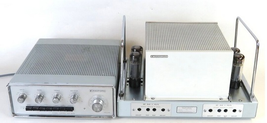

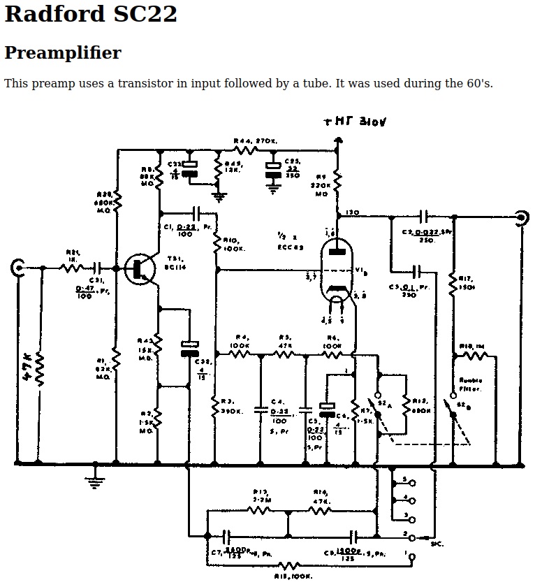

Here's a bit of fun. Height of the 1960's Valve age. All valve sound, eh? NO. It had a transistor at the Phono input. Worked beautifully! I had one.
997012d1636704853-cartridge-snake-oil-radford-sta-25-amp-sc-22-preamp-jpg
997011d1636704853-cartridge-snake-oil-radford-sc-22-pre-amp-riaa-47k-input-jpg
Who knows? 😀

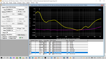

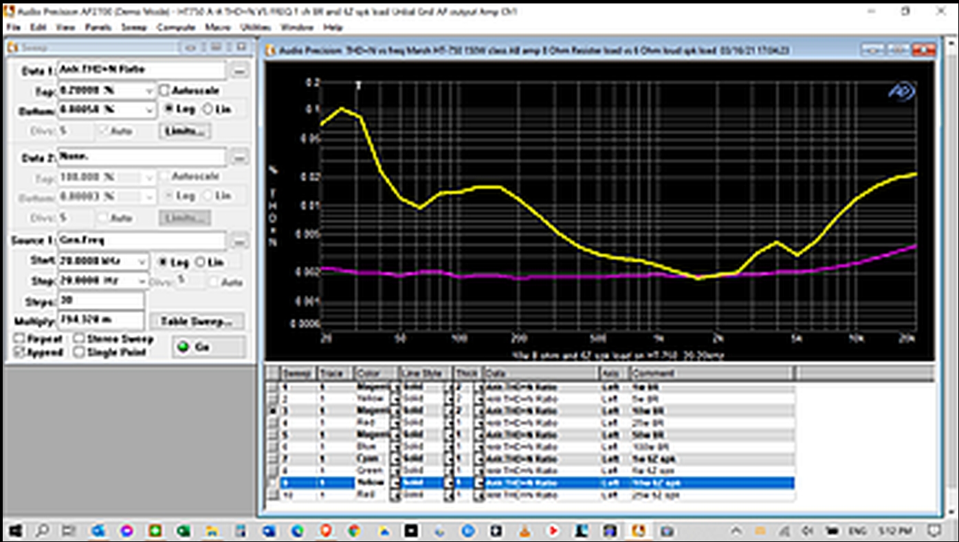

we often hear people tell us no one can hear distortion as low as spec'ed and as low as measured. But thats always with resistive loads. What about real speakers as a load? Your speakers? Shown is a commercially available 2-way book shelf speaker at 5W signal. All amps seem to show higher distortion when measured with real speakers for a load.
Maybe people do hear amp distortion?
The shape of the "distortion" or extraneous signal/noise or what ever you like to call it, follows the Z of the speaker. So, every amp will "sound different" with different loads.

Before commenting on the distortion what is the output impedance of the amp? The Series impedance of the amp will transform the speakers nonlinear load into voltage distortion. Otherwise the distortion is only in the current waveform. I'm not sure what this tells us about the acoustic distortion differences, both linear and nonlinear.
Nonlinear load vs. finite output impedance (divider effect), the explanation is trivial.
At acoustical side it is even more trivial.
Exactly right.
