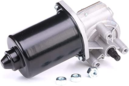

Talking of fixing has anyone been dumb/stubborn enough to try and fix a screen wiper motor. Daughter 3 bought her car over last weekend as the wipers had stopped working. After removing the motor the problem was clear, and a blocked drain had caused the motor to get filled with muddy water. Like the example in the photo there is a metal can over the actual motor which appears to be glued and screwed and I can't for the life of me work out how to get the can off without destroying it. Replacement non oem motor was cheap but I'd like to refurb this as a spare.

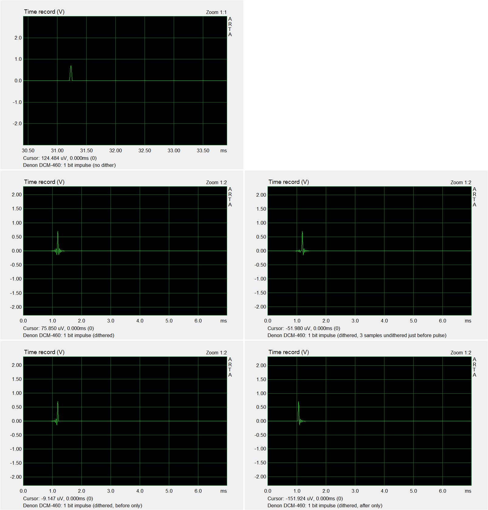

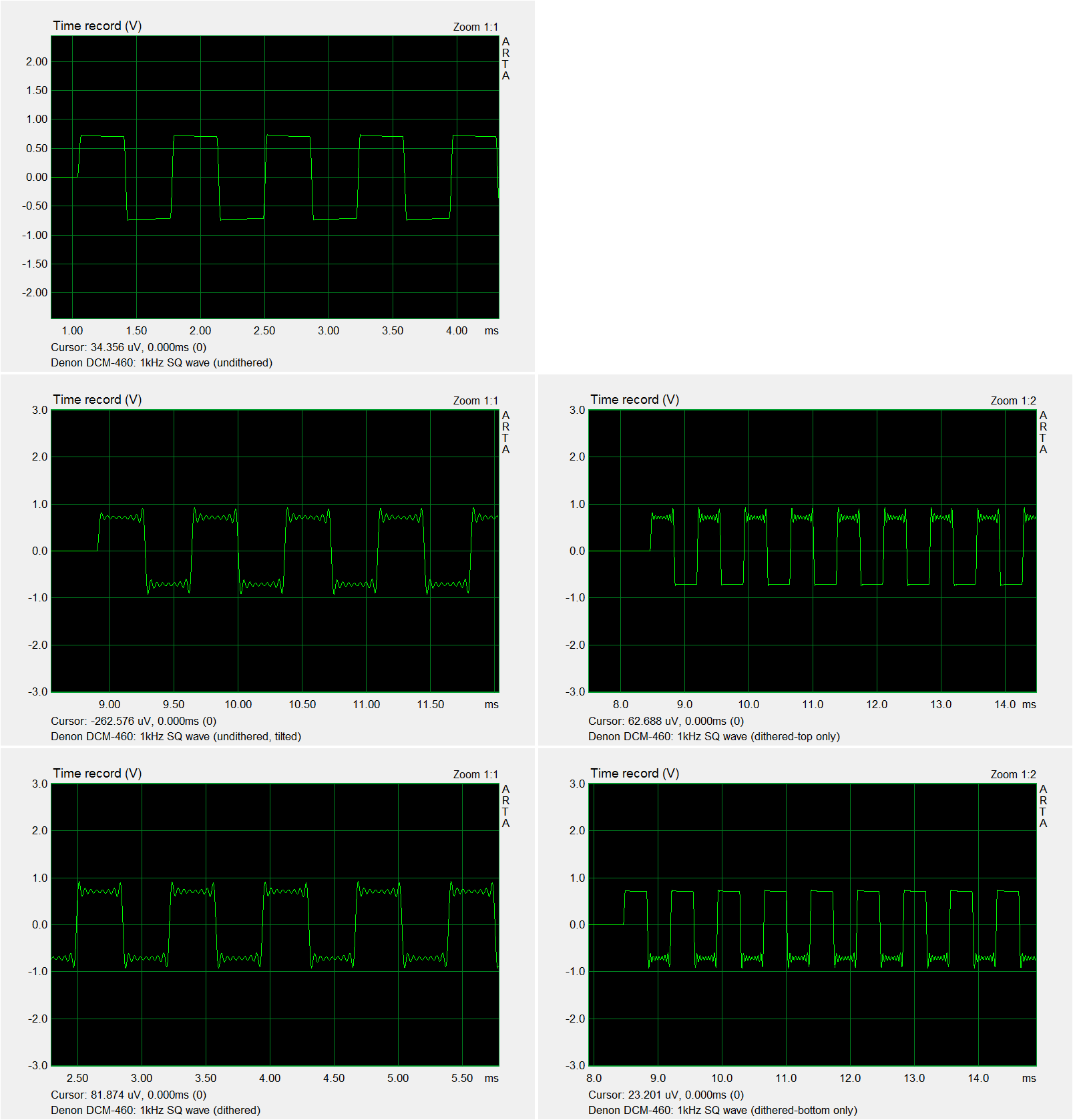

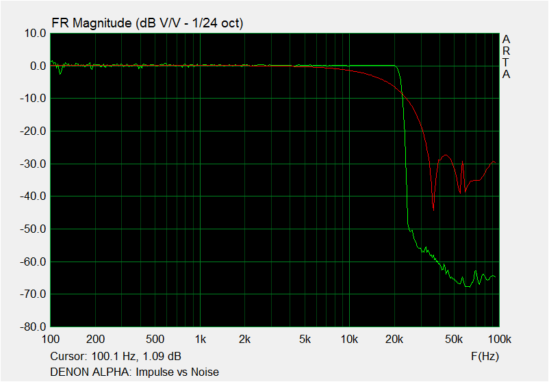

Speaking of dieselgate…does anybody else remember the demos put on by Denon reps for their ALPHA processing back in the mid 90s? Playing test CD with ALPHA processing turned on, it would produce perfect impulse and square waves with no hint of ringing. At the same time, the dual HF tone IMD test looked clean with no aliasing artifacts. How was this possible? Besides being an audio equivalent of dieselgate, I thought this might be interesting for those that were involved in the reconstruction filter discussion earlier in the thread.
I recently ran across an old Denon CD player with the ALPHA processing logo in a thrift store and decided to pick it up to investigate.
Using ARTA to make test CDs, I quickly determined that with a noise signal, it had a standard brick wall filter.
But, with a single bit impulse signal it had a very slow roll off filter. Hmmmm…
So when playing a music CD, the sharp filter will always be used...like every other CD player at the time.
When playing a Denon made test CD, you would get “pretty” pictures on oscilloscope displays in dealer demos to help sell CD players.
After playing around a bit more, as best I could tell the sharp and slow filters are both operating in parallel and the processor decides based on looking at the 3 previous samples of the LSB whether to pass along the output of the slow filter or the sharp. If there is a large change in amplitude, the processor continues to use the filter it had been using before the large change. This seems to match the description mentioned in an old thread I found, where the poster said he had a hand in the creation of ALPHA and that he considered this filter flipping a joke on the audio community.
PCM1704 or newer chips?
I made same additional test CDs where I dithered (ie toggled) the LSB and got some pretty interesting results.
Square wave:
- with no dithering gives you the slow filter with “pretty” square wave response
- if you slope the top and bottom of the square wave by just a -1 per sample you get the sharp filter (ie ringing)
- dither LSB thru whole test signal you get sharp filter
- dither just the top of the square wave you get sharp on top and slow on bottom
- dither just the bottom of the square wave you get slow on top and fast on bottom
Impulse:
- with no dithering gives you the slow filter with “pretty” impulse response
- dither LSB thru whole test signal you get usual symmetric ringing of sharp reconstruction filter
- dither just before the impulse and you get ringing before but none after
- dither just after impulse and you get ringing after impulse but none before
- you can even switch from ringing to no ringing during the pre-ring portion by inserting 3 identical “0” samples somewhere in the string
