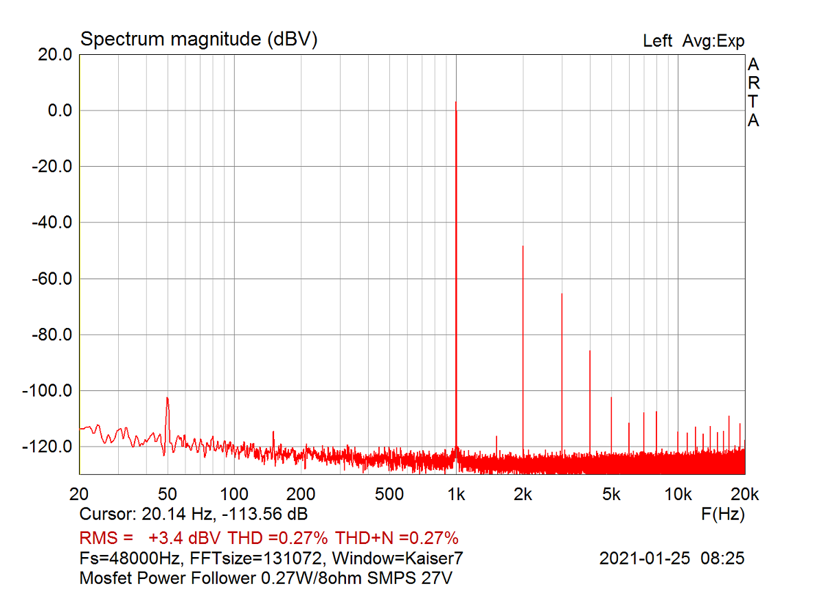

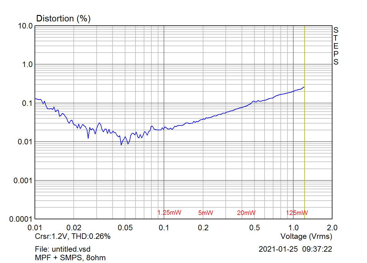

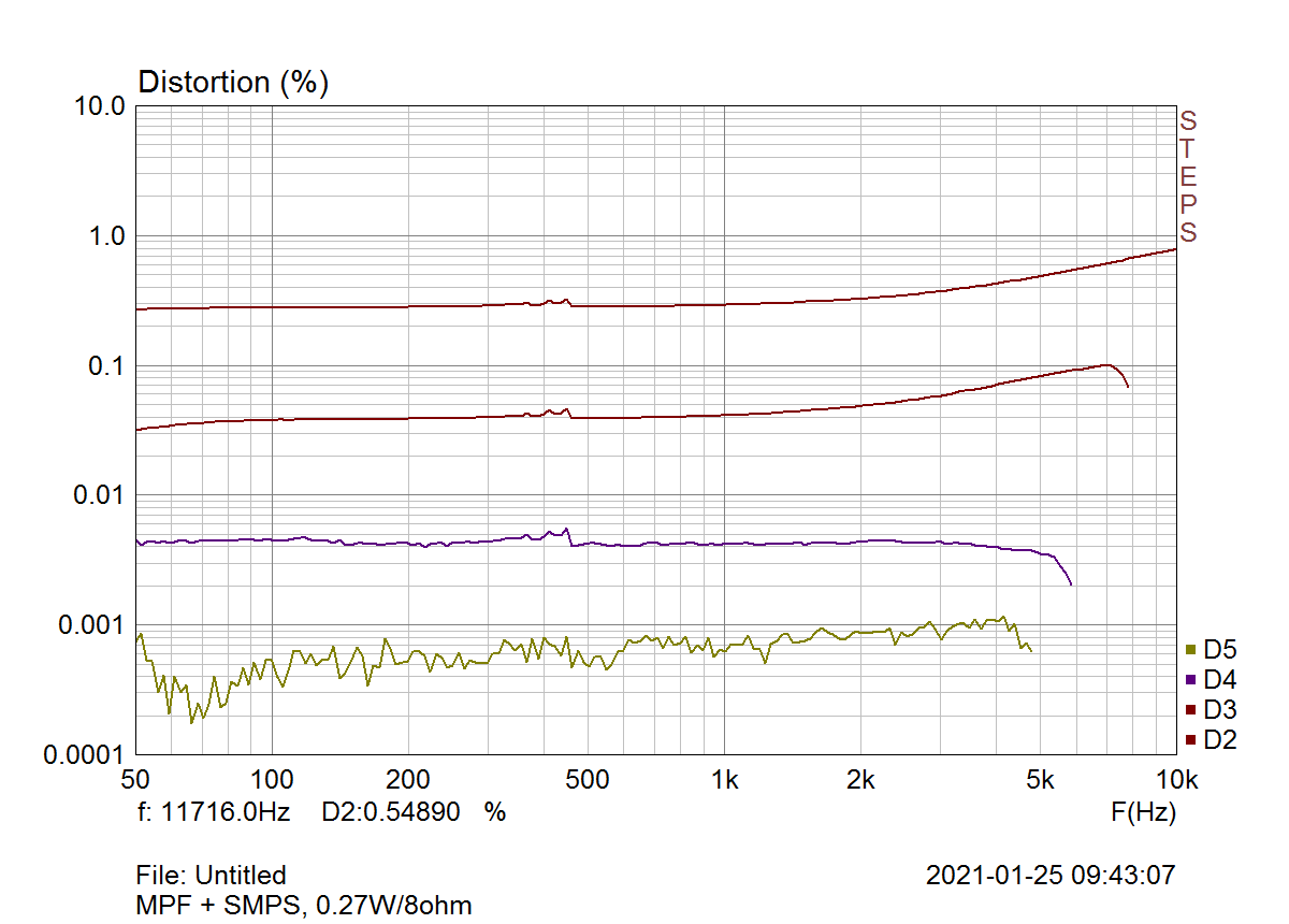

The Mosfet Power Follower (I should have been sin binned for designing and publishing this "amplifier" 20 years ago at Rod's pages). Long live the "NoGFB"!!

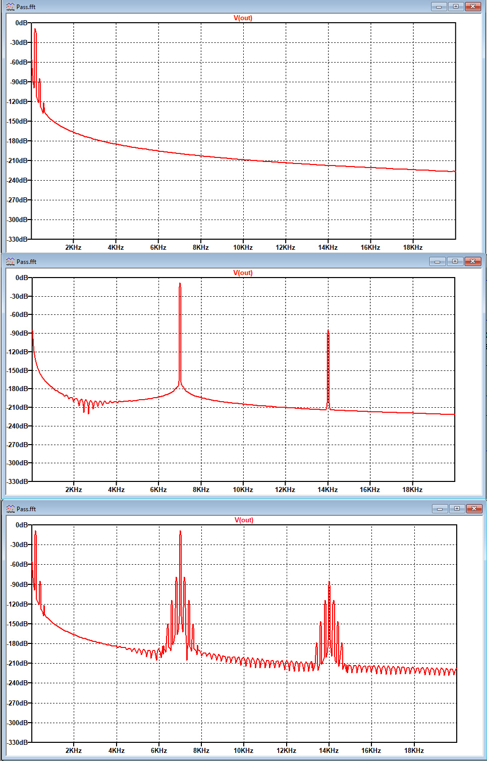

I have repeated Cheever's test with the SE amp that Nelson Pass made available as a DIY kit just a few days ago having no feedback.
I used the same 200Hz +7Khz IM test that Cheever showed in his fig 1-18.
In the image below I first simulated the 200Hz and 7Khz separately, and finally combined them together in the lower plot of the three.
I used the same 400mV for both signals as he did, and in the third plot one can see that his thesis is completely nonsense, because the IM products have the same magnitude at -90dB as the harmonic distortion products.
Case closed.
Hans

Pavel is correct. Harmonic distortions and intermodulation distortions are not independent variables, they are mathematically directly related. Sketch of proof: consider one or more "non linearity functions" and their Taylor series expansion around the bias point (which always exist, since in the time invariant case, such "non linearity functions" are infinitely derivable). Retain as many terms as you want to approximate the nonlinearities, the less feedback, the more you need (since the excursion around the bias point increase). Since the result is a sum of power series, calculating the resulting IMD is only a matter of trigonometry (horrible, practically impossible to manage other than for the first 2-3 terms of a single non linearity, which is what for example Baxandall did). Moreover, the Borel theorem tells us that ANY such expansion has a "non linearity function" it originates from, so there are no "holes" (that is, amplifiers which would not obey this result).
The time variant case is a different story, and for all purposes except fancying Markw4 it can be safely ignored. Pathological tubes amplifiers examples (if they exist) are not interesting, although the proud owners of a Wavac toy may protest.
