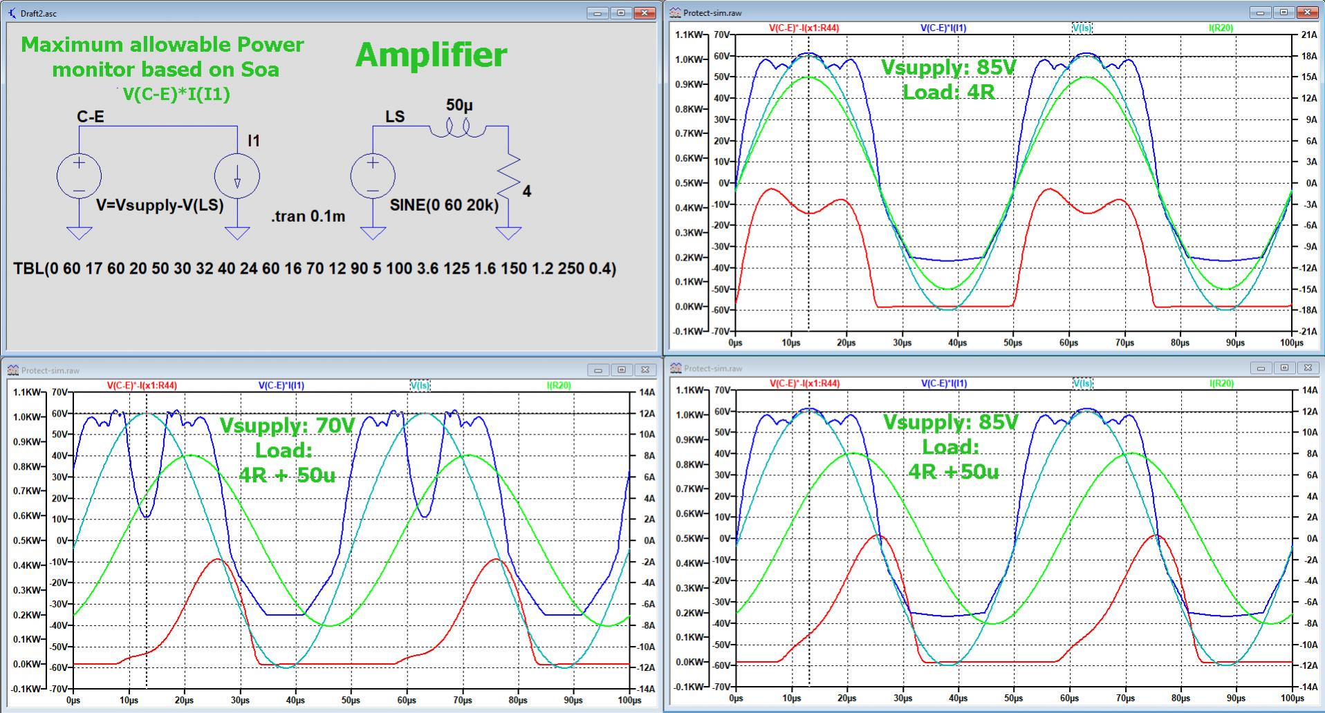

To my opinion an amp rated for some power, should be able to produce this power over the whole audio range up to 20Khz,
Using the ML23.5 again as an example, this amp is specified for 600Watt@4R, which results in 70Vpk on the speaker.
With a resistive load this can be achieved trouble free.
However already when lowering the output voltage to 60Vpk in series with 50u, the Soa line will be exceeded.
Reducing it's Vsupply to 70Volt, and feeding the speaker with the same 60Vpk, the consumed power in the output transistors is back within the Soa.
I suspect that this could be the reason why the ML smaller brothers with lower Supply voltages are blown much less as this powerful version.
No EPDR or EADR could have told this.
See images below,
First the measurement setup generating 60Vpk to resp. two versions with Vsupply 85V and one with Vsupply 70Volt.
The blue line is the maximum allowable power according to the Soa.
The red line shows the power consumption in the amp's positive halve, V(C-E)*I(x1:R44), where R44 is a 0.1R resistor between the LS output and the positive halve.
The green line shows the current through the load, in this case I(R20).
Hans

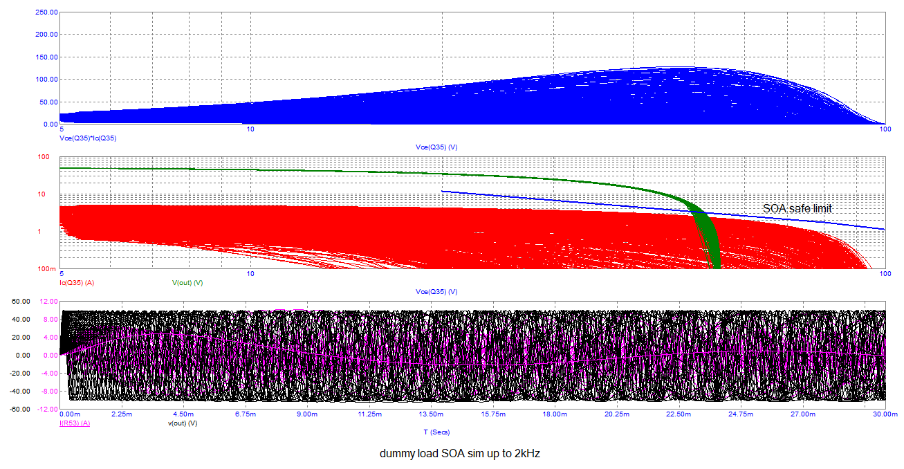

You need to run Ice(Vce) plots with instantaneous (=peak) values for the whole frequency range. Frequency stepping in a simulator makes it easy. Time plots like I(t), P(t) do not make much sense in SOA safe area answers.
Pavel,
Sorry, but I have a problem understanding your plots and hopefully I'm not the only one.
To start with I see a reference to Q35 and R35, but just like R35 there is no Q35 in your circuit diagram, so this should possibly be one of T1 to T4, ?
Then you mention that Time plots like I(t), P(t) do not make much sense in SOA safe area answers., could you elaborate what you mean by this ?
But seemingly in contradiction with this your plots are Time Plots from zero to 30 msec, so how exactly should these plots be read, I tried hard but I didn't get it.
Hans

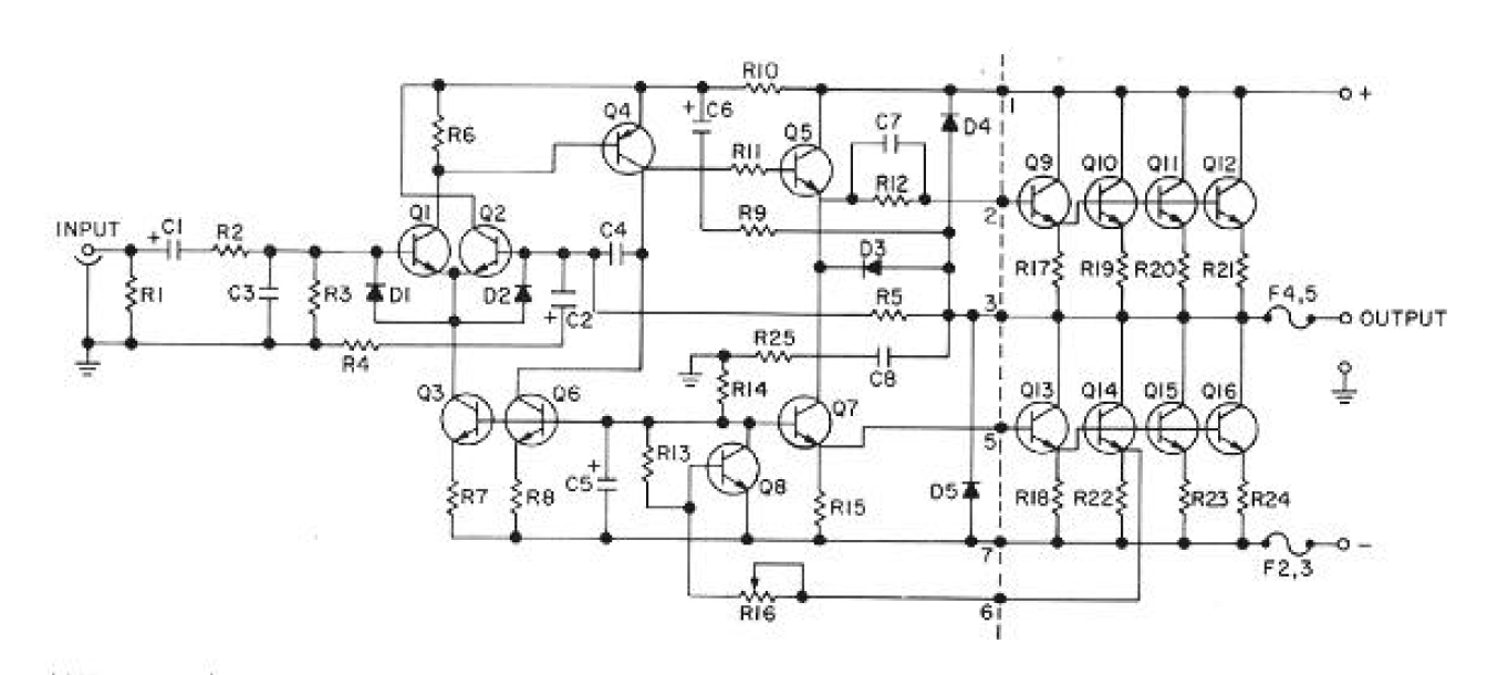

I attach below a zoomed-in schematic of a DIY amp that Pass published in Audio magazine, Feb 1977. archived copy... [Bateman's 2002 paper] points in the direction that the amount of loop gain might be a vital ingredient in this problem.
Without global feedback it seems impossible to get this oscillation on the input and an output inductor also seems totally superfluous in that case. And when it is correct from what I have read, [Nelson] Pass tries to avoid using large amounts of global feedback as is also the case for (most) tube amps. When true, it explains the different views on needing Zobels and output inductors depending on the used topology.
There's lots of gain and lots of feedback, with a conventional 1977 LTP IPS, a conventional 1977 CE VAS, and a conventional 3EF OPS (with bias current increased to give Class-A operation). There is no Zobel, and no output inductor, and no reports of amplifiers destroyed by misbehaving speaker cables.
