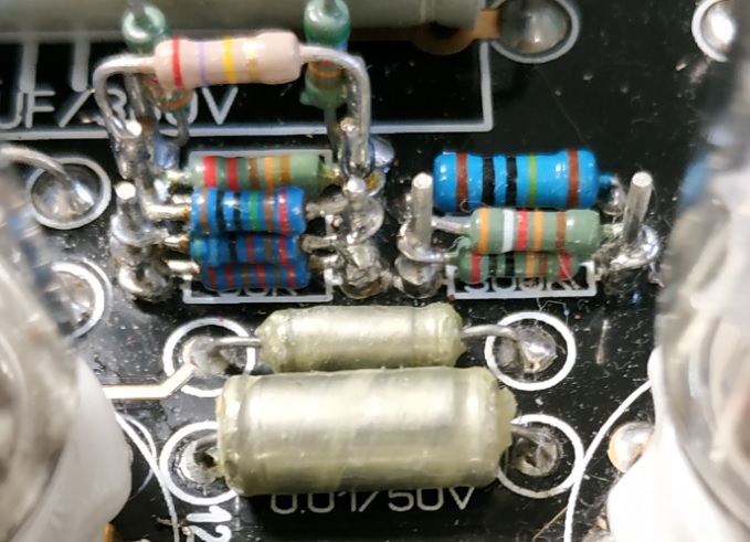

Fusible solder can also be used to strip solder from points soldered with regular refractory solder if you are worried about damaging the board.I don't have polystyrene caps, but in the case I have them I would not change the caps again, to much damage to the PCB with soldering and unsoldering.
After few unsoldering and soldering the same position you can't be sure not to damage the board, it already happened to me, and that was finished amp and I don't want to redo whole board.

For what it's worth, if I need to mess with some parts, I solder pins to the board, then the parts to the pins. Attached is a pic of a RIAA network; the Philips 1% polystyrenes can also be seen.
I can recommend solder wick. It’s not cheap, but it works much better than a desolder gun which I find after a few component changes in the same position can lift tracks.
The other good trick for removing solder in vias and component holes is the ‘smack’ method. You get the solder flowing and then whack the board on the bench - the solder shoots out. Something to do with one of Newton’s laws
