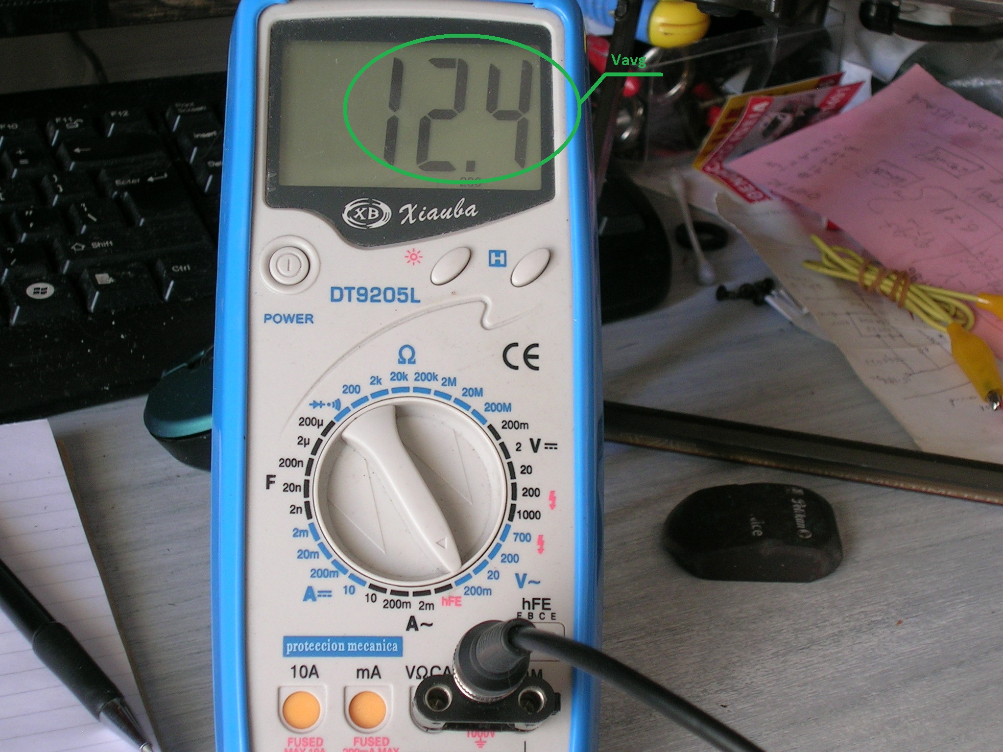

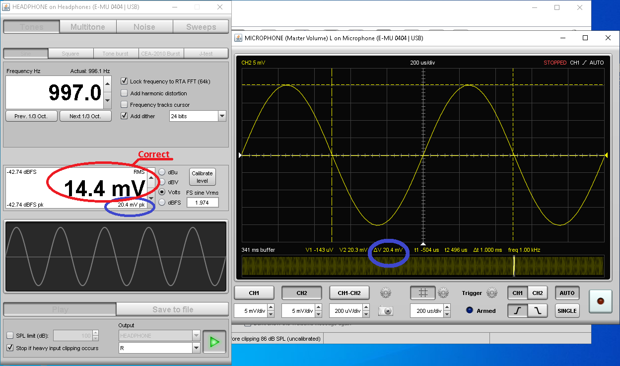

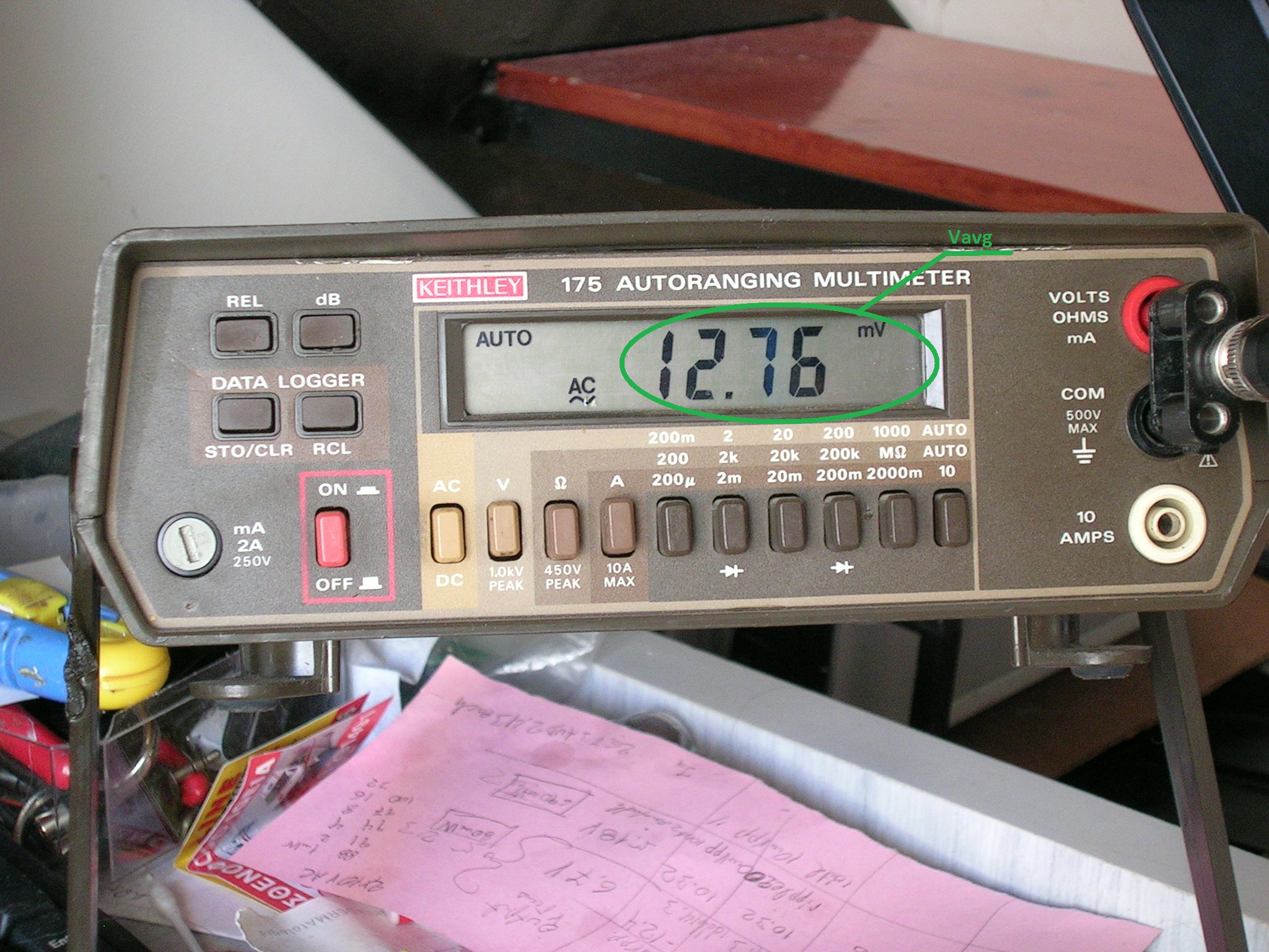

And the DMM guys average over one quarter of the signal period, so the Vavg is non-zero for a sinusoidal signal balanced around the zero line.
Now, I am certain you check in your shop the specs of PAs on a regular basis.
What kind of numerical read-out instruments do you connect (in parallel to an analogue oscilloscope :D) at the output of an amplifier when you evaluate the actual power output vs specs? Are they of the 0.707*Vp kind or are they of the 0.638*Vp kind?
This was my initial question.
Yes Scott, thank you
Only to mention that it’s not the price of the instrument that dictates what kind of measurement it makes. I have here a Keithley bench DMM that (at it’s time it) was expensive, yet it’s not a true rms instrument. At the specs it says AC VOLTS, AC AMPS (average responding).
Then they are the Digital Oscilloscopes which display numerical data along with the waveform.
A very cheap hand held one I have here, displays correctly the Vpp and it displays the Vrms as well. Only that I double checked it today (*) and the Vrms it displays is actually Vavg.
(*) I used it to do some measurements that I posted on another thread two days ago. I rechecked the measurements there and the numbers didn’t add well. :D:eek:
You’ve stated your recommendation here, thank you Ed.
I suspect you are interested in measuring an amplifiers power output, so the RMS value is more useful. As a practical matter, if you are testing using sine waves, a peak reading but RMS value displaying meter is fine
I really don't know of any practical use for the average voltage reading of a half sine!

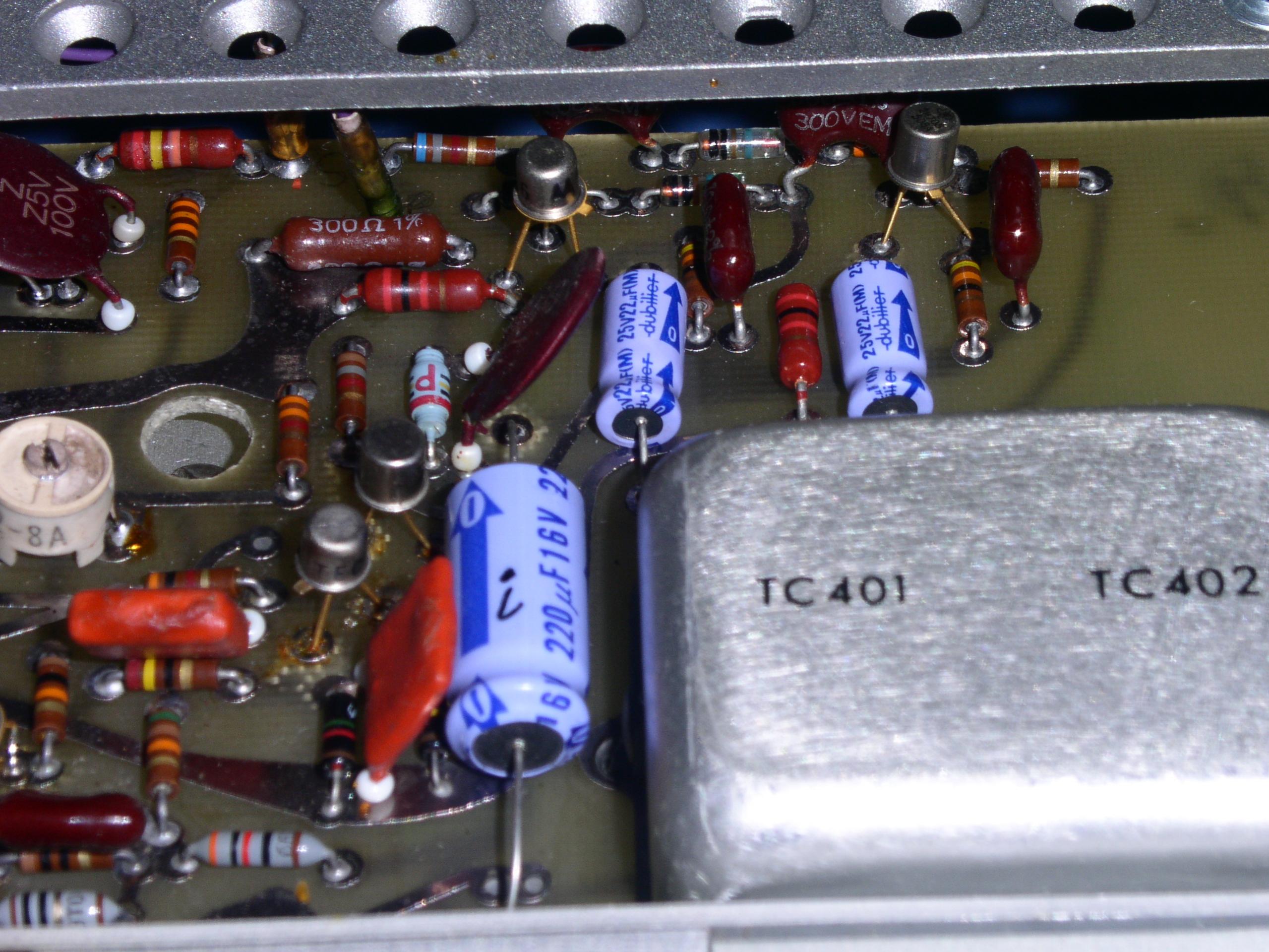

I'm not as lucky; about 10 years ago, I had to replace all the electrolytics (lots of them!) and the nuvistor (with a JFet!). In the attached pic, all the blue stuff are my doing. Overall, the way the thing was built makes me think of a ... transistor radio. There goes the century old debate of HP vs Tek; and I'm a Tek guy :).

It's good practice to replace all the electrolytic caps in any piece of electronics every decade or two, especially test equipment. Like car tires and batteries, just operating costs.
