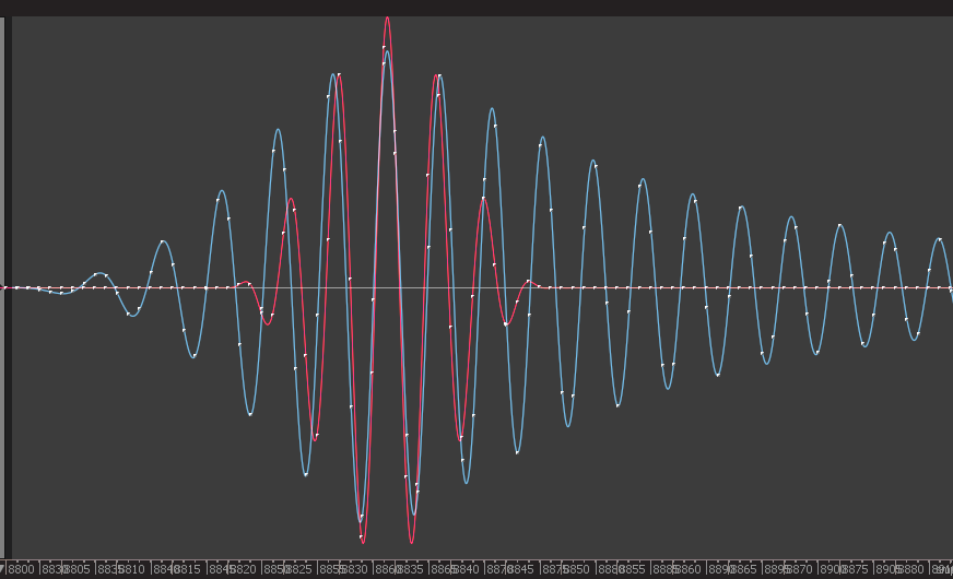

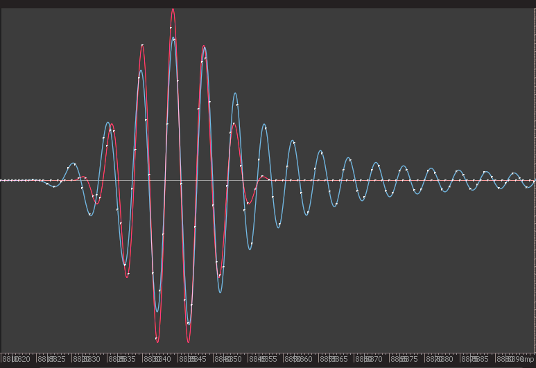

To further stir the pot..
I ran the same 20kHz raised cosine burst sampled at 88.2kHz thru two different "minimum phase" filters I mentioned several posts back set at 20.1kHz. I wanted to see what is different compared to textbook brickwall filter.
Screenshots are overlaid in Photoshop. Original and filtered signals are aligned on highest peaks so that their zero crossings coincide. The audio editing application uses 33rd order waveform interpolation for display, whatever that means.
Honestly, I do not understand what I'm seeing. Yes, all other zero crossings do not coincide, but, what's more interesting, the amount of "offset" (if one may call it so) from the center peak in both directions is different for both filters.
Jn, what is it? How do you interpret the results?
P.S. If you want me to align waveforms on some other points, just let me know, I saved the PSD files.

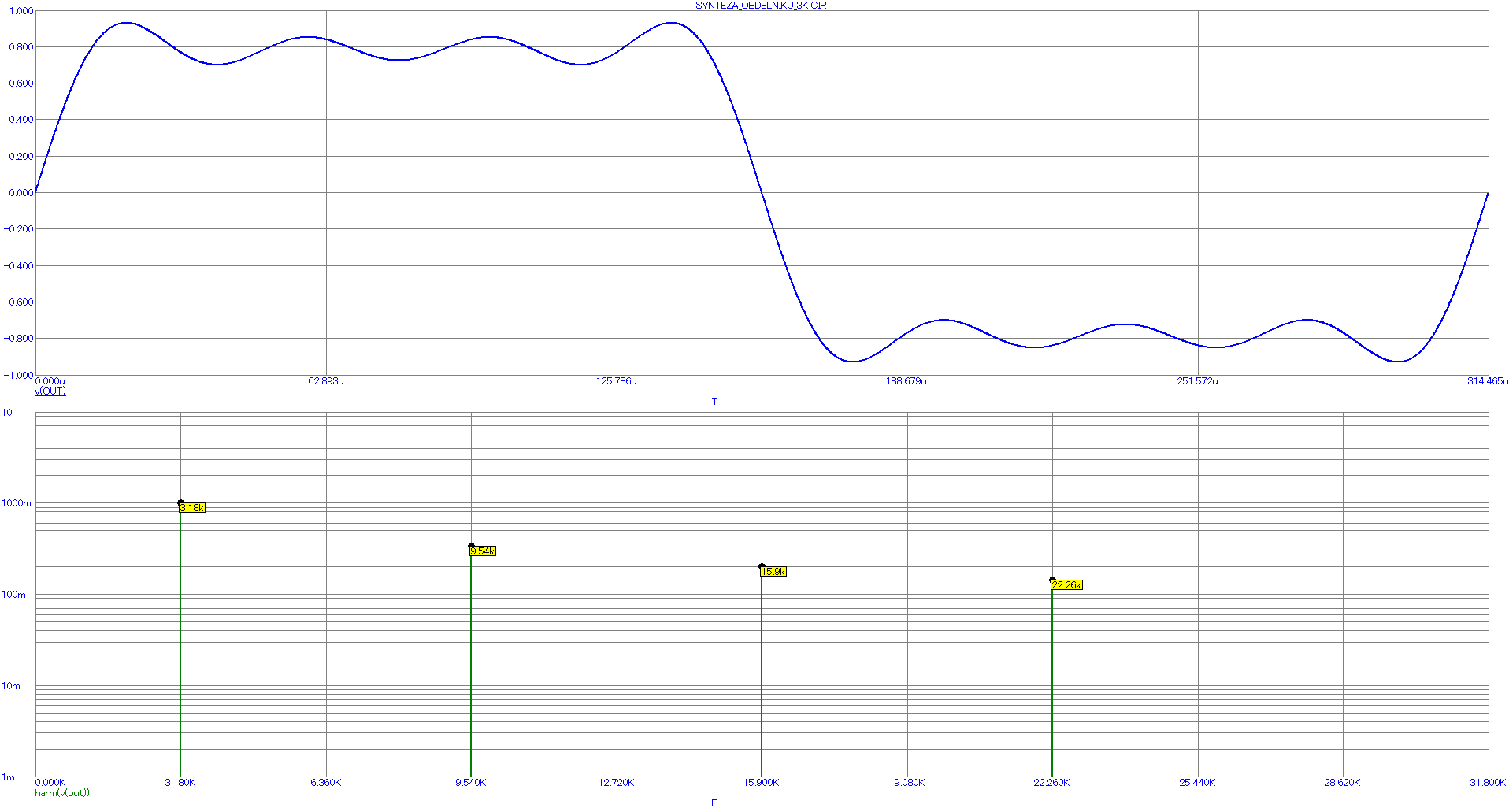

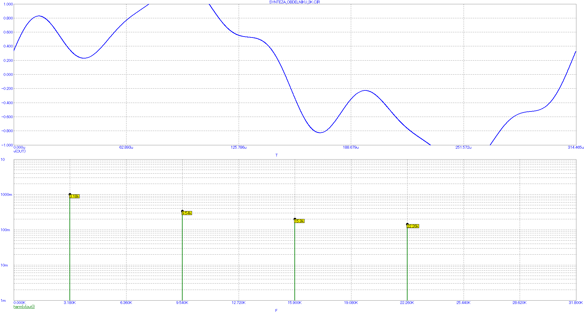

You are right. My favourite plots showing this is a sum of sine waves with same spectra - the only difference is a phase of sine waves. This results in totally different time waves. Same amplitude spectra, different time plots - because phase info is missing.

JN referred to the Real component of an FFT.
In your example they will differ completely.
However the moduli of Re and Im, the amplitude spectra as you mention, will be the same.
Hans

Very nice. I've no idea how to interpret the different filters.To further stir the pot..
Jn
