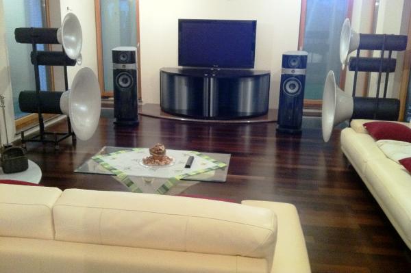

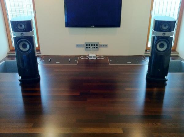

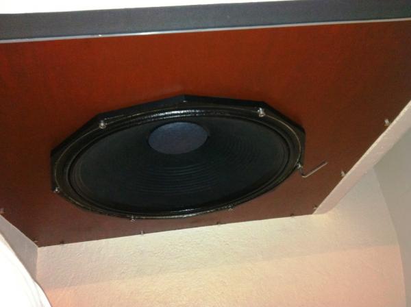

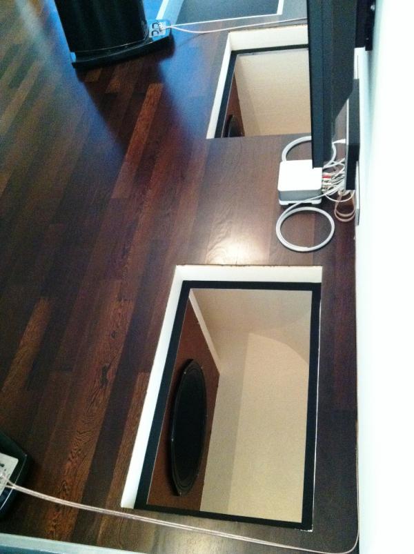

These two PD.2450 are located below my living room as seen on pics and Avantgarde Trio are now correctly positioned since Focal Scala speakers were sold. 😎

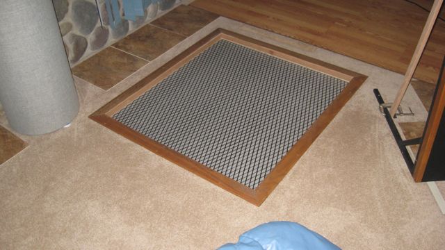

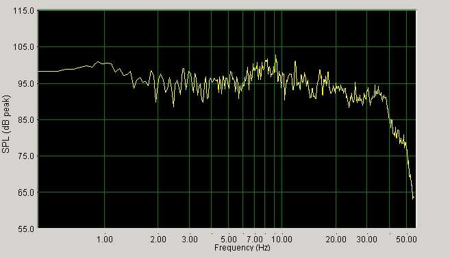

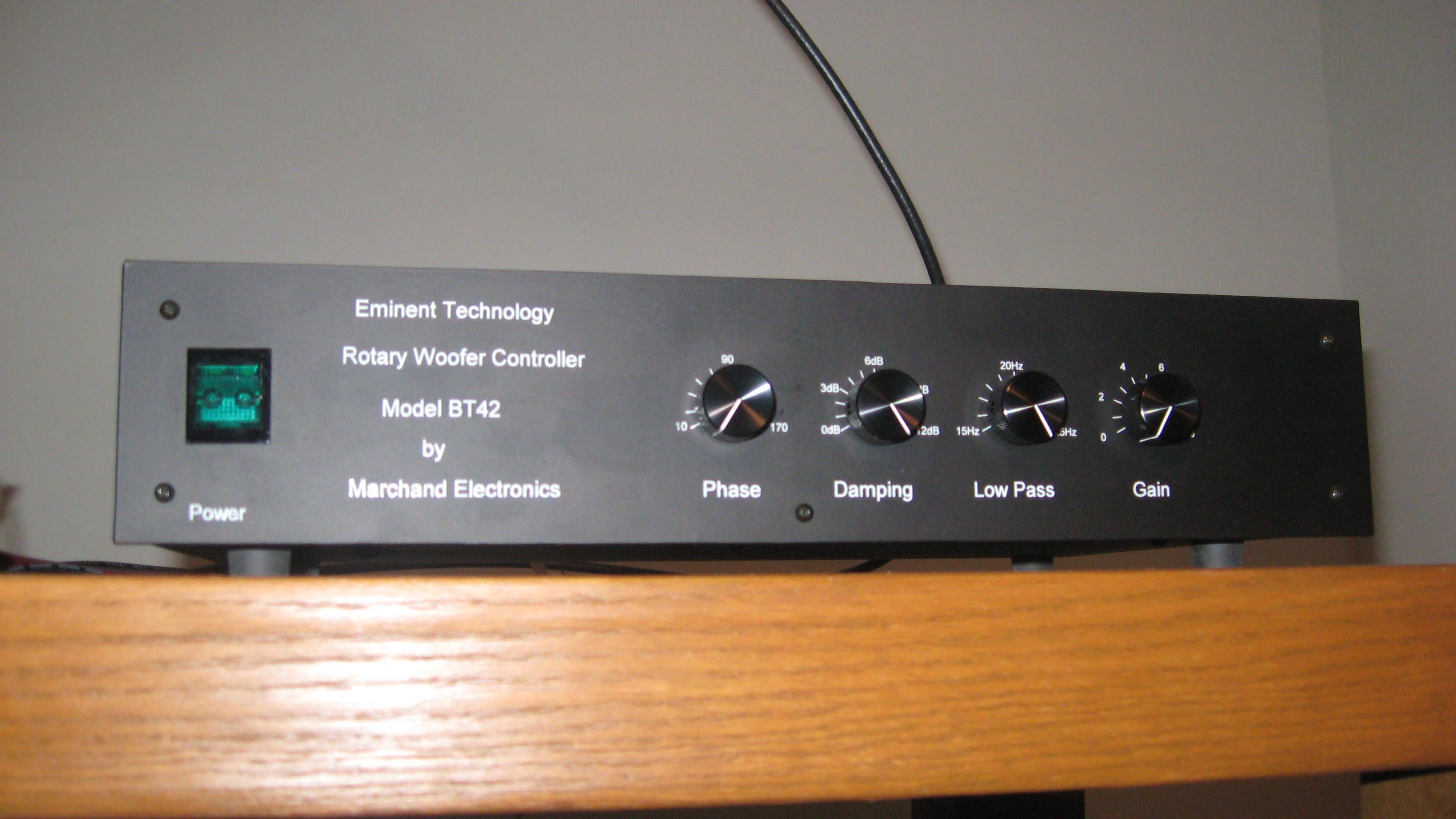

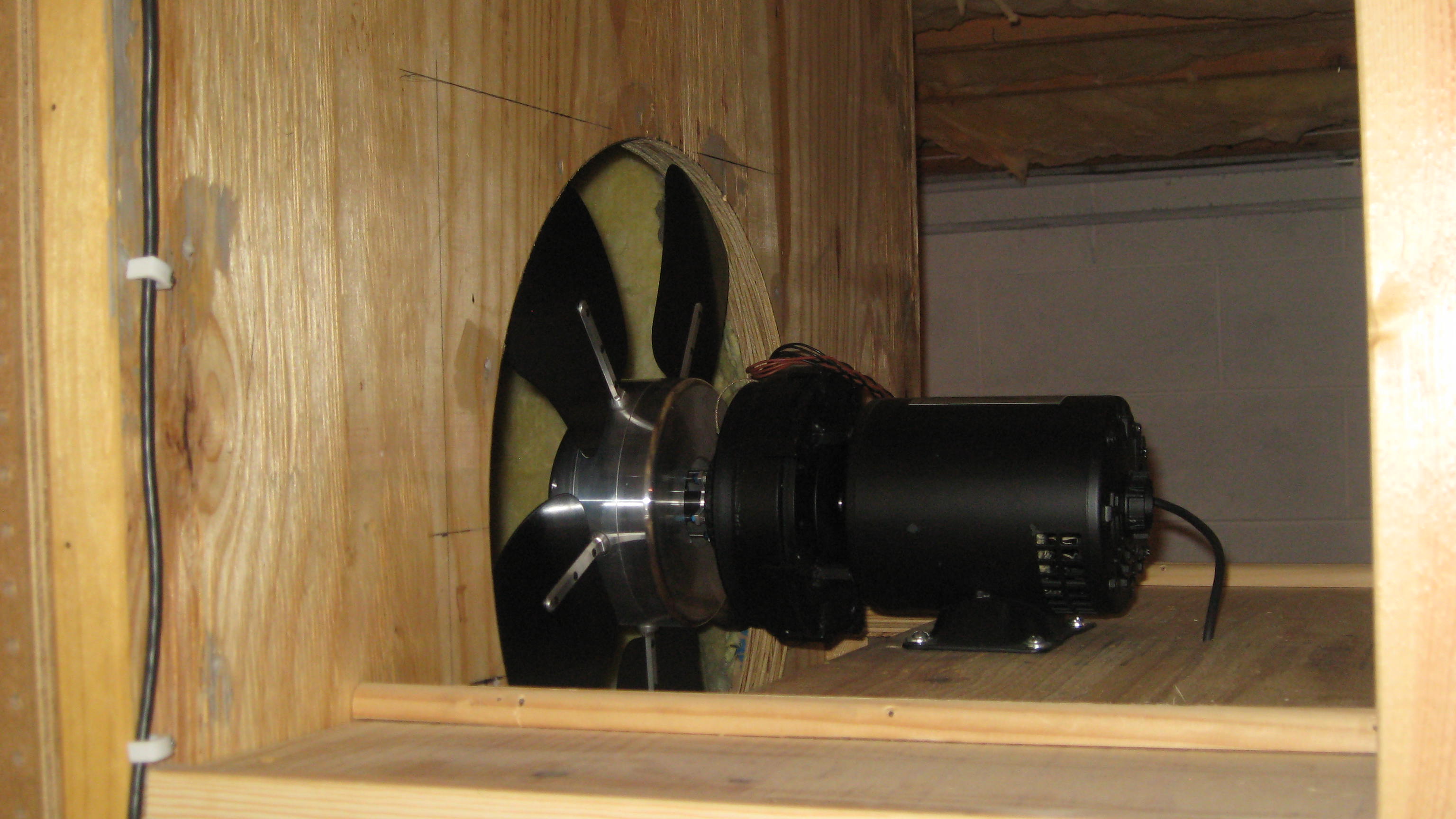

Rotary Subwoofer
The rotary subwoofer is an awesome product that works as intended.
From 25 hz down to below 1 hz with very low distortion and transient
response that is superb! No worries about overdriving or damaging
and just plain realistic.

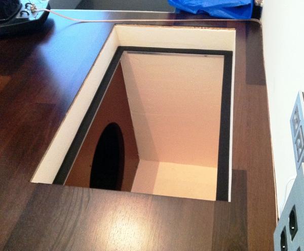

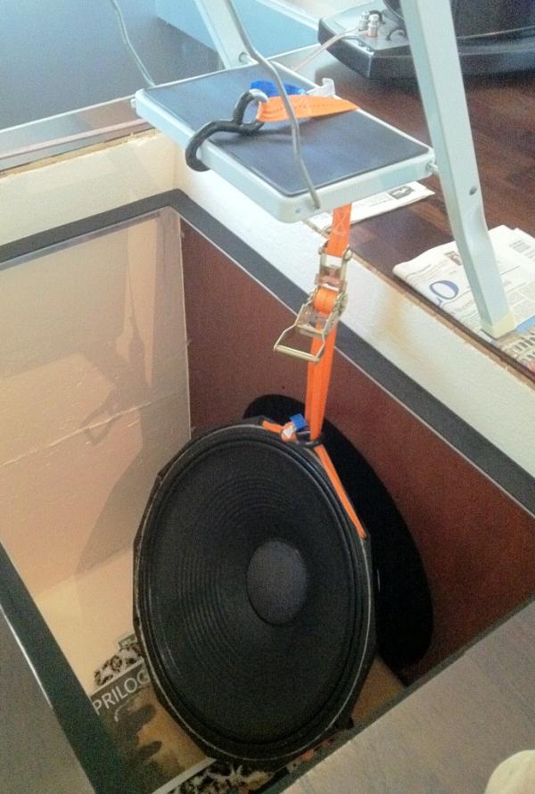

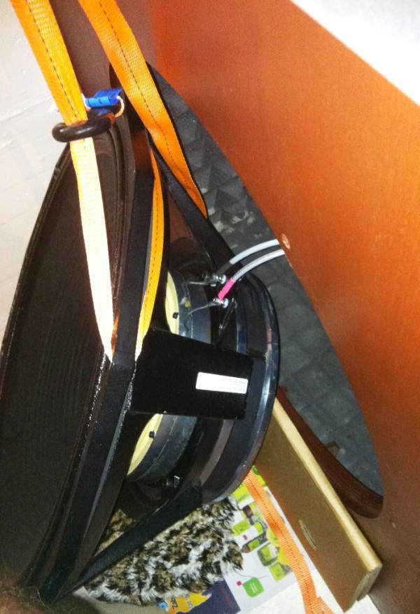

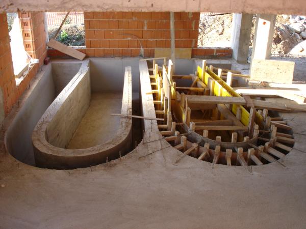

"Making of ..." photo set 😉
Thats a cool build, now all you need is a pair of trw17's to finish off the frequency responce to DC.
Wow, can you provide additional details on the bass horns, such as freq response that the horns are producing in room.
Thanks but no thanks, I don't need spike-ing ventilators everywhere near my living room.

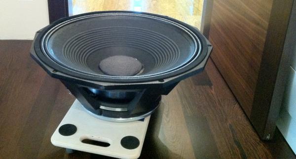

Two identical-mirrored under floor sub-bass horns:
- PD.2450 subwoofer driver, 1000 Wrms/4 ohm, 90 dB/1 W/1 m at 20 Hz
- 2,5 m3 closed-sealed chamber behind each sub-driver, acoustically treated
- 0,5 m3 compression chamber in front of each driver, sound pressure linearization to horn mouth
- 9 m long exponential under floor horn, tuned to quarter wavelenght (λ/4) of 9,5 Hz
- frequency response 10-40 Hz, active filter -24 dB/oct
It sounds atmospheric, effortless, re-creates ambient from recordings, focus the sound of the upper bandwidth. Very happy with the results.

I see you are using the Avantgarde bass bins as well. Any thoughts on runnng the big bass horns up to 100hz? I am only asking as my 100cm mid bass horn will go from 100hz up and i need to fill from 20 0r 30 hz up to there.
I checked the response without active filter and you can clearly hear the frequencies up to 1 kHz although attenuated. Frequency response is normally decending from its tuned 9,5 Hz slowly to zero if you go up to kHz region. 100 Hz would be the absolute max. for this design and in this case you would need to linearize-equalize its frequency response with adoptable active filter. 😉
