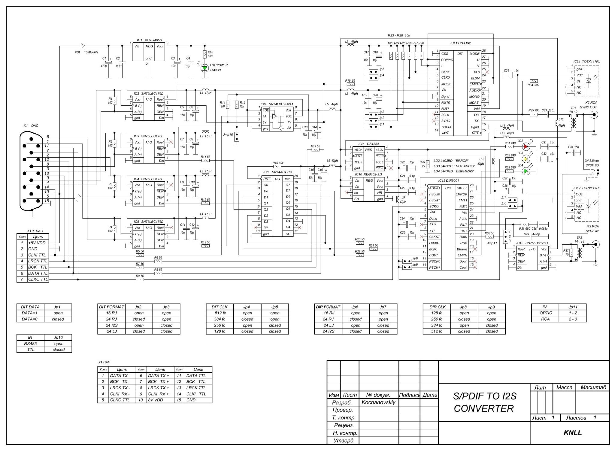

So this means you've a system that can't play back any 48k-family sample rates?
Another question seeing as I've not come across such an arrangement as yours before - are the reclocked signals sent twice through the ABT574? If so, that would be a way to mitigate metastability.
there's still plenty of possibility for metastabilty as there's nothing ensuring the ABT574's set-up and hold times will be met.
Do you mean synchronisation of a flip flop with an incoming stream? There's one more thing that should be taken into account: the first stage of synchronous reclocking is done in the converter. As soon the stream goes into the DAC from converter it is processed by a digital filter IC: SM5842
I'm not clear what 'the converter' means here. In your described locking system there's no taking account of (for example) the propagation delays down the S/PDIF interconnects which means the phase of the 33.8MHz originating clock won't get preserved at the soundcard. Hence no telling where the data transitions will be vis-a-vis the 33.8MHz clock when the signal arrives back.
As this is a DIY forum I'd strongly suggest modding your DAC to use two flip-flops in series in your resynchronizer to reduce the likelihood of metastability. The ABT574 has 8 flip-flips so probably you won't even need to add an extra IC.
Please find attached the schematics of the converter.

If you wish to reduce the chance of a metastable FF output reaching your PCM63s* to a minimum, yes.
*Actually your SM5842, which sits prior to the PCM63s.
You know after more thinking about your advice on the use of 2 flip flops prior to PCM-63 I came to conclusion that my DAC and converter indeed uses exactly this set up. It's just that the first flip flop is in the converter right after DIR9001, then the stream goes to the DAC wherein it is processed through SM5842, an isolator and then a flip flop again and PCM-63. So I have in total 2 flip flops on the way of the sgnal.
From the point of view of mitigating metastability, it isn't exactly the same set up. Its not the total number of FFs that's important, rather the use of two in quick succession with the same clock.
