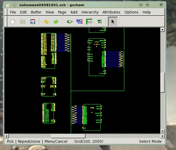

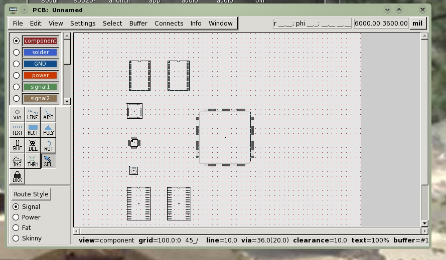

for linux, there's the gEDA suite found here:
gEDA Project's Homepage
or you can run your favorite windows CAD programs:
WineHQ - Run Windows applications on Linux, BSD, Solaris and Mac OS X
not only is the software free, but so is the OS, here's a couple of links:
The Slackware Linux Project
Ubuntu Home Page | Ubuntu
links to other distributions can be found here:
http://www.linuxquestions.org/questions/linux-distributions-5
Linux Online - List of distributions

not all linux software is comand line based, as you can see from the screen shots of the gEDA schematic capture and PCB layout GUI interfaces shown below...
most modern distributions of linux have GUI interfaces much like windows and can even be made to behave much like the windows interface. i am using slackware, which, while having a lot of GUI based apps, has it's share of configuration, etc that is still done by CLI (command line interface), but even when i was using windows, i still did a lot of stuff through open DOS windows. there are distributions of linux that have virtually eliminated the need for a CLI for anything a "normal" user would want to do. the view of linux being a command line based environment is pretty much a thing of the past
