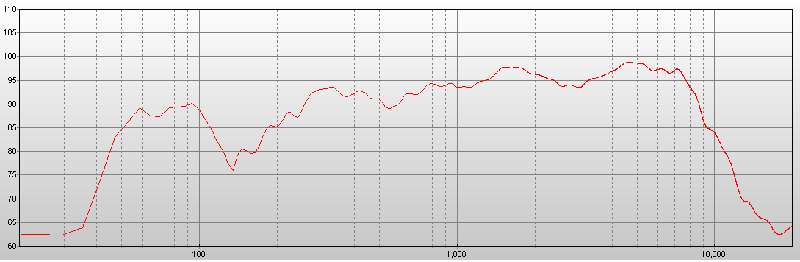

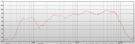

What about the PHL1220?
Its a nice midbass. Very clear, punchy and harmonious.
Here is a response graph on an 11 litre box. Please ignore the midbass cancelation, its a function of floor path interference.
The SPL reading is calibated. With a 2mH coil you can level it and cross some (efficient) tweeter at about 2.5kHz.
