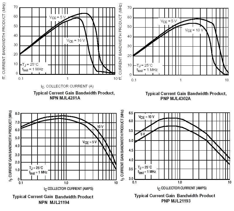

"...and i really cannot see how the MJL21194/93 pair can be said to be appreciably faster beyond 4A"
"...further, any differences in SOA are vanishingly negligible......."
Hey, I'm sorry you can't read the data sheets right.
Fig. 9 on the MJL4281 shows the unity gain bandwidth product to clearly be in the 2Mhz~3Mhz region at 5A. If I'm going to use this as a driver at 2A or less it is 40Mhz~50Mhz.
Fig.2 on the MJ21194 shows the gain bandwidth product at 5A to be almost 5Mhz.
Last time I checked, 5Mhz was faster than 3Mhz.

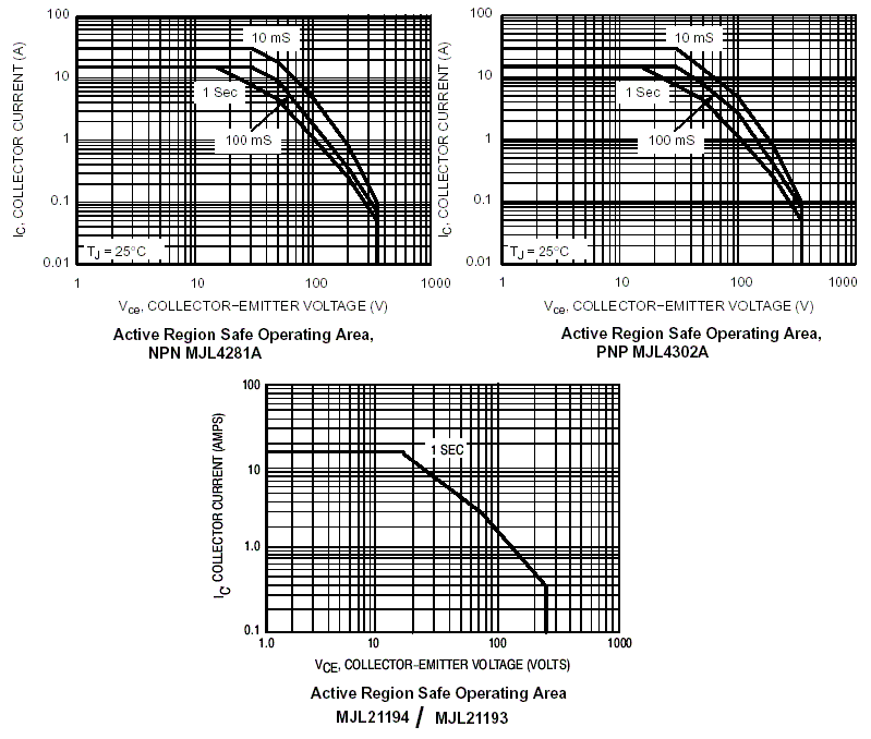

Fig.11 on the MJL4281 shows the safe area as being 100W at 100V
Fig. 13 on the MJ21194 shows the safe area as being 200W at 100V
The last time I checked, 200W was not a 'vanishing negligble' difference compared to 100W.
Pro amps with ±100V rails are not uncommon today. Peak currents at 2R are on the order of 40A. Without a tiered supply a popular amp uses 8 pair of MJ21193/94, about 5A per pair, another model from the same company with the same main rail voltages with a two tier supply only has 3 pair of 3281/1302, about 13A per pair.

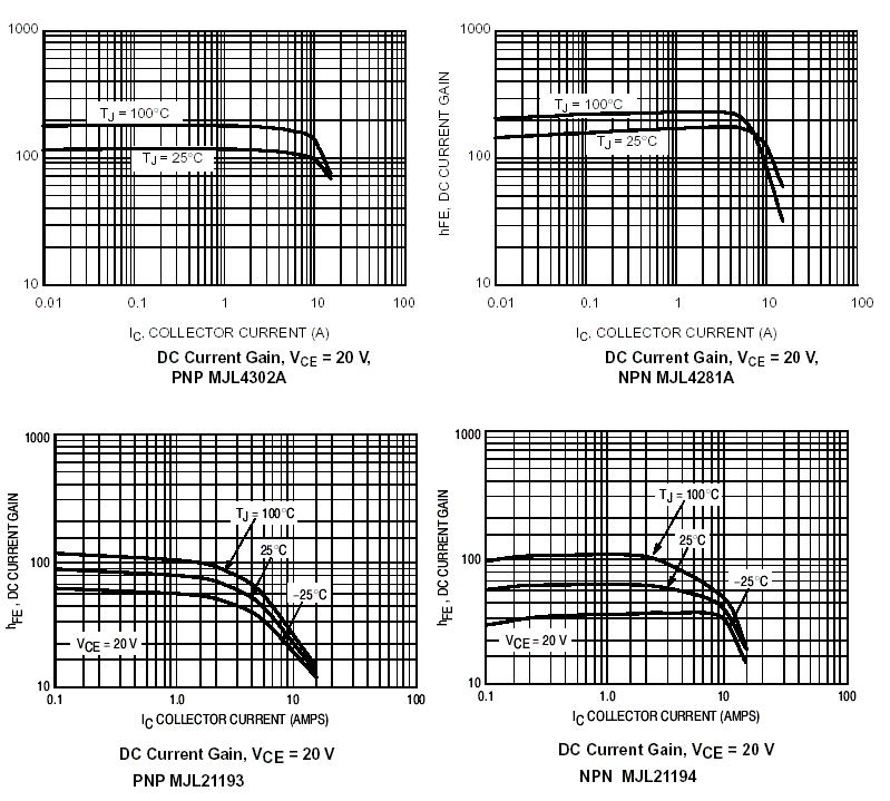

Current gain is vastly inferior to the onsemi's.......therefore sankens significantly less linear than either the new onsemi devices, or even their earlier MJL3281A/1302A BJT's

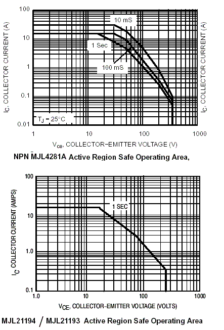

If you tried to get the MJL21194'S to deliver 200W with 100v across them, they would promptly expire....see figure attached...
