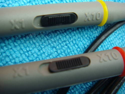

Make sure you get probes where the 1:10 indicator works with this scope.

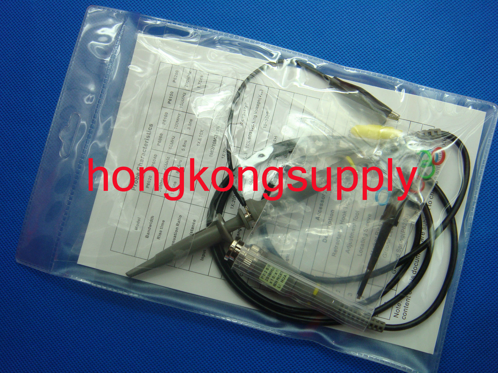

How this probe ?
I found now on eBay
2 units not expensive
2 HANTEK Oscilloscope Scope Clip Probe 200MHz Kit SALE
2 HANTEK Oscilloscope Scope Clip Probe 200MHz Kit SALE | eBay
I found now on eBay
Make sure you get probes with the pin on the outside of the BNC plug to let the CRO know what division ratio they are, for example the P6106A (Tektronix P6106A Passive Probe).
Otherwise the CRO will assume it's a divide by 1 probe, which can be confusing.

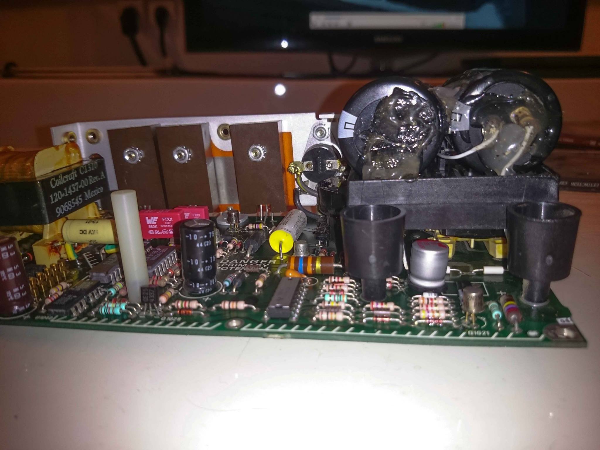

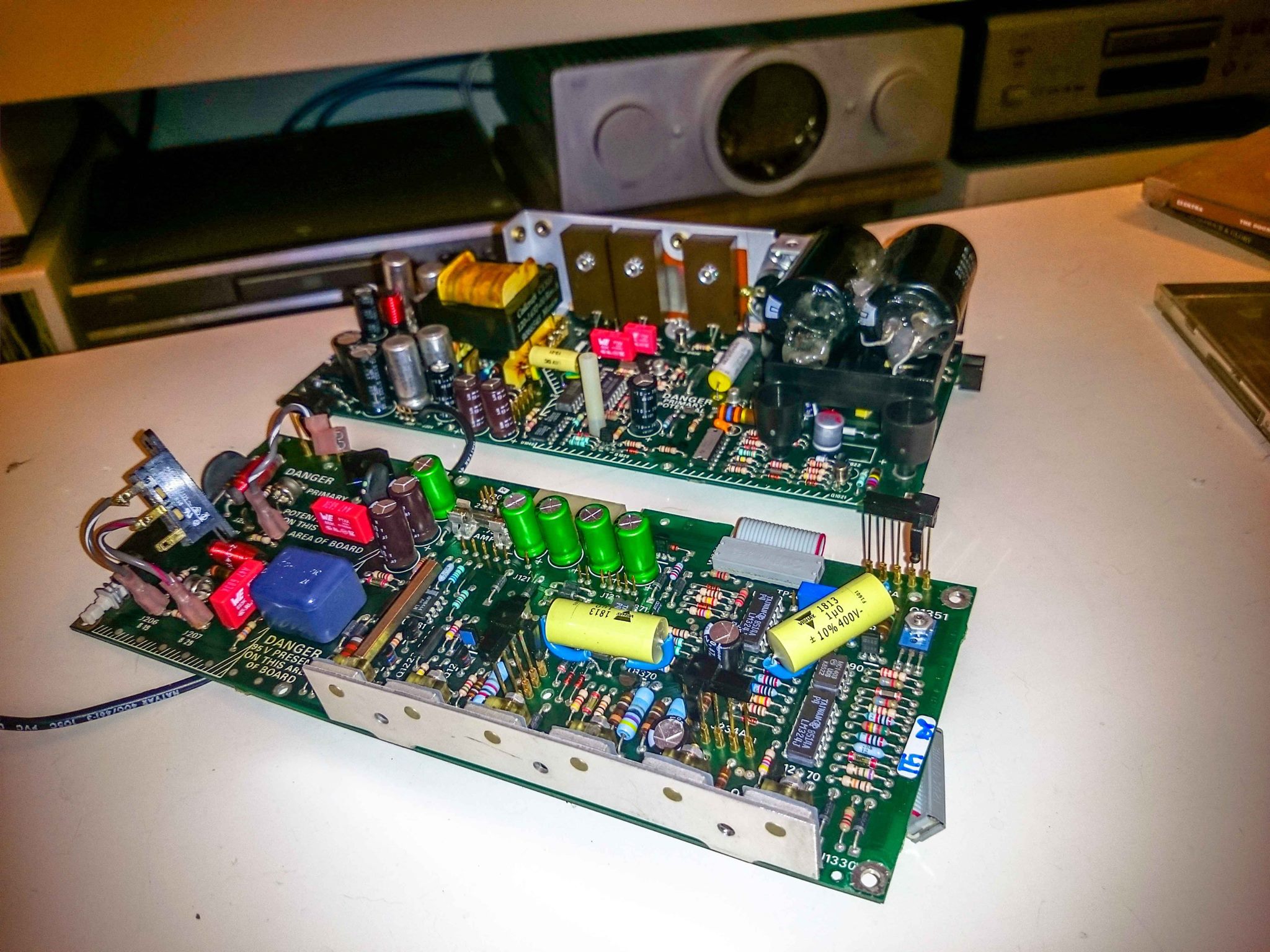

All those who say do not touch as long as it works

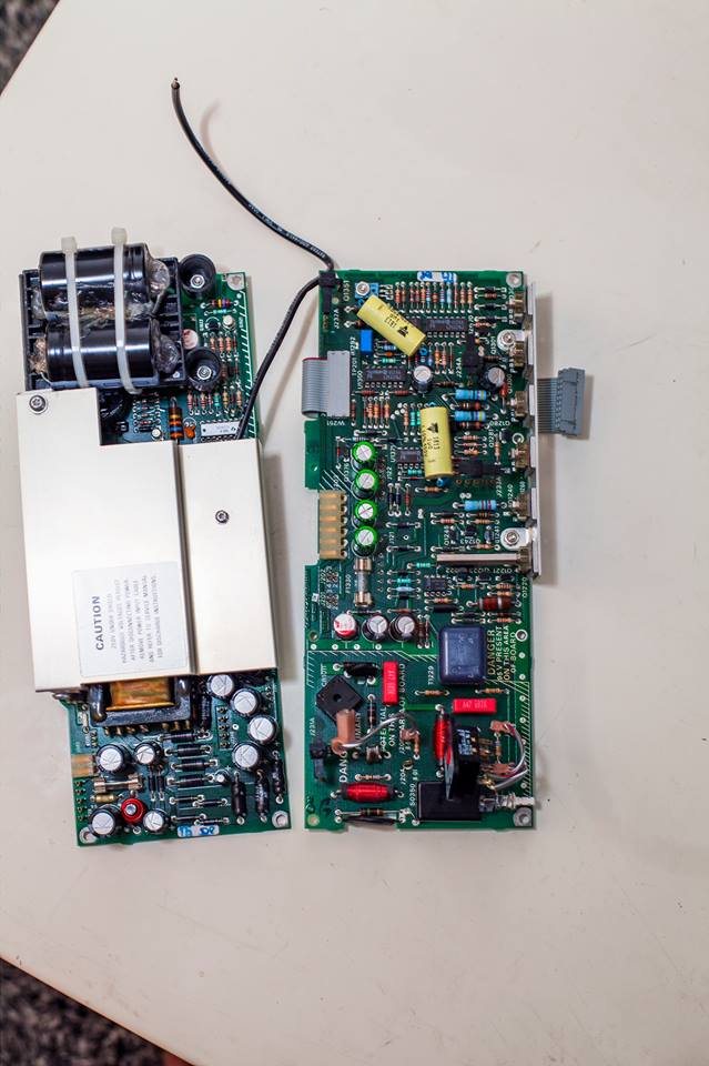

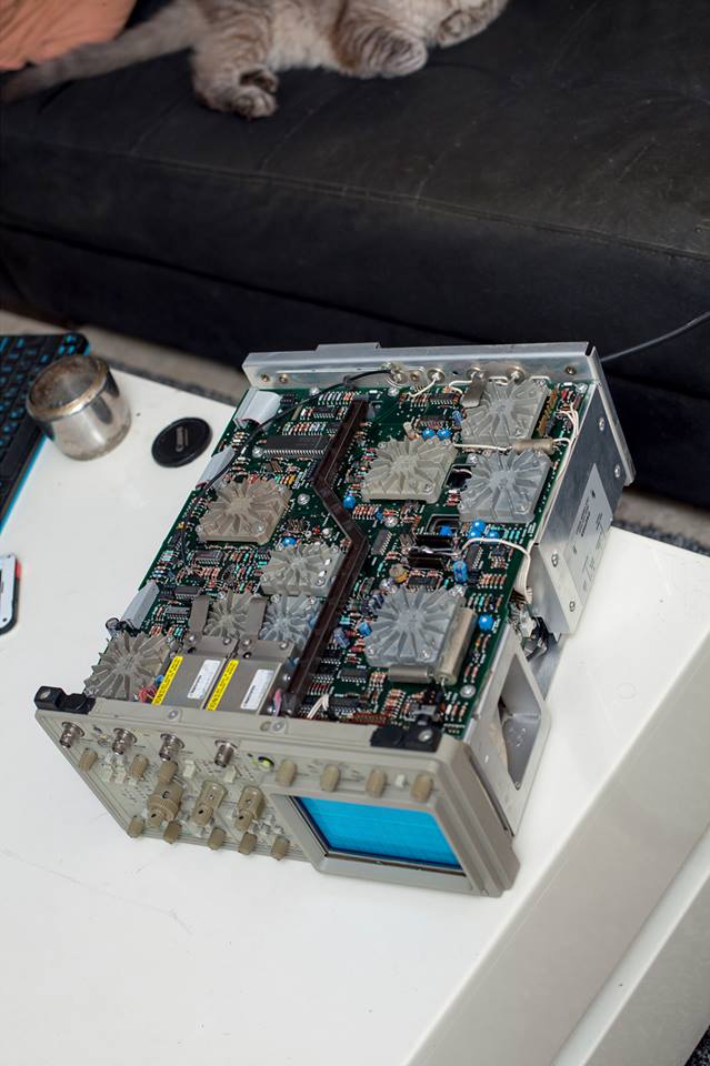

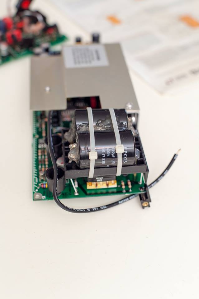

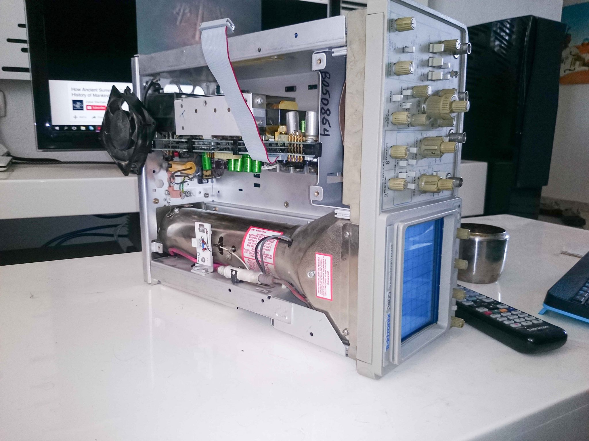

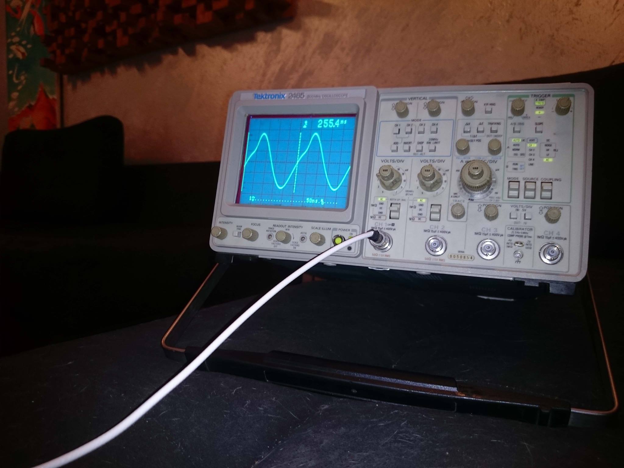

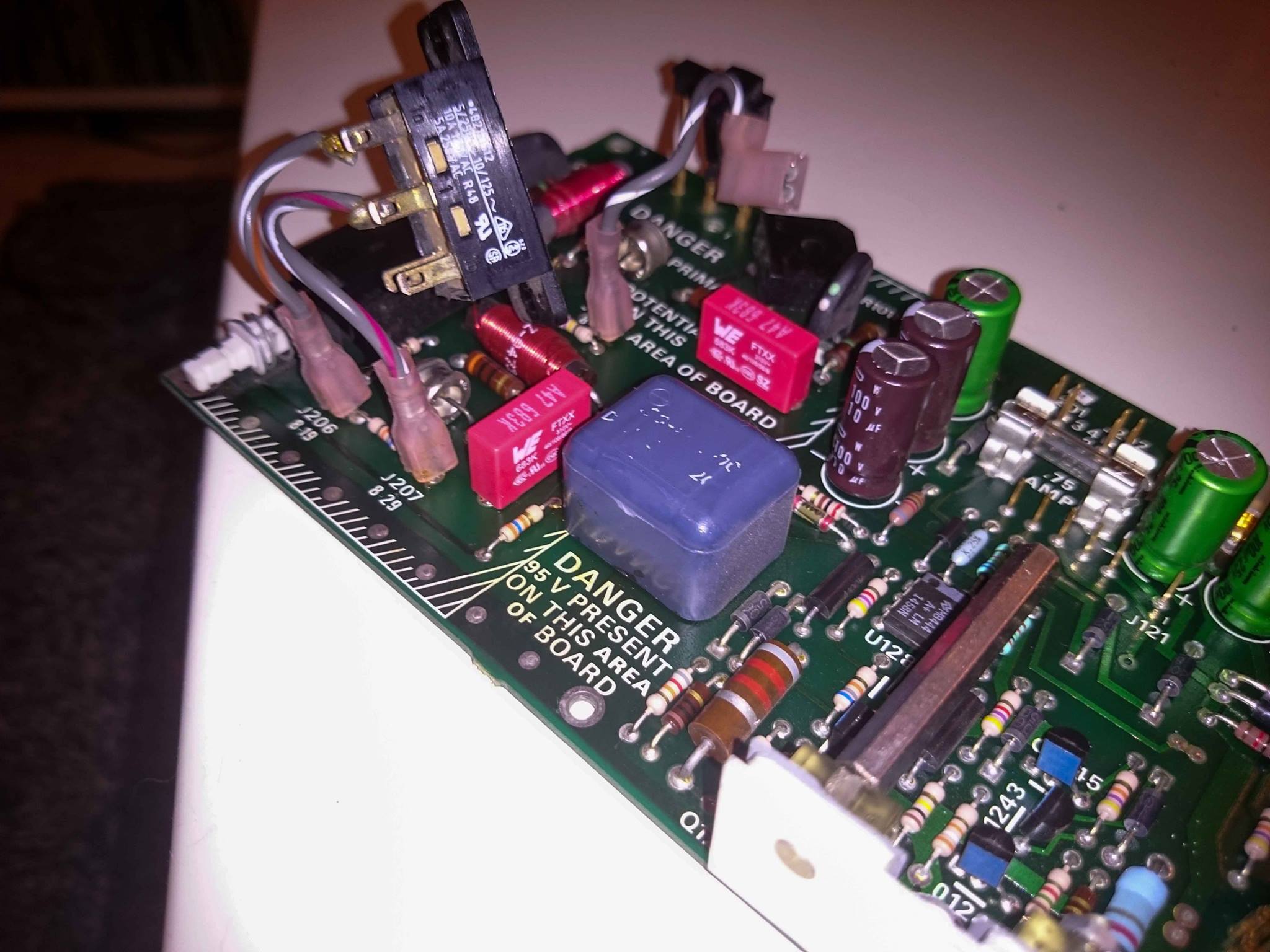

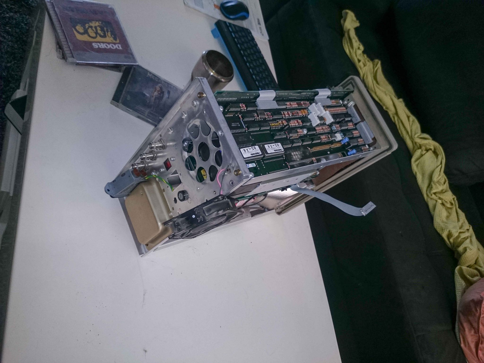

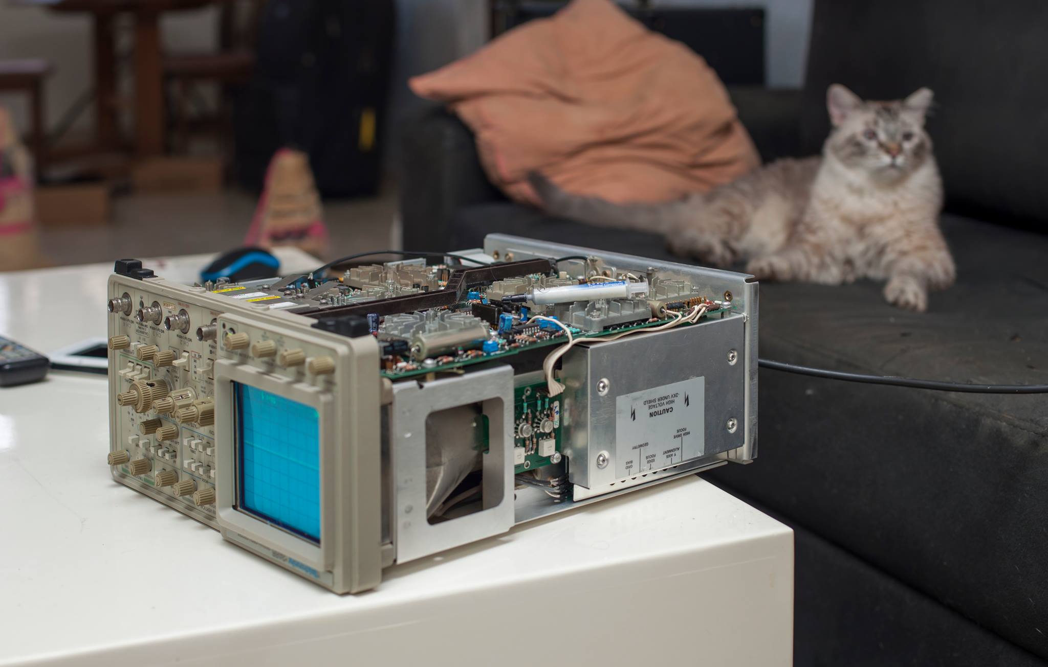

Today it happened. I used 2465
And suddenly, smoke, I turned off the TEK
I took it apart and saw it straight
the safety capacitors 5.6NF
it's Burnt
So get ready, I'm going to do what I originally ment to do
A comprehensive project for renewing the power supply
it's Burnt

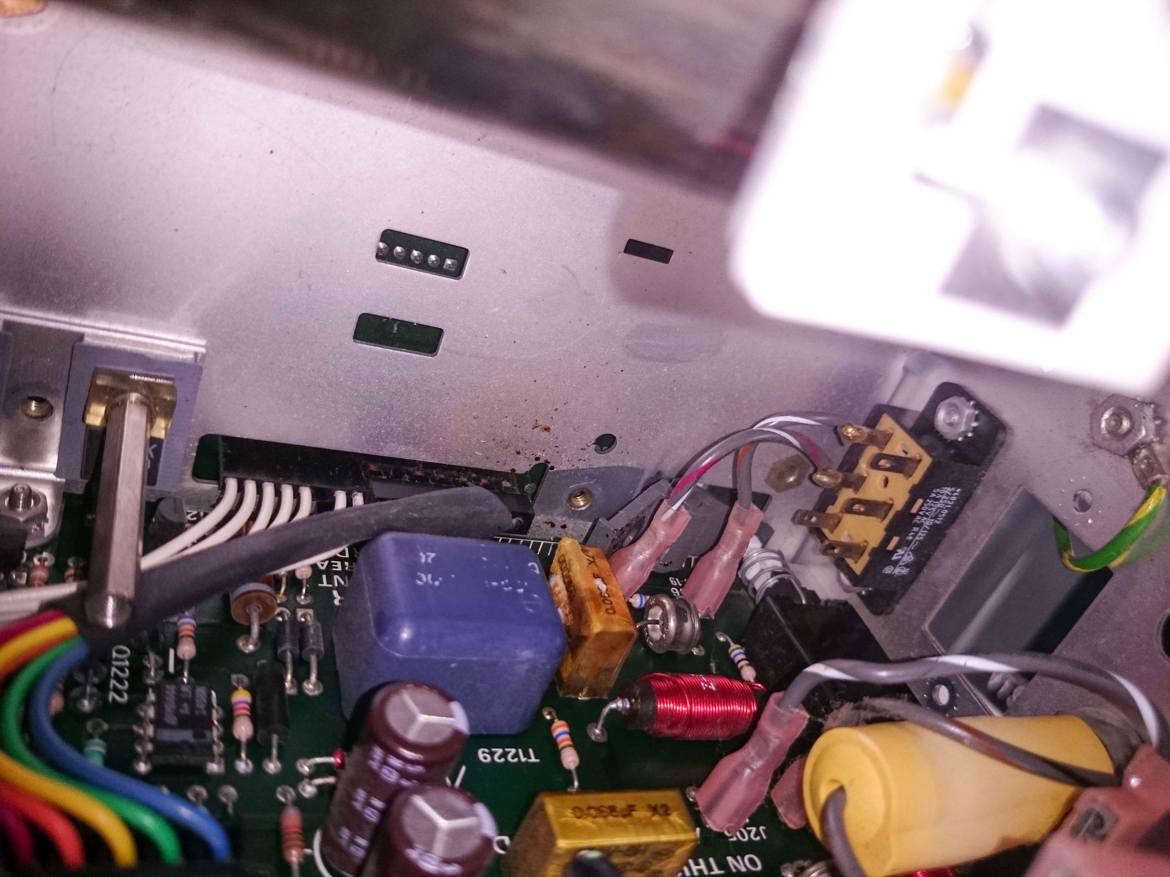

it's Burnt
I got the same issue, it's common with those caps.
Those are not 5.6 but 68nF, X2 rated.
You probably also have the 15R resistor in parallel with NTC burnt.
If interested I can send you service manual and one link about those issues.
These RIFA 'safety' capacitors are prone to fail safely. It has proven to be a good advice to replace them whereever one finds them, even if they appear to be ok.

The circuits thet I most like to work on is power supplies.

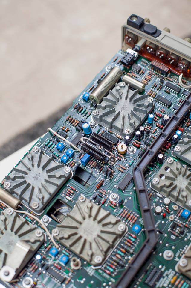

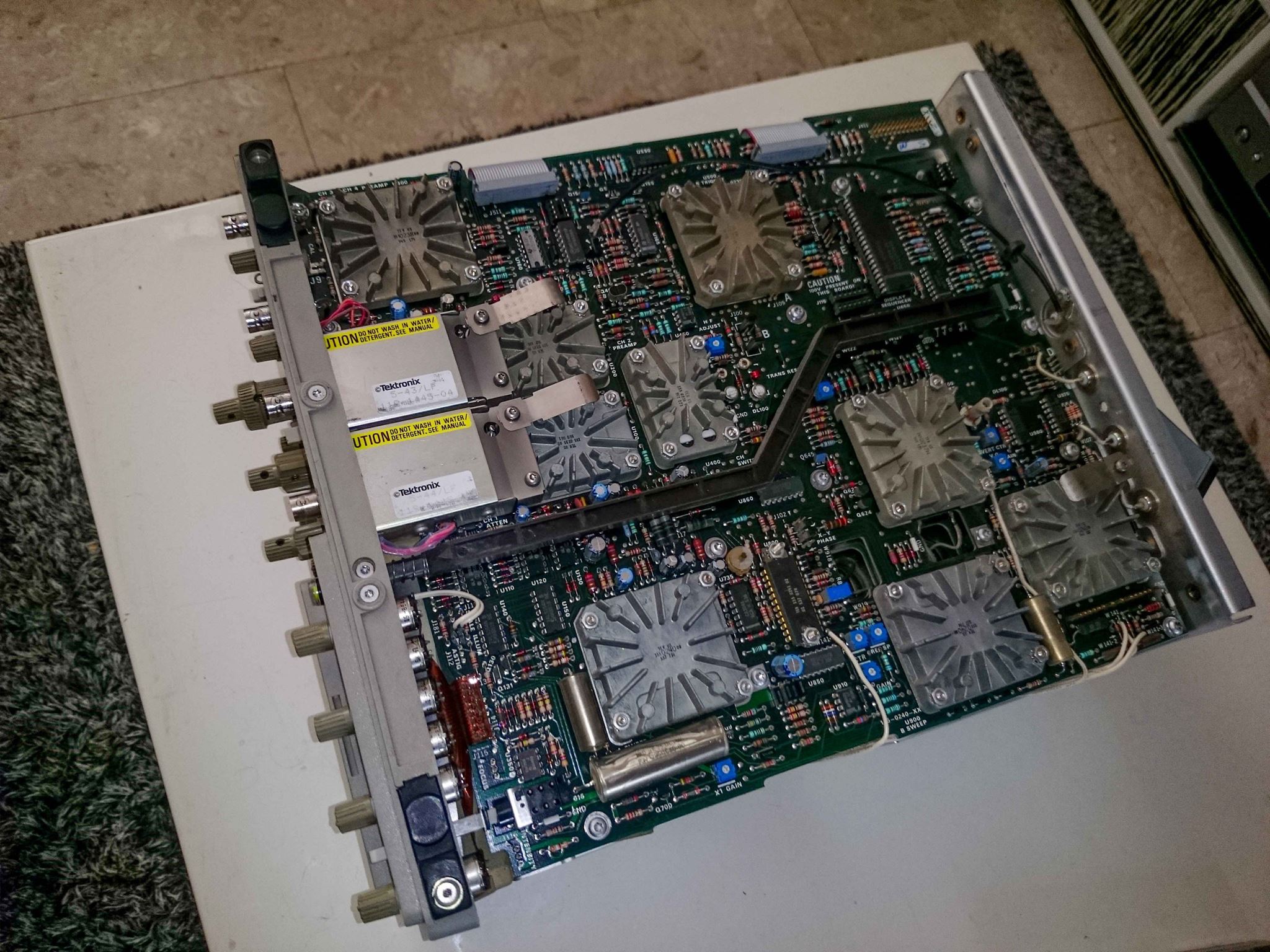

What upsets in the TEK is to dismantle it.
Its power supply is really simple
I already said that I hate star screws. 😡

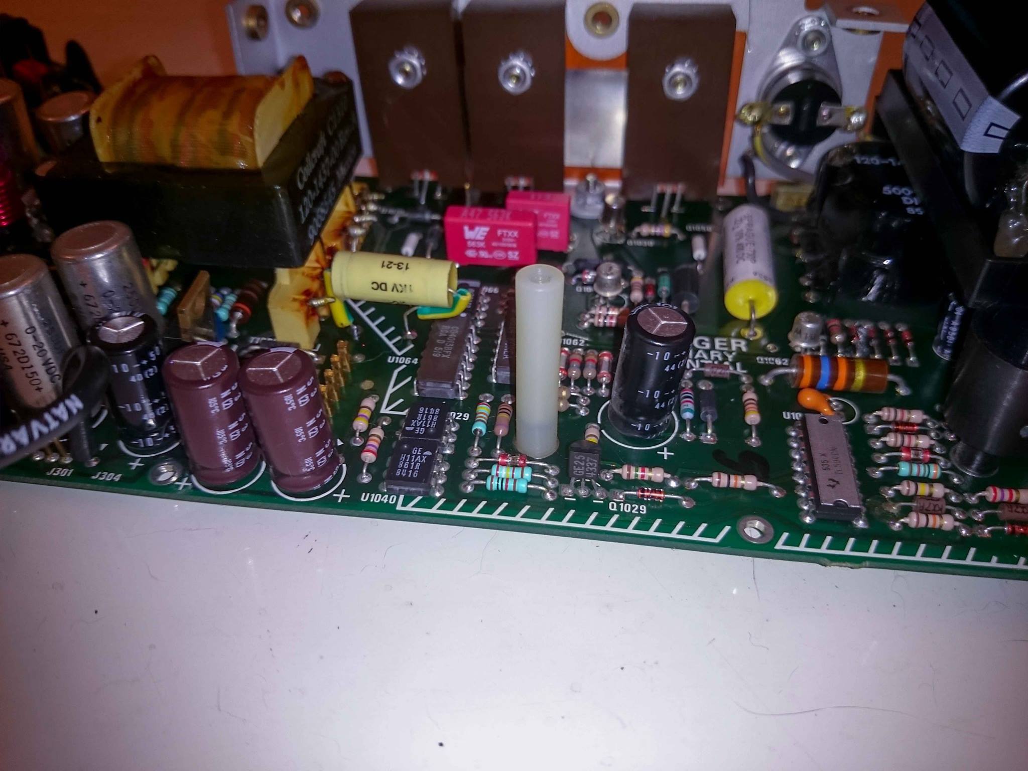

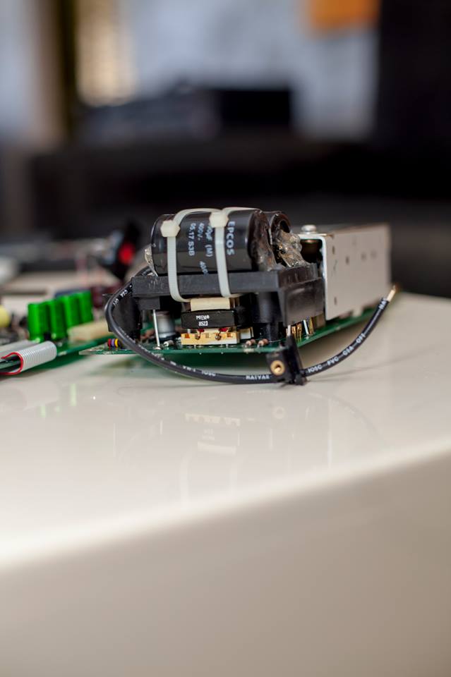

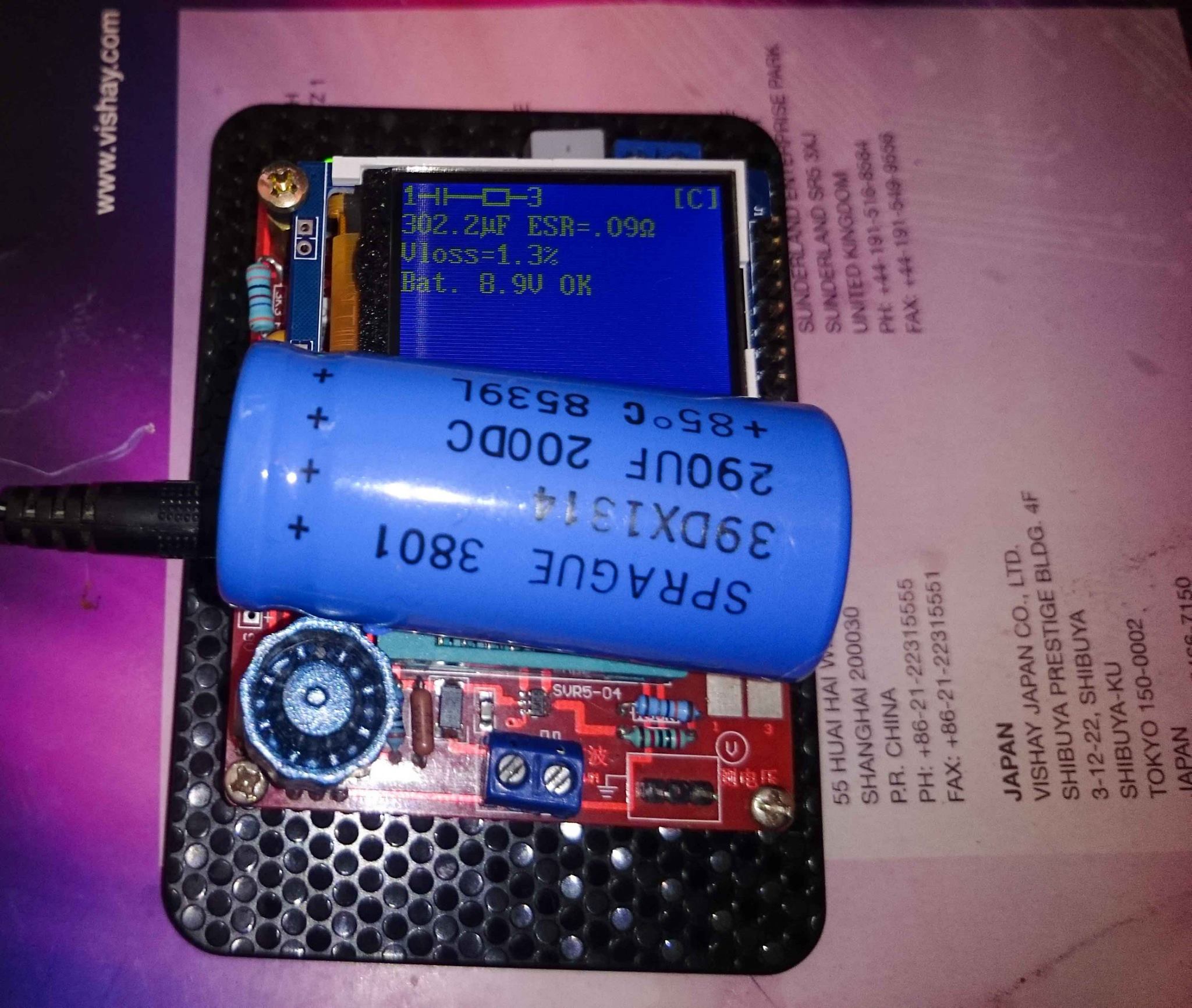

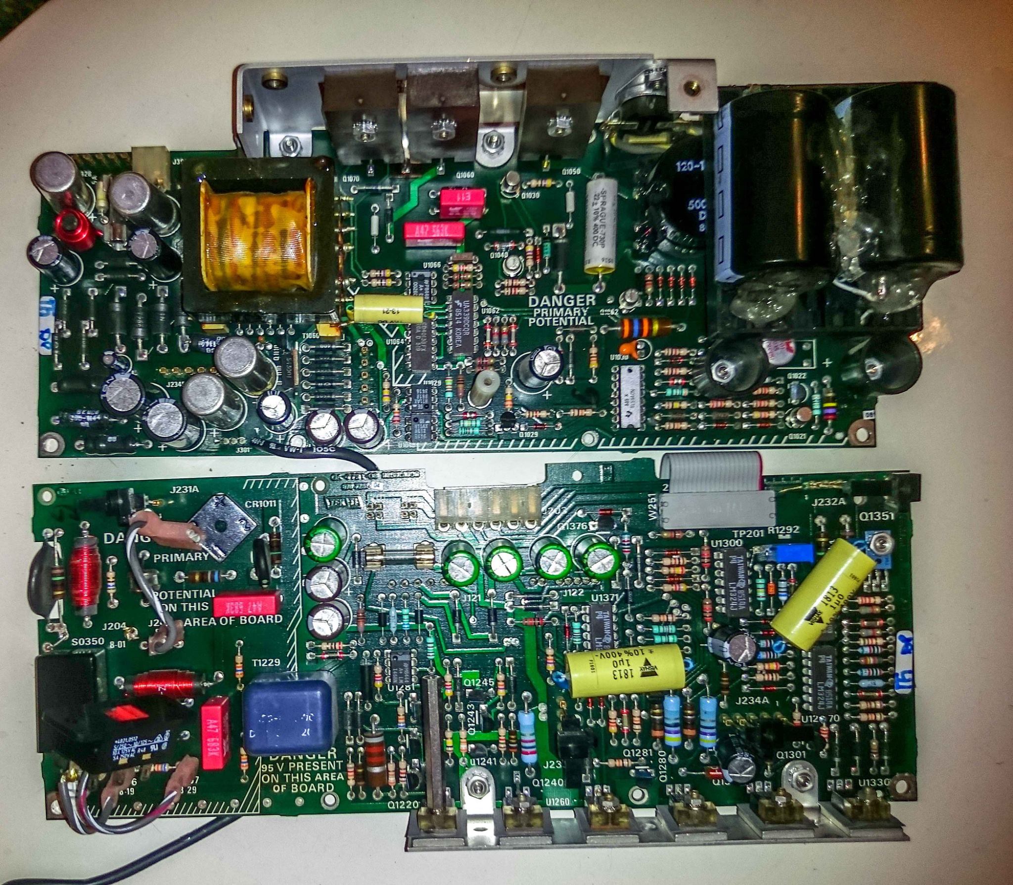

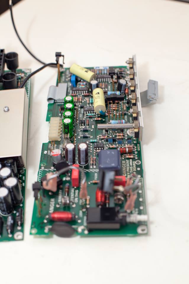

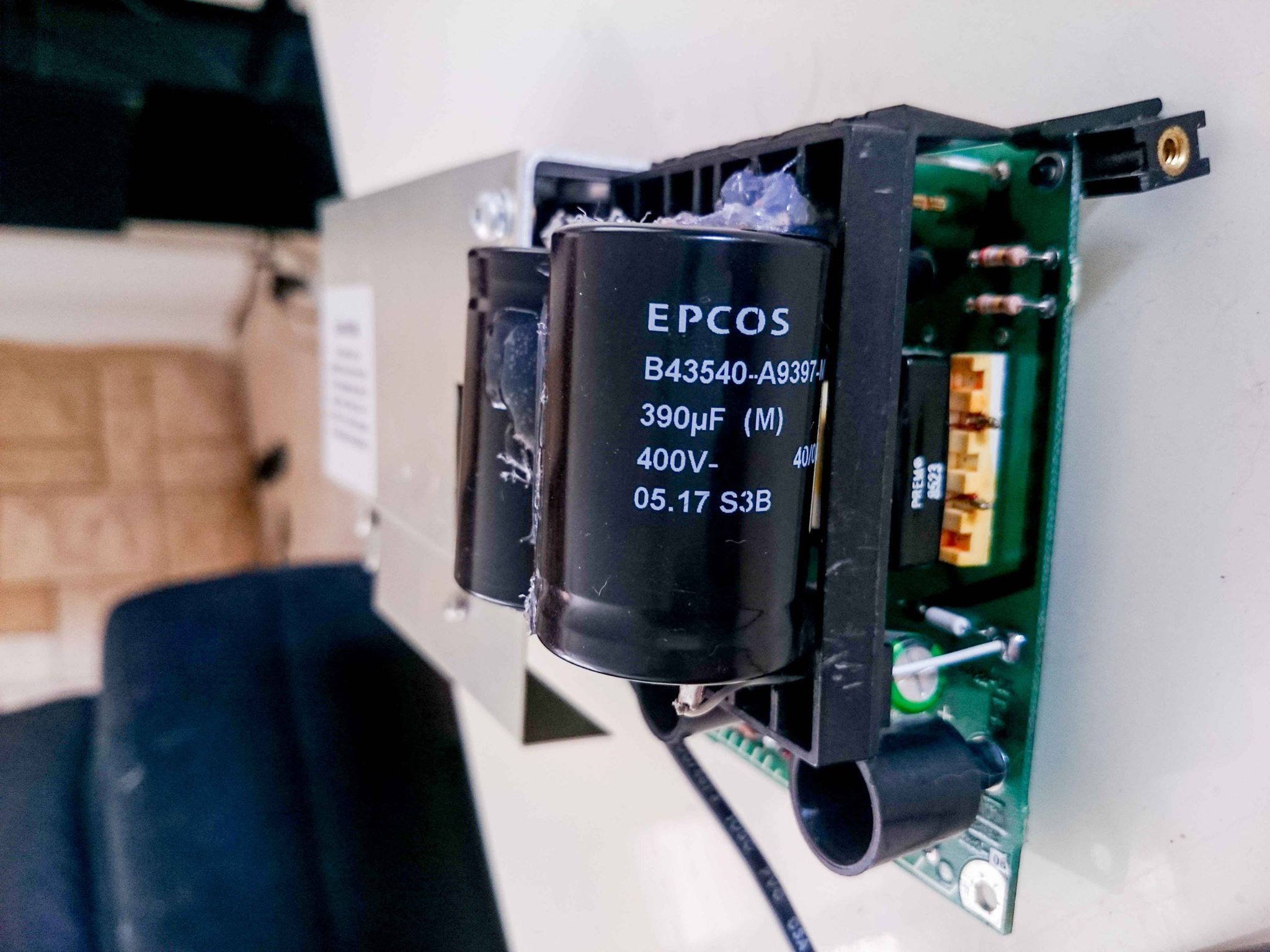

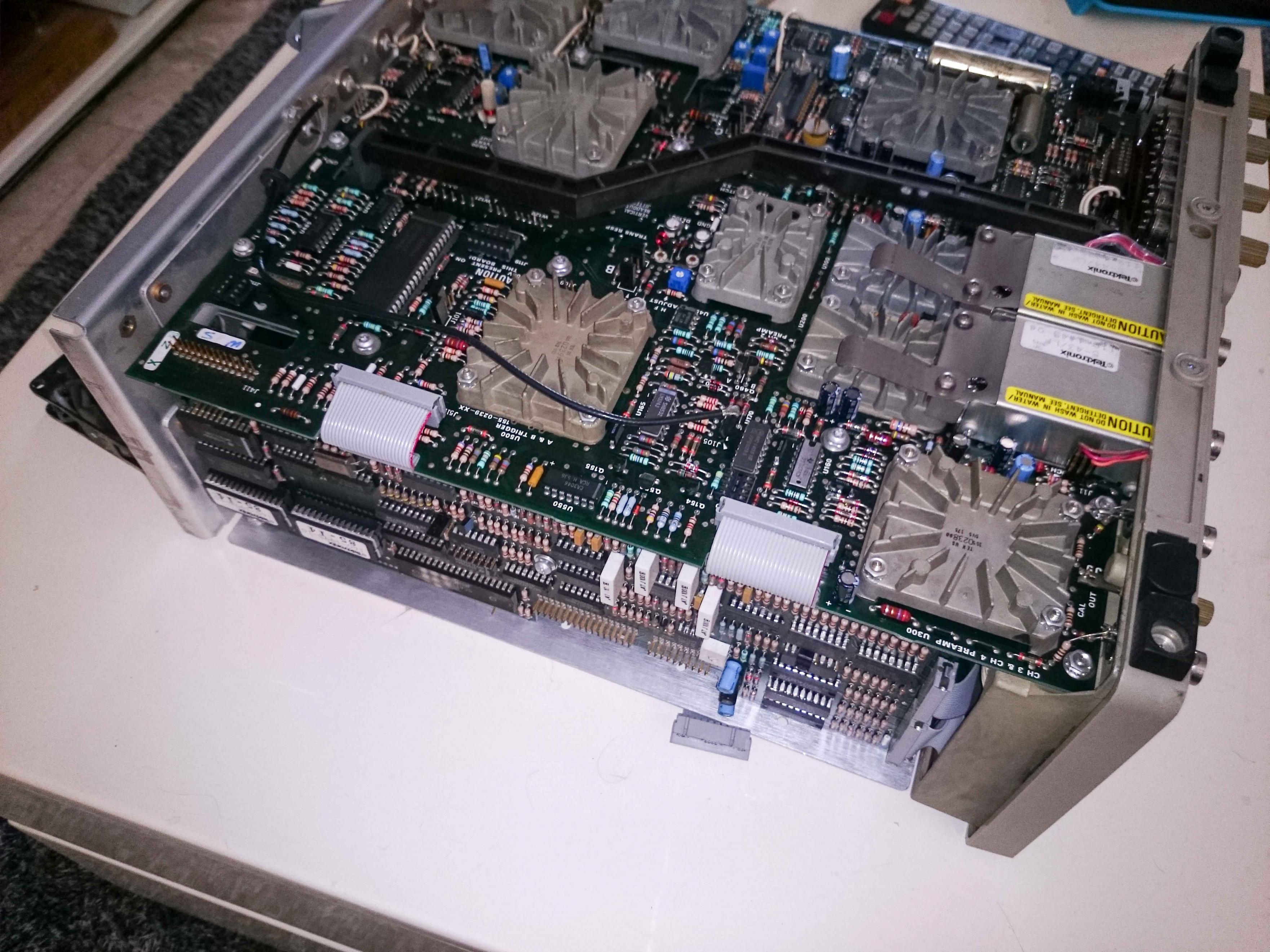

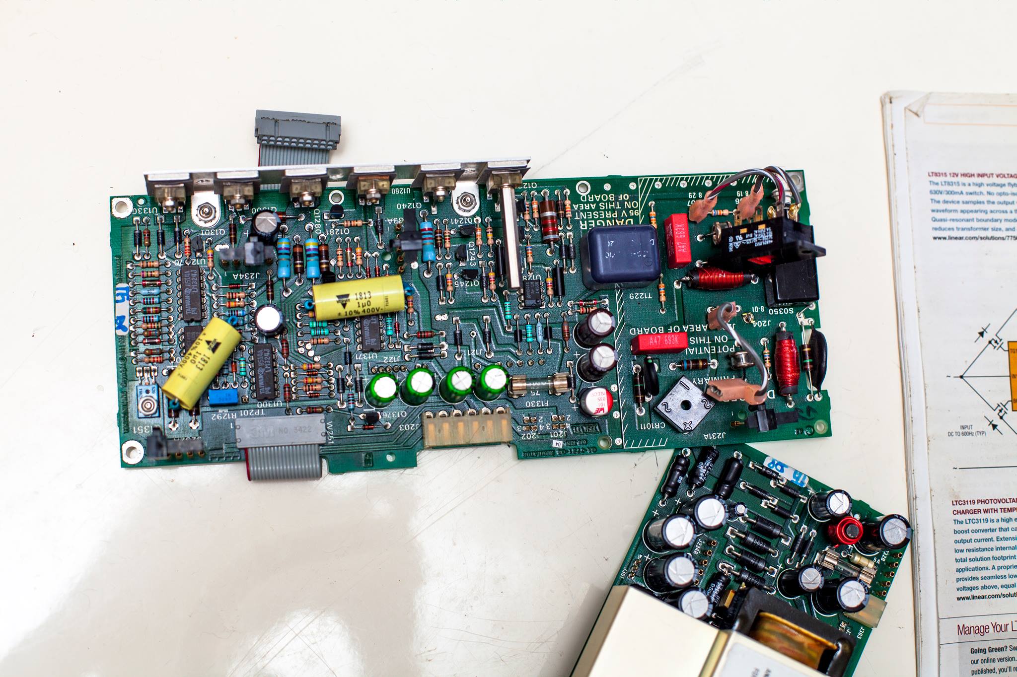

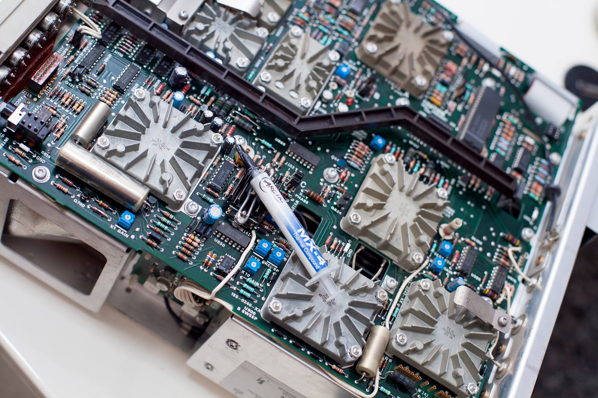

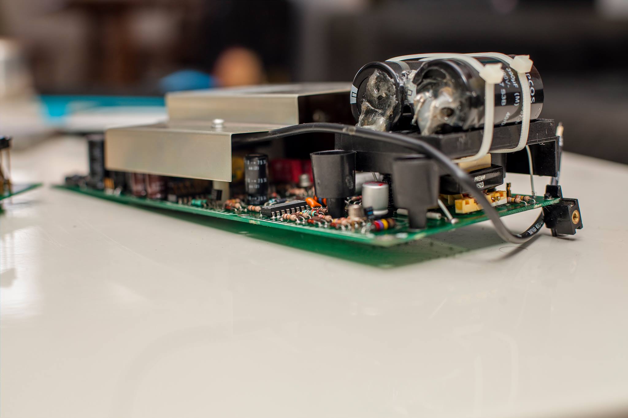

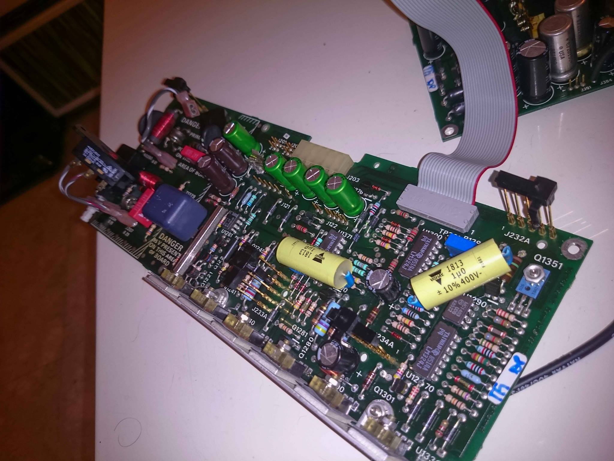

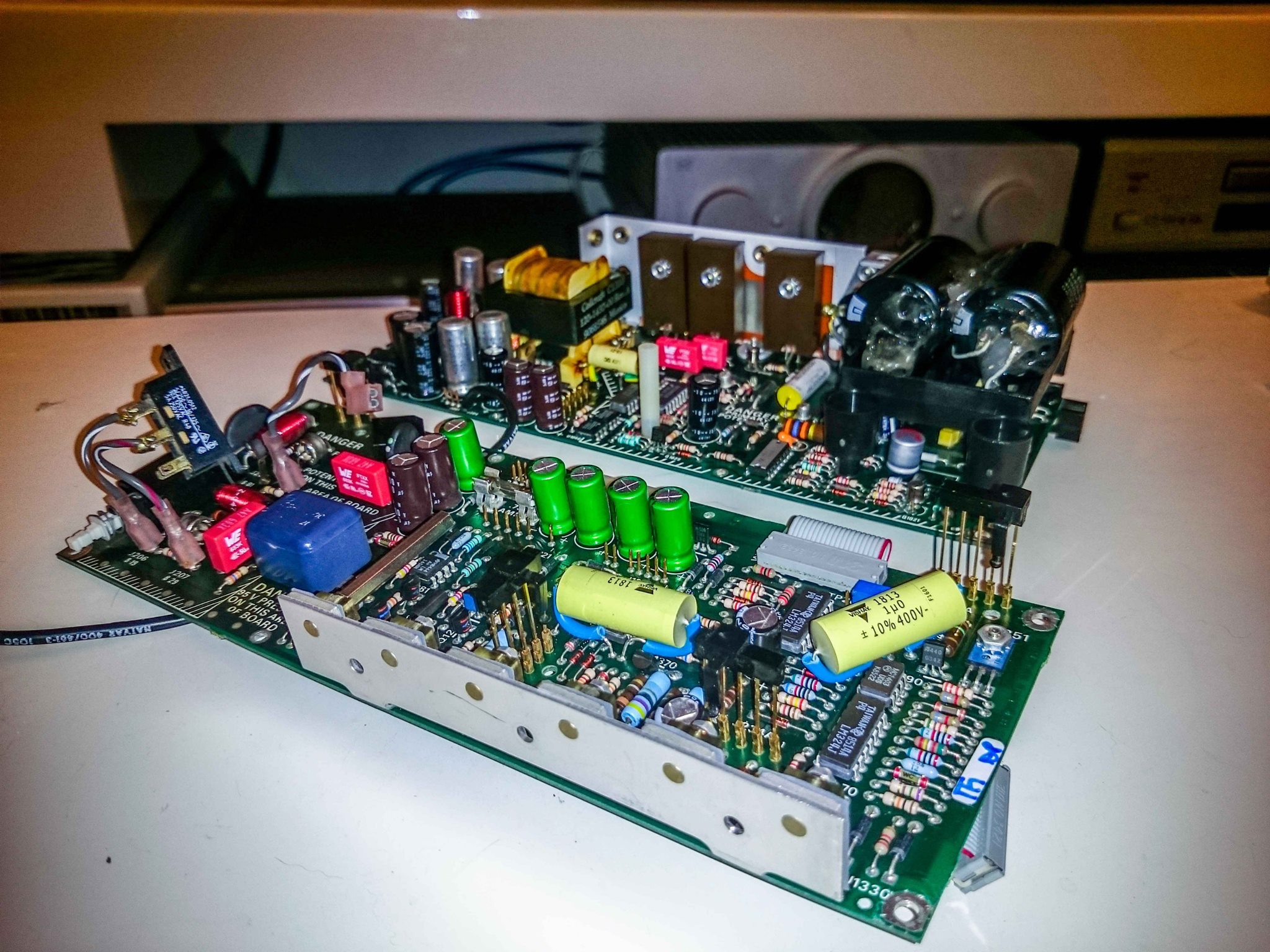

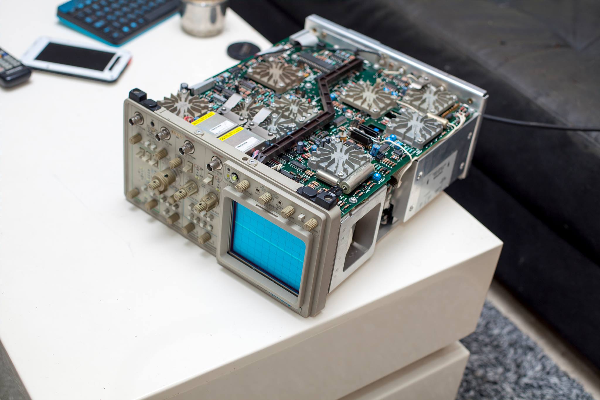

I Dismantled the psu.
I changed the
the orininal Smoothing capacitors
to EPCOS 390UF 400V caps
Strange that the old capacitors were actually good
Even though they more then 20 year old
ESR 0.1 Ohm
The parts that were not good
In power supply
The X2 capacitors
the first one
68NF of course burned.
The other with high ESR
6 Ohm.
2 Bipolar capacitors
1UF
Were with high ESR
4 Ohm.
I switched to film 1UF
VISHAY.
I replaced most electrolyte capacitors.
By tomorrow I hope to finish.
Assemble back will be th
The real headache

I'm sorry but that's hack work! Yes capacitors fail. They are expendable components. But what's wrong with replacing them with the same part or at least an equivalent part.
Is this "it sounds better" at work again?
Think those film caps will work better? What do they do in the circuit? Did you analyze that? Remember that SMPS's work at ultrasonic frequencies, even into the low MHZ in some cases. Now you just added a lot of inductance with those big film caps and long leads!
There are many lesser products out there that can benefit from competent modifications. But Tektronix and HP are mostly above that. Their circuits are very well engineered. I for one would not consider any modification unless there is clear evidence of a design error. And I'm a 35yr EE who is certainly qualified. Perhaps it is that very experience that tells me to leave what works well alone.

For the cost of a BP 1uf cap, wouldn't you rather preserve the original design?
First you are substituting a component with different characteristics. There's more to capacitors than UF and voltage ratings.
Second, that just looks bad. One does not expect to see that kind of rework in Tektronix gear.
I only questioned the "sounds better" idea because a few posts back you wanted to replace diodes with a lower forward drop part. That is highly not recommended. Depending on the circuit function it could be disastrous to the operation of the unit, even cause some damage.
I see from the photo that you've also got a bunch of axial tantalums (yellow bits) on PCBs. I find these pop with some regularity on my old HP gear, so it's worthwhile just replacing the lot.
but sometimes the esr is needed in the circuit - 'the best' modern low esr Al electrolytic (or film) replacements can result in ringing on supply rails - even outright oscillation on some Vreg circuits
sintered tants have reliable esr and were knowingly used with it in mind
I know that.but sometimes the esr is needed in the circuit - 'the best' modern low esr Al electrolytic (or film) replacements can result in ringing on supply rails - even outright oscillation on some Vreg circuits
Usually the LM317 is a problem

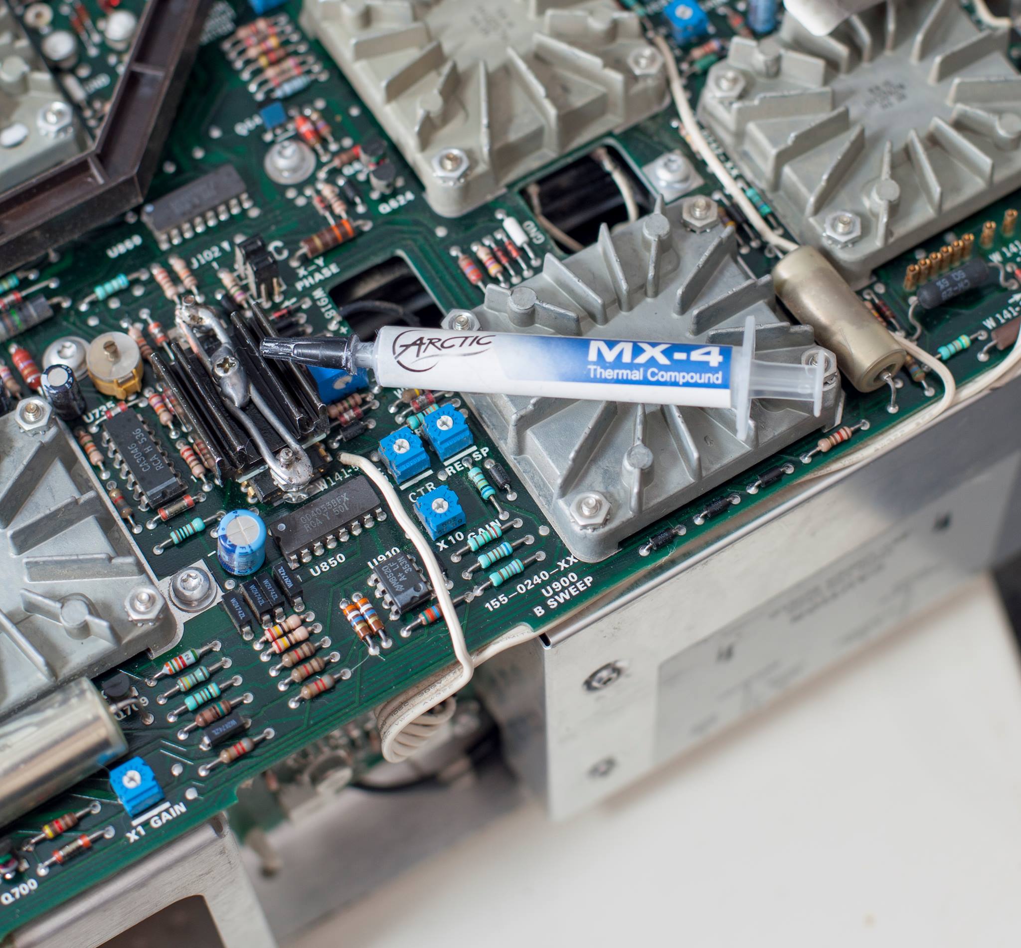

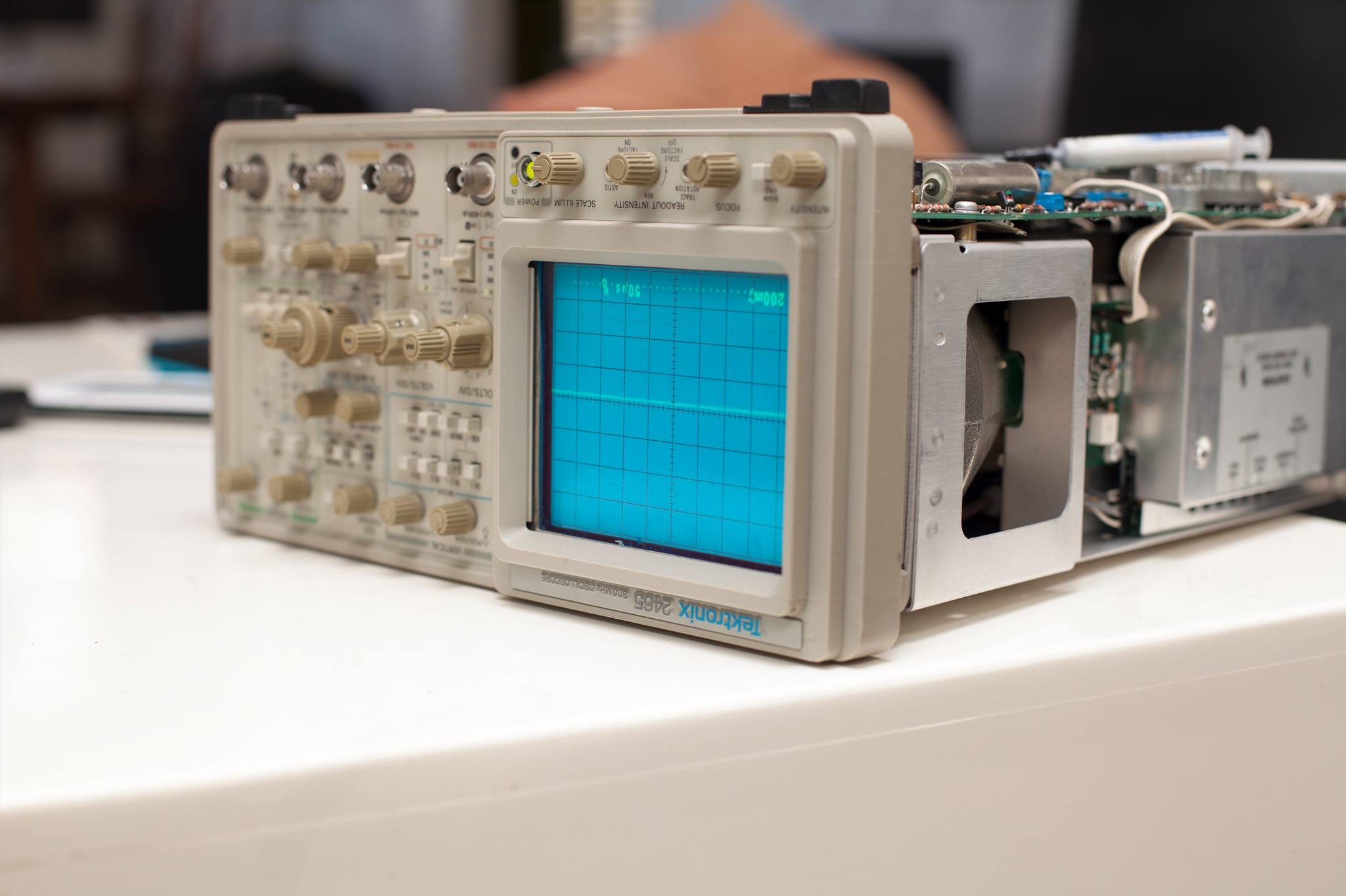

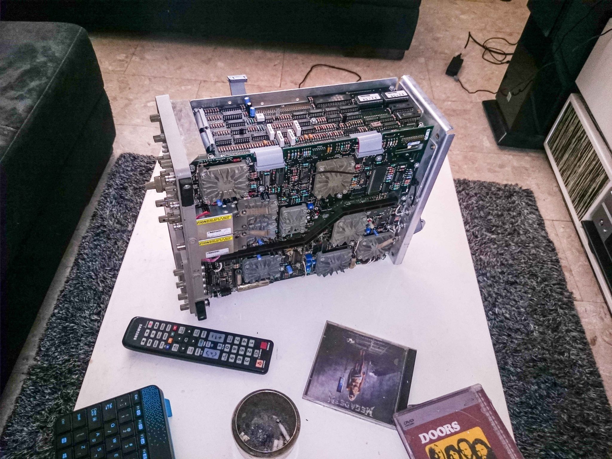

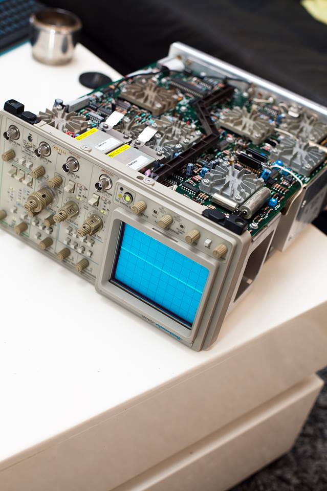

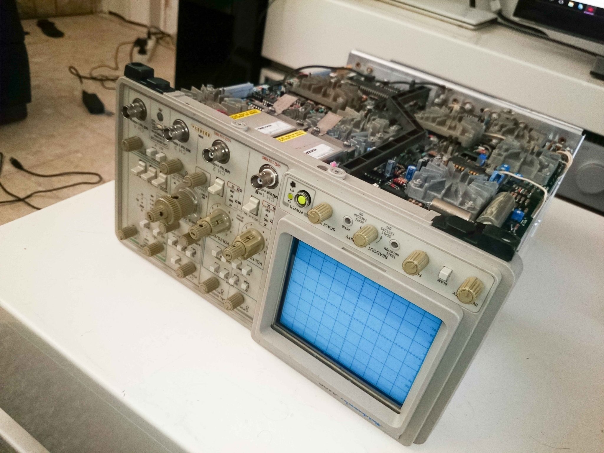

photo time

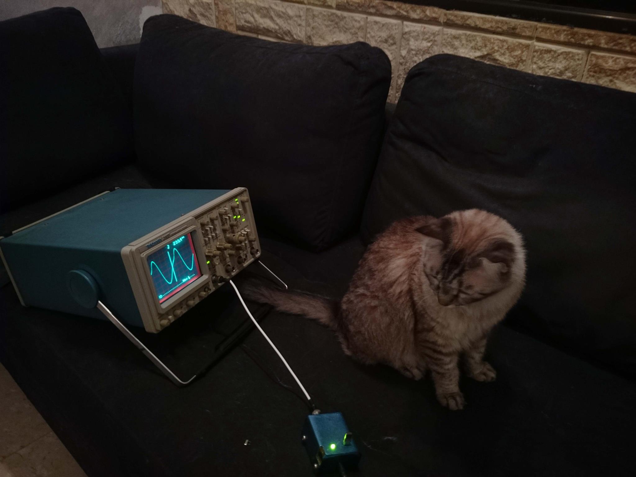

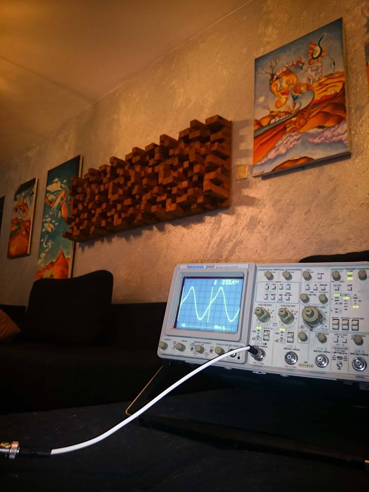

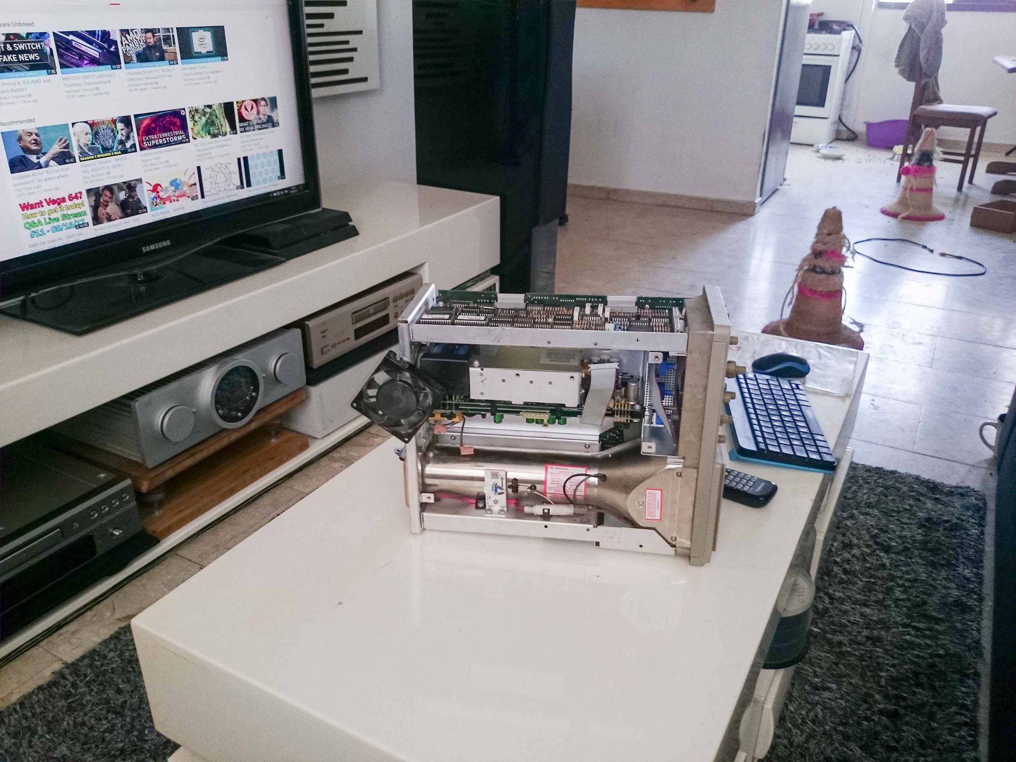

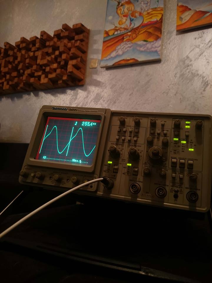

I finished
I put the scoop back together
And he works perfectly.

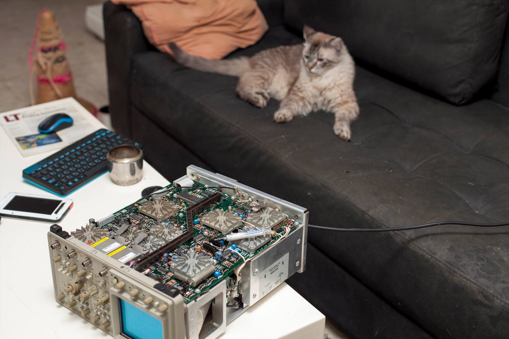

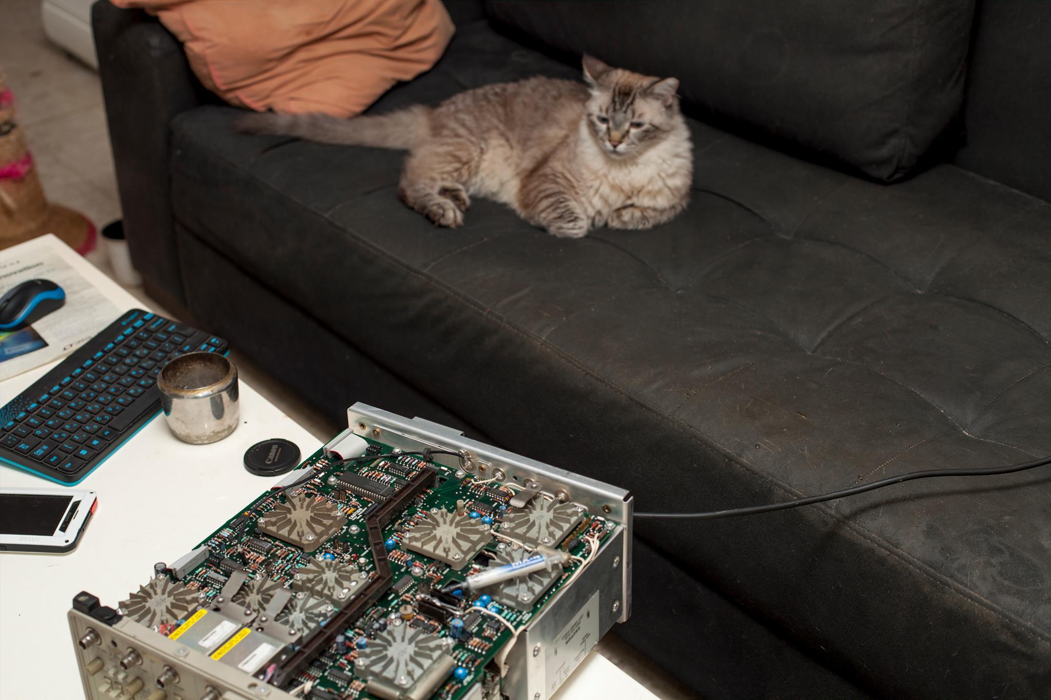

Today I added Heat sink to the UD800 Hibrid ic
and Cooling paste arctic cooling MX- 4
The temperatureon the
UD800 Hibrid ic has definitely dropped significantly.
All that remains is to check that all the voltages are calibrated
And I'm done 🙂
And I'm done 🙂
