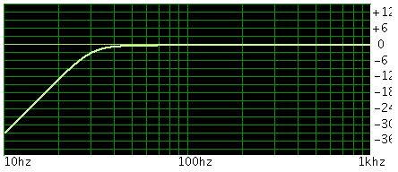

It is not the volume displacement / dollar ratio that interests me. I just want a good quality driver.
A particular Eton driver looks promising too: The 11-581/50 HEX
Quick summary of the specs:
Vas: 153
Fs: 21Hz
Qts: 0.3
Re: 5,2
Le: 1,18
I was trying this with a Vb of 67 and a Fb of 27 which doen't look too bad.

Right, Lambda SB12 in 130 liter sealed box, crossed over with Marchand XM44 somewhere between 100-150 Hz.
At least, thats the plan.
FOr the money (transport and taxes was quite al lot) I could also almost have chosen for a pair of 12" Flexunits. However I just want to try sealed enclosure. This units should give an f3 of 27 hz.
