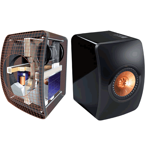

Fwiw here it appears KEF may have decided to include the magnet as a part of the CLD brace in the LS50

if a magnet is vibrating against the frame i would view that as a faulty driver and i've encounter that sort of thing more with stamped frame drivers then cast frame drivers.
part of the reason i asked is i once had occasion to work with a Turbosound rig that had a support structure for the driver magnets which i thought was more for mechanical support (PA stuff can have a ruff life) but after a lengthy discussion with a company rep was told it has a twofold approach mechanical support and vibration damping,so yeah i'm kind of unclear as to why attaching or supporting the mass of magnet isn't considered a benefit doesn't additional mass counter vibration?
