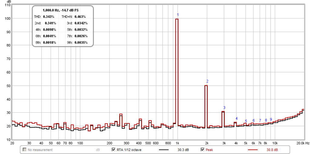

Latest HD measurements of a SS 10F/8424 in a tractrix. 1.64volts drive, mic at 0.5m, produces 98.6dB with 1kHz excitation. RTA shows almost no distortion components above 2nd harmonic. This is equivalent to 92.6dB at 1m, with a little over 300mW of power. One of the cleanest sounding speakers I have ever heard. Again, the material used for the speaker is foam core with latex caulking sandwich CLD.

According to the manual, the values called out in the table are fractional power of harmonic order calculated by order of interest divided by total power (sum of all peaks including fundamental - so you can't just pull of the value from the ordinate of the graph).
Edit -The manual says:
The highest peak is used to determine the fundamental frequency of the input, this
is displayed with the level of the fundamental. The THD figure is based on the number of harmonics whose
levels are displayed and is calculated from the sum of those harmonic powers relative to the power of the
fundamental. The THD+N figure is calculated from the ratio of the input power minus the fundamental
power to the total input power (note that it is possible for THD+N to be lower than THD using these
definitions).
Again, I don't think I'm trying to be argumentative, but, simply put, we're talking orders of magnitude, while the correction you're mentioning will be small, since the fundamental is so large. E.g sum of fundamental scaled to 0 dB and -60 db (0.001) = 1.001. Pretty much just the fundamental; even if you add in 9 harmonics at -55 dB, you're still looking at 1.016.
Makes me wonder if they're somehow hashing in the integral of the noise? But that still doesn't seem to account for the discrepancy. Either way, all these calcs should be done relative to the fundamental.

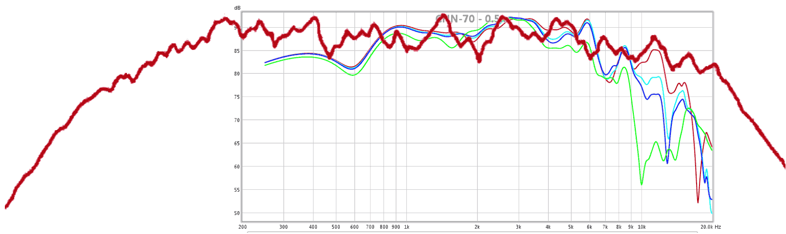

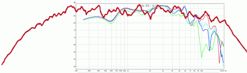

You were the one who called into question my measurement of the CHN-70, claiming my mic was probably bad. It was this plot showing how the CHN-70 as measured by me in an OB and a sealed tapered TL was not the prettiest response, and not anything like the advertised response by the manufacturer.
Subsequent to this, my measurement was independently confirmed by others. As to my "bad" UMM-6 mic, I got another mic, a UMIK-1 that was independently calibrated by Cross Spectrum Labs. A measurement of the same speaker (not the CHN-70) shows that UMM-6 was pretty good and within 2dB of the calibrated UMIK-1 (graph vertical div is in 2dB/div):
There were some data I presented earlier that did not have the gate set to a shorter time to remove room reflections - but that was just a setting in the software. What "iffy" data are you referring to?
One of many and most not by me (on the forum or by private correspondence).
And are you sure it was specifically about that? After all i was the one that posted a compare of yours vrs the factory, and they were broadly the same, yours lacked a lot of detail shown in the factory graph.
dave

REW's tabular calculation of distortions is wack, simple as that. 🙂 I mean, it makes sense from a calculation perspective (integrate over all bandwidth), but that doesn't make them right.
That doesn't take anything away from what you've offered. And the point about CLD (if as simplistic as your application) efficacy is valuable.
