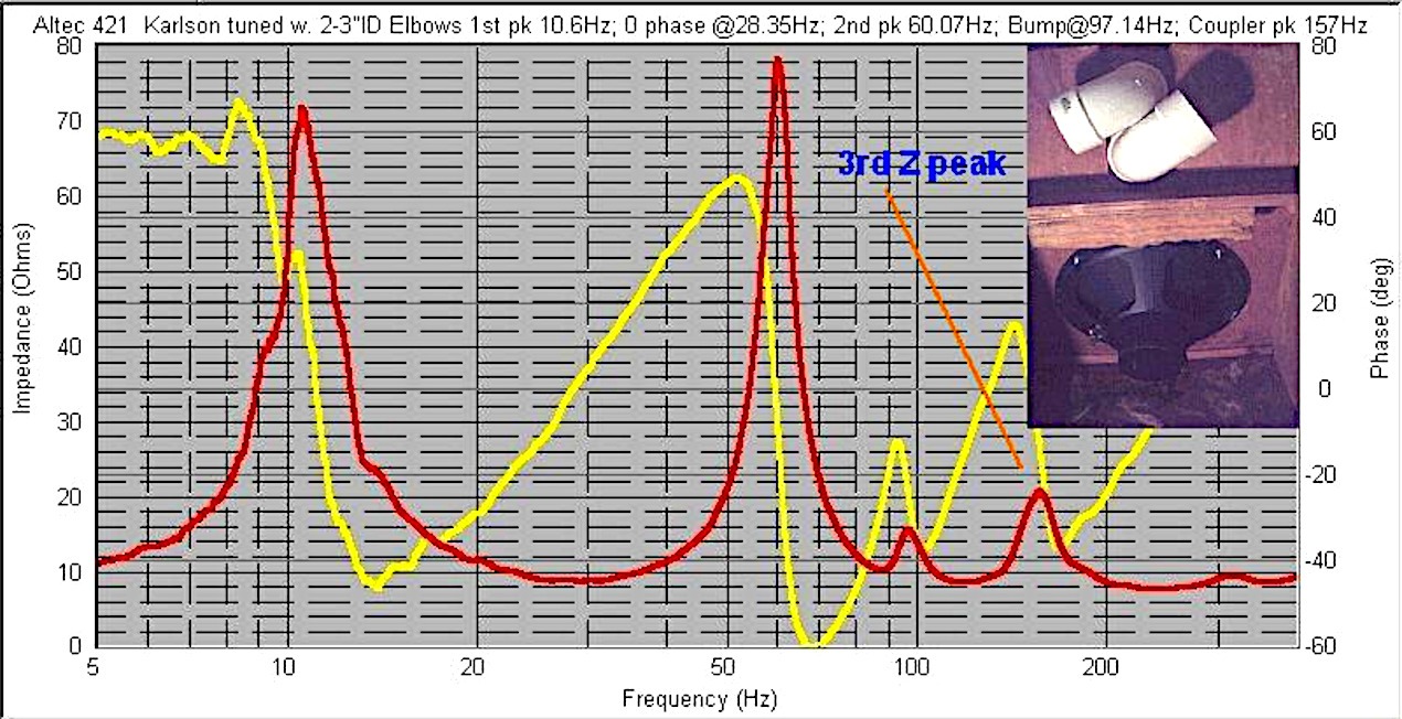

I thought the old Karlson box tuned to ~30Hz and loaded with Altec 15" gave a really nice bass presentation with theater organ CDs. Just take a piece of plywood and mount two 3" right angle elbow and attach that over the stock 4.5" (or 3.5") x 9 inch vent. Stock K15 are tuned around 48Hz or so. Exemplar applied boost at tuning.
Perhaps some of the magic was from the relatively low mass Altec.
I'm not sure how much influence the front chamber had. (A stock K
15 and 604-B/E sounds lovely on Gary Karr's bowed bass but does not go 'low")

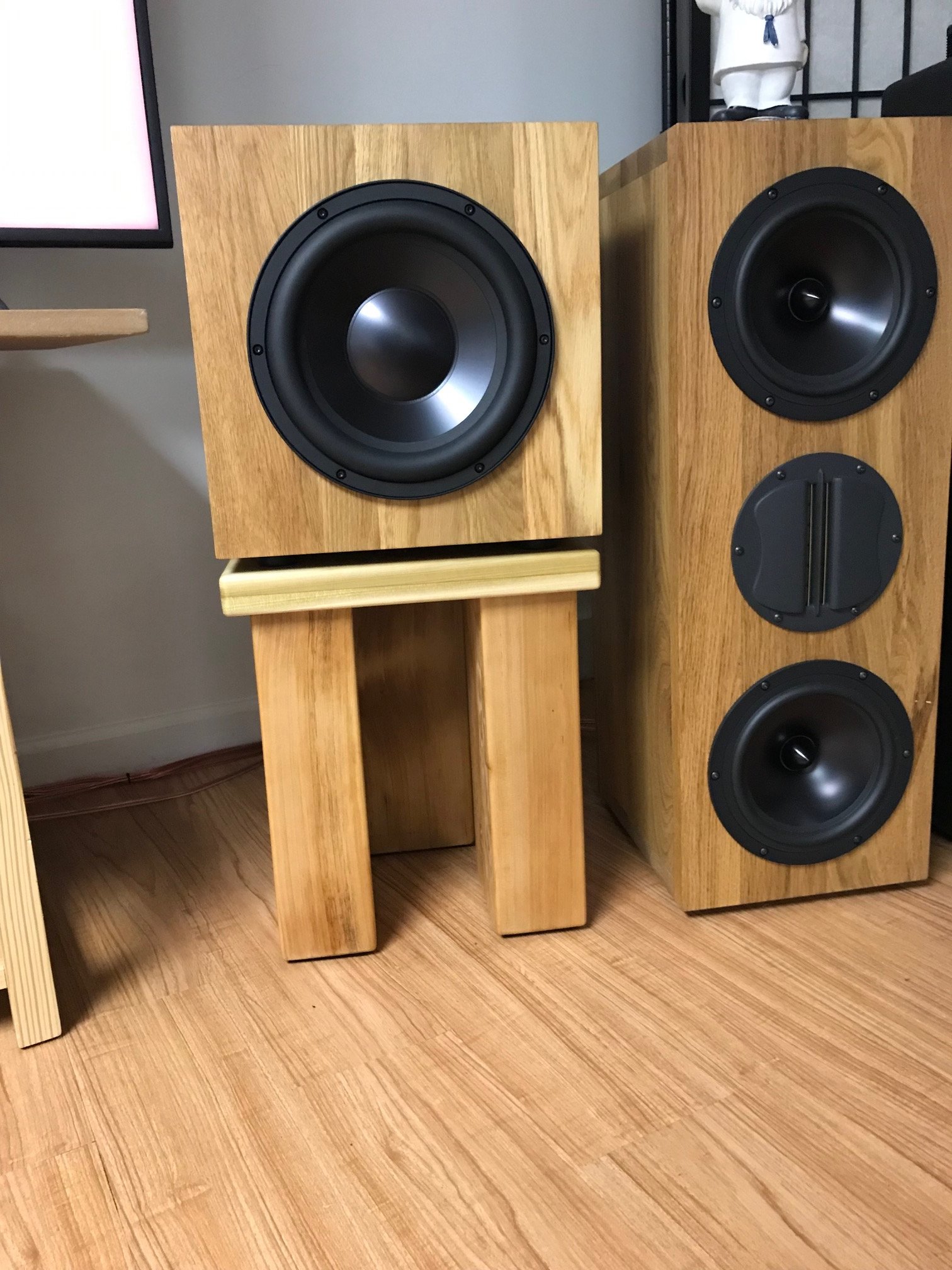

Recently I built two front-firing 10" sealed subs with the Dayton RSS265HF-4. They are impressive but sounded better after putting them on 16" stands.
With the subs on the floor the bass was strong while I was standing and considerably weaker when sitting.
With the stands it's stong and very even everywhere.
Elevating the subs helps to reduce the vertical nodes which can be perceptible when moving from standing to sitting, etc.
