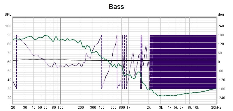

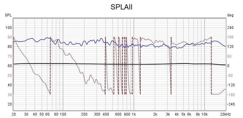

@jawen - about 25dB from lowest to highest. That's not unusual in untreated rooms.
Did you measure both speakers at the same time? Try to do R, L and R+L.
No No, just did a super spontaneous fast sweep in the situation i have at the time, my daughter and 4 of her friends was in the way and was making the bed near the speakers. ( between speakers and listeningpoint, in the feld if you say so)
Mic maby 25 grades at left side of center Left speaker so no L and L or LR measure, just a bad L ( but sound is still so good ) when you listening "from the side"
Hope i have "the power" to do some more mesaurements even if im so happy with the total sound from listeningpoint
It´s real interesting to se a curve after you know you really like the sound.
And I know people just want to show their fancy measurements, but I'm more honest than that so I show everything...Life is short!

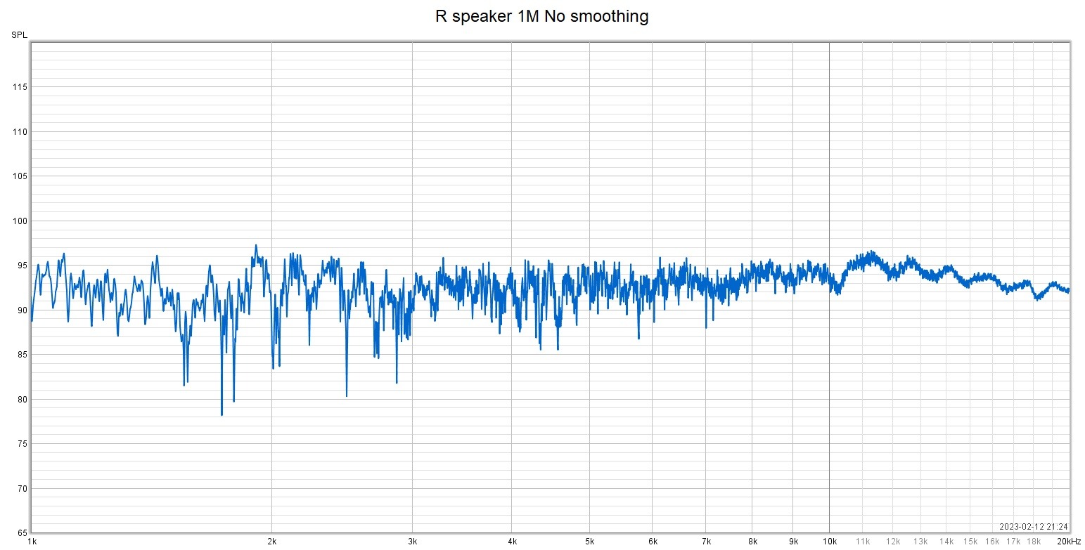

From same mesaurement, what does it shows ?
Same thing, different view, Is this the 1m?
1, 5 meter from speaker ca 20 cm from the center of the speaker

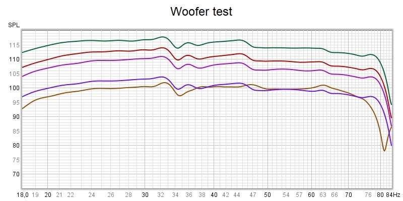

Made a couple of measurements tonight, and I have a 15 dB dip between 160 - 500 hz (which feels weird)
And i must go to the bottom with it, maby start over with midrangedriver measurement without xover at the actual baffle in the room.
Did some near field measurements on 1 of the woofers also at different volumes.
My back hurts like hell now after crawling around.
