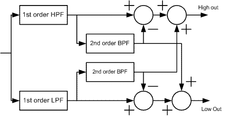

And what about notched symmetrical subtractive phase-accurate active crossovers ?????? :

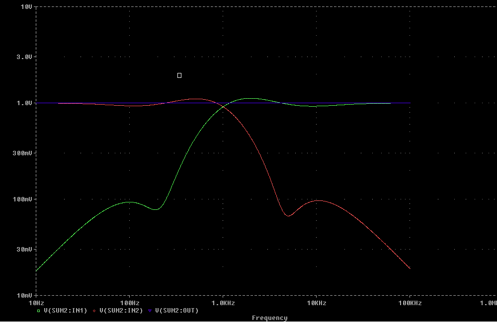

I've simulated the Thiele's 4th order passive crossover using Tina.
Crossover at 1000 Hz, notches at 500 and 2000 Hz. The frequency response is very flat.
I then tried to obtain the same results using Bainter's notch,
crossover at 2000 Hz, and notches at 1000 Hz and 4000 Hz.
Despite experimenting with many various values, I could not get rid of response variations, at least 1 dB,
I feel a bit lost with what should be the Q of 2nd order filter section and how to set Bainter's circuit.
Can someone help ?

Below is an example of one combination that could be built with the board. The response uses a 4th order Butterworth plus the notch. The 4th order Butterworth response without notch is shown as a comparison:
