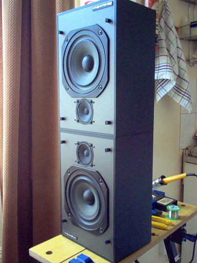

The towers I am building will measure 49"H x 7.75"W x 12"D, with the front baffle being 49" x 7.75". I want to create an MTMWW design, sectioning off the woofers into their own ported space. The space for the woofers will be 1.16 cu ft, leaving .55 cu ft for the midranges and tweeter.
The drivers:
Tweeter - Dayton Audio PT2C-8
Midrange - Dayton Audio ND105-4
Woofer - Dayton Audio DA175-8
I'll add some additional bracing, but the interior of the box will consist of 2 chambers, the bottom one for the woofers, which will be ported, and the top chamber for the midranges and tweeter, which will be sealed. Would someone be able to use some modeling software to help create a crossover system? I'm fairly open to different driver suggestions if these don't pair well. The amp needs to see between a 6 - 8 ohm load. At this point, the only reason of the mention of the center channel, is because I would like to use the same midrange, tweeter, and crossover (minus the woofer) in an MMTMM design, and would also like some input on that idea.
I'm extremely new to speaker building so any and all advice/criticism is welcome.

Could I use this, except wire the woofers and midranges in parallel with each other? It has a 2db bandpass gain which will help the midranges spl match the woofer's, and then I could use an l-pad for the tweeter. Assuming I would wire the other 2 speakers in my MTMWW in parallel with their match, using 8 ohm speakers would result in each driver circuit (mid or woofer) seeing a 4 ohm load, is that right? Then wire the woofers to the mids in series, to bring the load back to 8 ohms, then the tweeter in... series with the mids?
My friend, I think this is WAY too ambitious for a first project. You don't even have a crossover, and I suspect 4 ohm midrange will take impedance far too low. Even conventional 3-ways often hover around 4 ohms impedance.
3-Way Classic
You COULD take any good conventional 2-way design, and double up the woofers wired in series for the same SPL or loudness. The bass crossover gets coils and resistors doubled up in value, and the capacitors halved in value, by one of those neat quirks of the maths. The treble filter is unaffected. That gets you your MTM with a highish impedance. Come to think of it, you could do something similar with a 3-way.
The parallel wired MTM, by contrast, takes impedance lower and drives the tweeter harder.
I don't think anyone here has the time to nurse you through this, so I'd suggest you build an established design within your capabilities.

I didn't want to sound too discouraging, but I do think you're taking on a huge project there. At least, for someone new to this.
I can suggest you look at some similar projects, like this Visaton Experience V20:
EXPERIENCE V 20
Visaton provide a free Sim program called Boxsim:
Downloads
They also give away the BPJ project files which you can copy to the projekte folder in Boxsim, and it has done all the work for you including cabinet:
Boxsim Projektdatenbank Experience V20
Maybe not exactly what you are looking for, but you could then try Visaton's own ribbon tweeter in the sim and see how it all looks. Boxsim is incredibly versatile when you get to know it. You can fiddle with cabinets and optimise to your hearts content. I got the hang of it in a couple of hours. Probably best to learn your way round with a simple 2-way at first.
BTW, your idea of wiring the drivers in series with an MTM to raise the traditionally low impedance is quite feasable. You can do that in the sim too.

There IS a way of making your own MTTM easily enough out of two-ways. You'd probably want to get the tweeters as close as possible to each other, but there is a school of thought that MTTM works even better than MTM because it matches the drivers for a cylindrical response.

If I'm trying to build a speaker for an 8 ohm receiver, what is the minimum recommended system impedance that should show? I get dips down to 3 ohms, I have a feeling it would throw my receiver into autoprotect almost right away.
Phase - I know phase is vital when talking about left and right phase of stereo speakers, so I bet it's just as important with crossovers. How far off can phase be before I would be able to hear it in the speakers? Do all the vertical phase lines need to be lined up, dead accurate?
System response vs power response. System response is what I'll actually hear, and power response is what the drivers are actually playing, is that correct?

Can someone explain how I am supposed to align the driver phases?An externally hosted image should be here but it was not working when we last tested it.
Good phase comes with the filter topology usually. A 3-way, which is what you are really designing here, has certain styles of filter that just line up nicely on phase.
Start with this Troels design and similar drivers, and you should be close to lined up on phase anyway. It is a classic filter design.

I don't know how your software works, but in Boxsim, you just mark a few components in red and click on "optimise". I would add a couple of attenuator circuits on the mid and tweeter to let Boxsim adjust levels too. It does a decent job of adjusting for flat response and good phase and impedance usually. 3-ways are quite hard, but you'll get there. Phase should be matched within 10 degrees at crossover IMO.
Converting to an MTM style is then fairly trivial. I explained how you do it earlier. I also suggested you started with a two-way, because it's easier, but you're not listening.
For an AVR receiver spec'd for 8ohm speakers you are definitely good with a 6ohm minimum. Below that, the answer is it depends. You are probably good with 5ohm minima if the impedance phase angle is also benign. You might be good down to 4ohm if the phase angle is also shallow and you are not pushing the low frequencies through the speakers (ie, you are crossing at 80Hz to a sub) and you are not playing them very loud and the minimum impedance isn't at the lowest frequencies. Might. This article might offer you a little more insight.
Setting the A/V Receiver Impedance Selector Switch | Audioholics
So smartest thing to do would be to keep the speaker impedance above 5 or 6ohm and cross all speakers to your sub at about 80Hz. This means you don't really need a 3-way, though you can still go that way if you want.
You also have to live with the impedance you get when you wire 2 drivers together either series or parallel in each specific "way" - the tweeter, mid and woofers in a 3-way are already effectively wired in parallel but their impedances operate separately when they each have their own xo's.
So for your AVR, 2 x 4ohm mids either series but definitely parallel won't work. Even 2 x 8ohm drivers in parallel in a 3-way are probably going to result in a minimum impedance too low for your receiver. You must wire them in series or choose a higher impedance driver. Parallel is the better choice because you get an extra 6dB of sensitivity out of them and that means that your receiver has to do less work which is what you want.
You might want to look at something from GR Research who make some of their drivers in 16ohm versions. Speaker kits, loudspeaker design services, sub-woofers and amplifiers. - Drivers
The MTM decision is not a bad choice for your situation. Nor is the ribbon or planar choice. However the choice of a tall ribbon or planar means a larger center-to-center spacing between the mids which you want to keep as tightly spaced as you can. This might be a better choice but there are others too: Fountek NeoCD1.0 Ribbon Tweeter | 296-701. Even better if you cut the flange off at the top and bottom. There's also an advantage to choosing small mids in this respect and this works well too when converting the design to a center channel. I would try to keep the WMTMW format there as well. In home theater, the center channel is really the most important speaker. That and the sub(s).
You are on the right track with PCD. Stick with that. Phase in your example is well aligned where it needs to be - where the driver frequencies combine together in the xo regions. Having the vertical part of the phases line right up at the xo's is perhaps ideal but isn't necessary - sometimes the phases will track together for a greater frequency range at other points. Reverse the polarity on the mid in a 3-way and you will also see deep nulls at the xo's when the phases are properly aligned. But do yourself (and us) a favor and read the manual completely.
Power response is a mathematical construct of the total frequency response in 360* space, ie all around the speaker. It is correct for it to be lower in the higher frequencies. It's important because you hear not just the direct, on-axis sound but also the reflections of sound from all around the room.
PCD or any other program is only as good as the data that you feed in to it, so make sure that you get that right too. Box response, baffle diffraction and extracting minimum phase must be done correctly or you're just working with bad data. It can help to be using reliable 3rd party data when you are unable to measure yourself. Try Zaph|Audio. Some manufacturer's data are not to be completely trusted.
