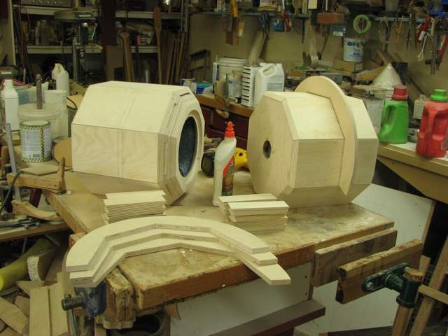

Thanks Z! Unfortunately the drivers really won't be seen in the end product.

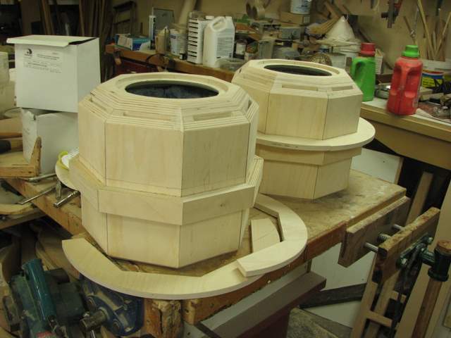

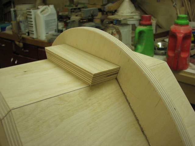

Cleaned up the front bevels like this.
nice work Douglas - almost a shame to hide these in the mesh globes

Next up on the cabinets is to do some sanding and make a flange that goes around the middle for mounting in the globes. I need to get a move on in making the globes, but I am out of fiberglass and resin right now and I have to wait for my bank account to get healthier before I drop more money.
I can start fabricating the console box while I wait as I have material on hand for that, including some really old Brazilian Rosewood veneer plywood that came out of my parents' house (went into the house about 1970)

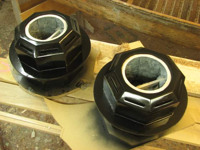

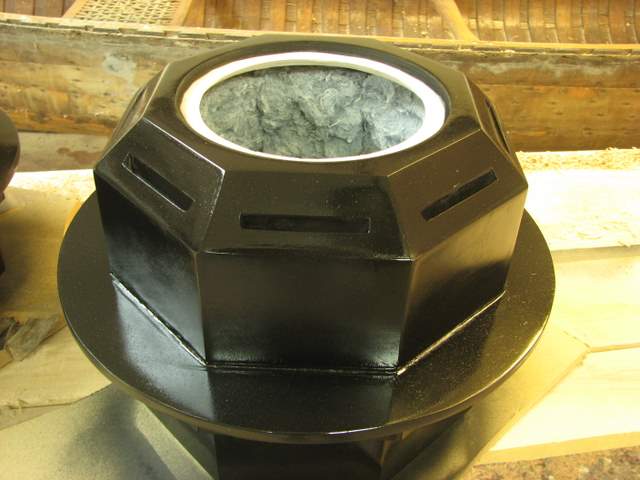

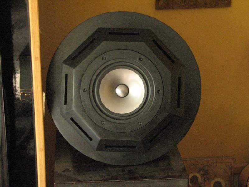

I am declaring these cabinets finished. I worked through the finishing process, refining the surfaces with each stage. In the end, I decided that I preferred the look of the paint rubbed out with 0000 steel wool, which gives a nice satin look. The high gloss was too glossy, and showed up every single imperfection!
The end result keeps reminding me of the Death Star from Star Wars. It is a very singular look.

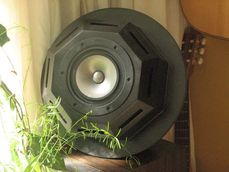

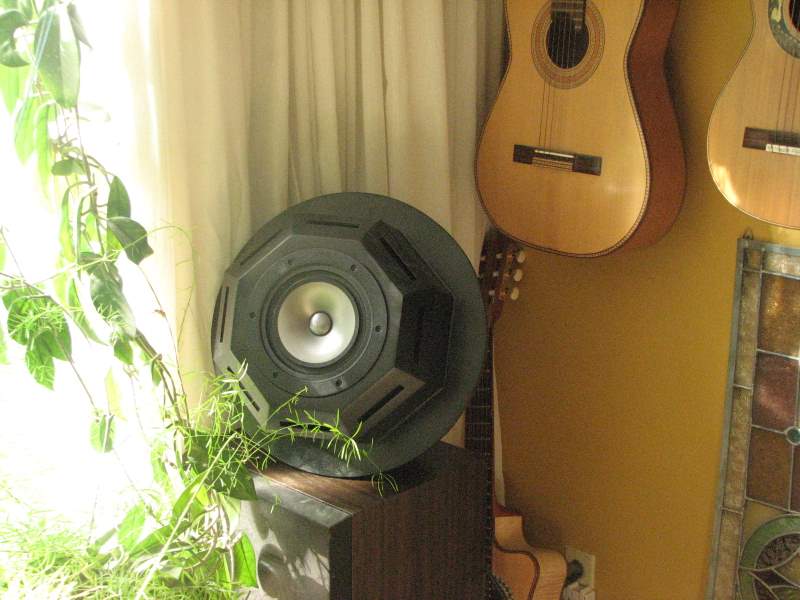

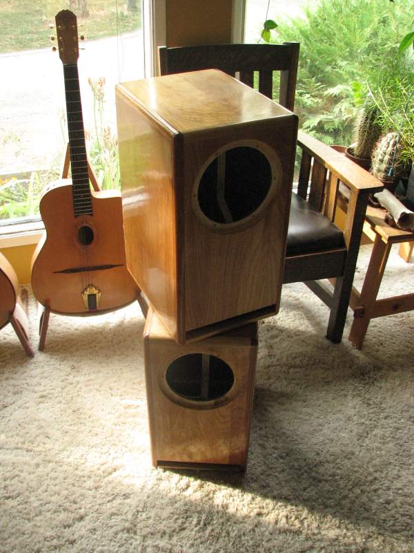

I moved my Alpair drivers over to these last night and got them fired up. While the sound very good, there is a definite difference from the Pensil series Studio Reference Monitors which now sit forlorn and vacant.
First impressions are in line with what Dave had already indicated, that these new cabs don't have the bass extension of the Pensils, favouring bass precision over extension. The bass is there, just different. They also have a different sense of "air", or space, about them. I'm going to have to live with them for awhile to get a better read. I've been listening to the Pensils for quite awhile now and they have become my "normal".
