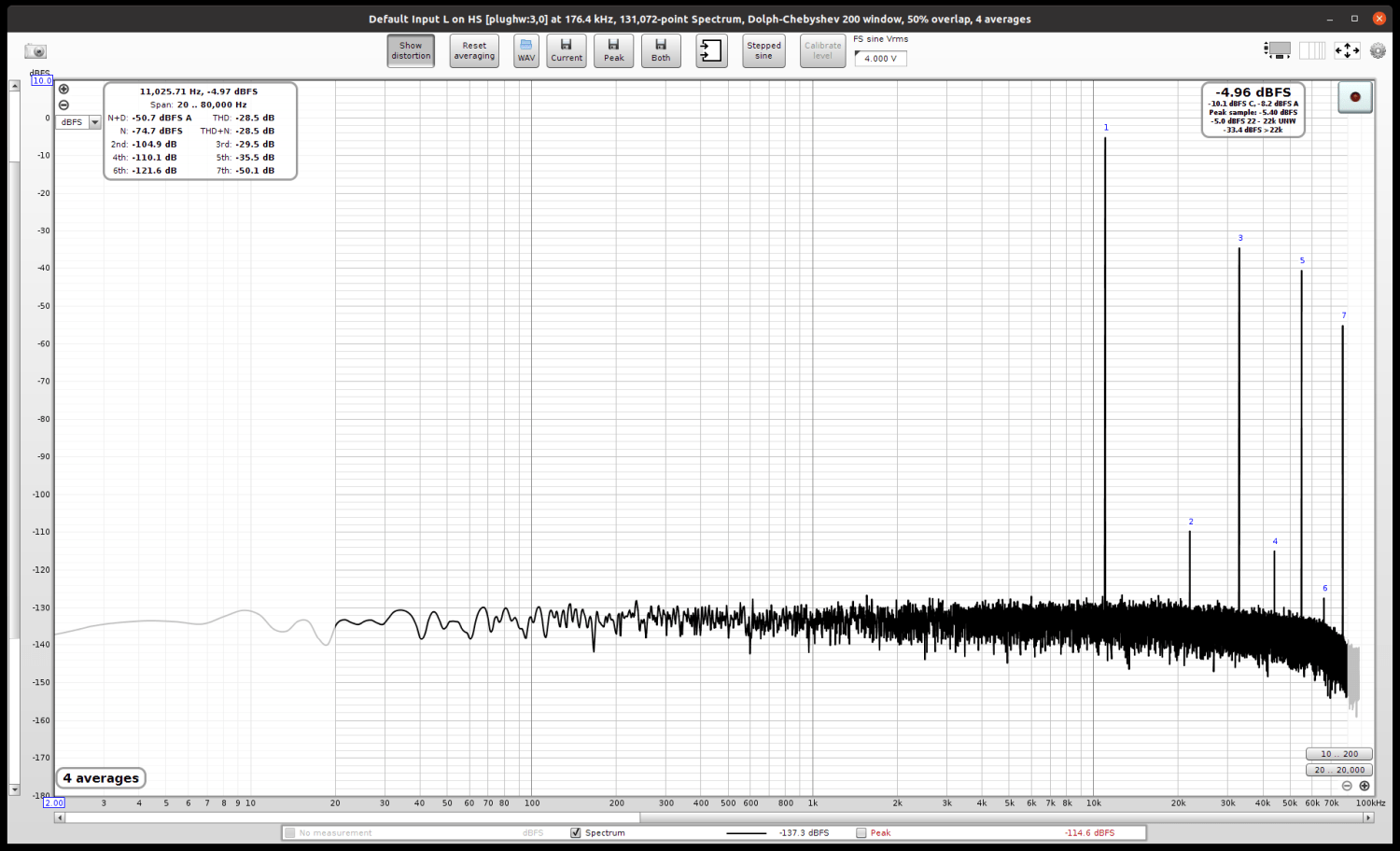

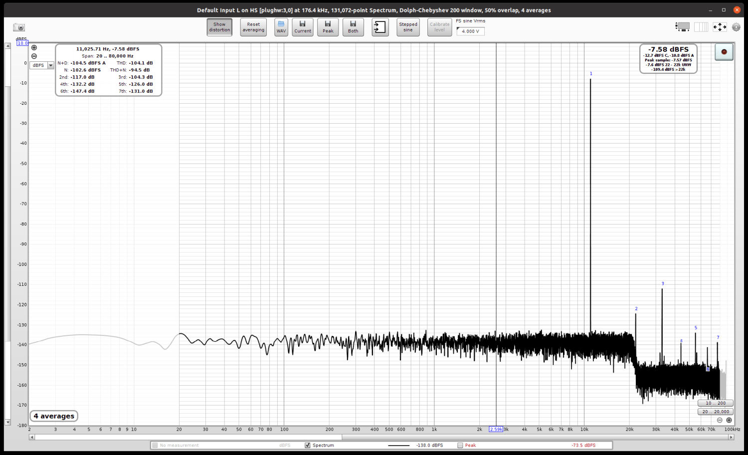

I made some measurements with both my AK4490 and ES9038Q2M dacs. I used Autoranger between DAC and ADC at -6dB setting to lower the DAC output to avoid clipping at ADC. I used Sox to play the files.Attached is a zip with two wav files of 10 seconds each, one peak sample normalized and one not.
A disadvantage of testing with just one 11025 Hz sine wave is that the distortion products are all ultrasonic; with symmetrical clipping, the first distorion product will be 33075 Hz. That could lead to wrong conclusions when you have a DAC comprised of something that clips followed by a 20 kHz low-pass filter. The first distortion product is also on top of the first image, so the poor image rejection of NOS DACs with just a zero-order hold as reconstruction filter could be mistaken for clipping on intersample overshoots. All in all, I much prefer the test of post #127.
At 44k1Hz FS only 11025Hz was visible as predicted with both files. So I made more measurements at 176k4Hz fs.
Here is 11025Hz at 0dBFS.
So no clipping artefacts visible. The strange noisefloor is probably due to original file being resampled by Sox.
Next 11025Hz normalized at 0dBFS
As MarceldvG predicted heavy clipping is visible.

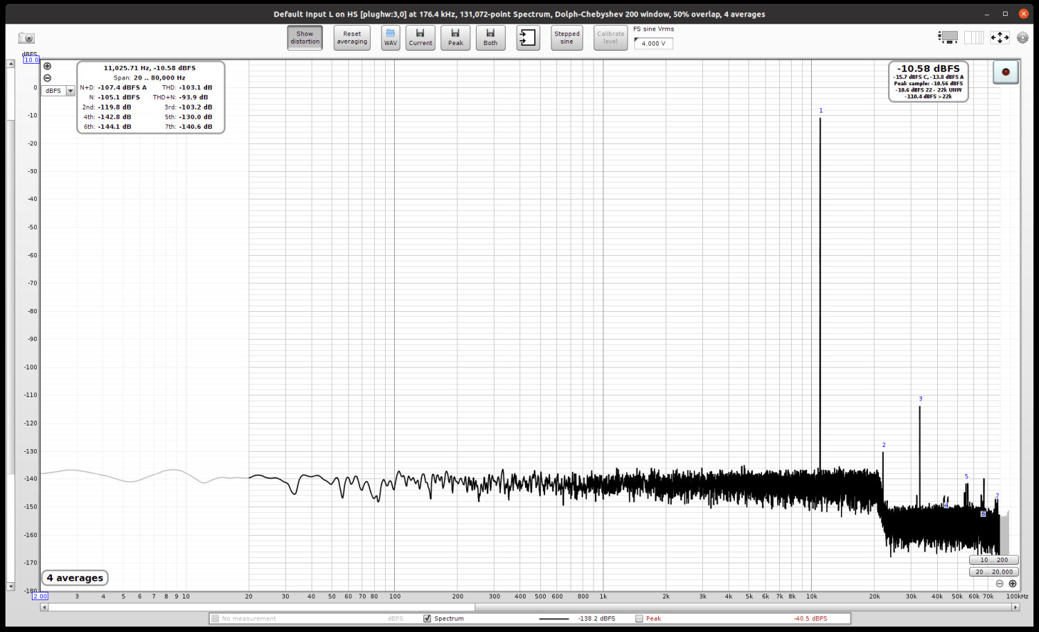

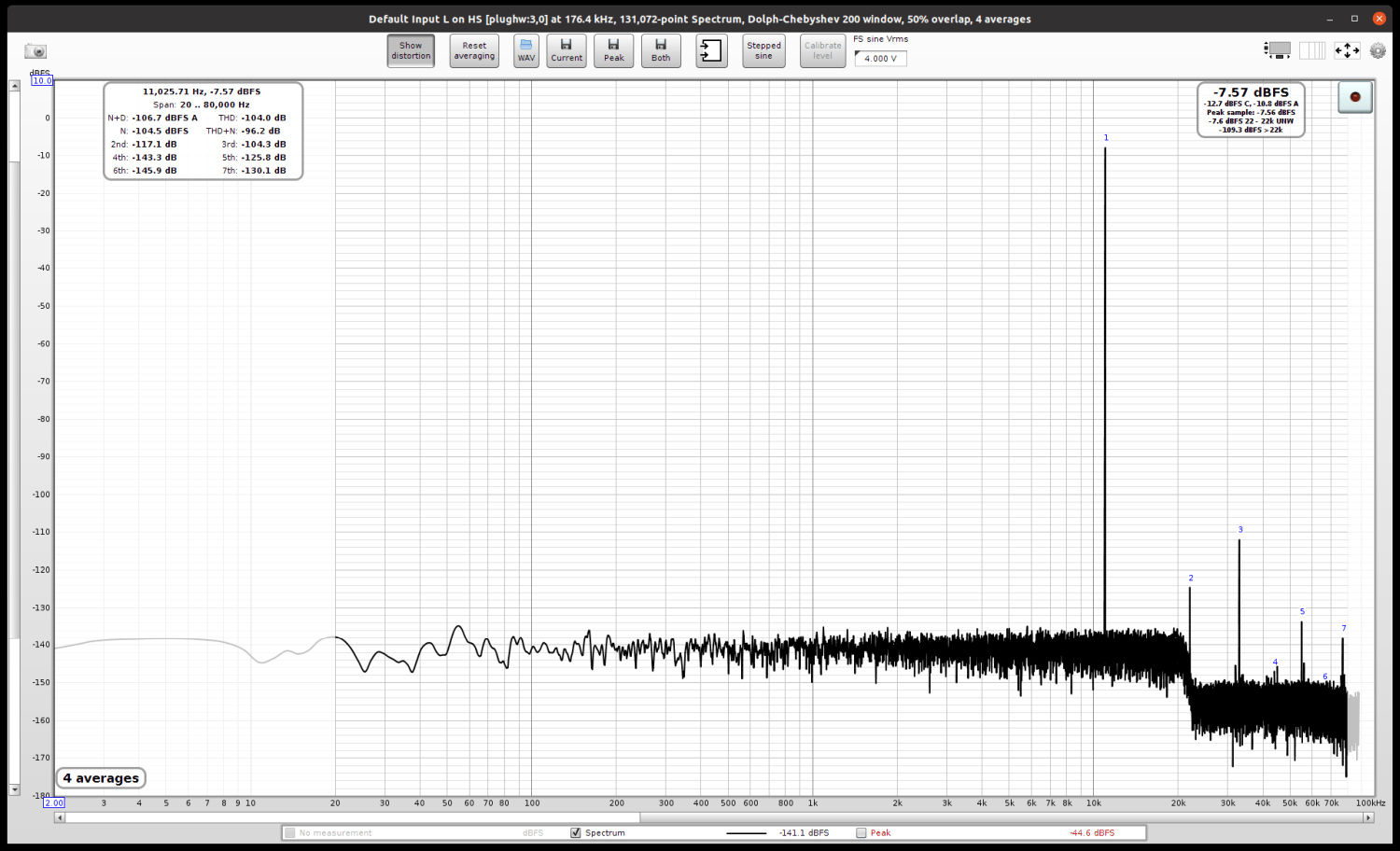

Then I lowered the DAC digital volume to -3dBFS.
Here is 11025 at -3dBFS
So more or less the same as at 0dBFS.
11025Hz normalized at -3dBFS
Clipping artefacts are gone which indicates that the digital volume control operates before filter with AK4490. Same applies to ES9038Q2M so no need to repeat those measurements.
So IMO this intersample overshoot is a real problem but can be quite easily avoided with lowering DAC digital volume to e.g. -3dBFS at least with AK4490 and ES9038Q2M (probably applies to all modern AKM and ESS dacs).

Does it contaminate the audible spectrum? I seem to be deaf to >30KHz.
I don't fully understand you. Do you use a program called Sox to interpolate the signal to 176.4 kHz sample rate and then put it into your DAC or do you only run the ADC at 176.4 kHz sample rate to see the ultrasonic distortion products?
The step in the noise floor looks like the 16 bit dithered noise of the file, filtered by an interpolation or reconstruction filter. Nothing alarming anyway.
Try the intermodulation test of post #127, https://www.diyaudio.com/community/...quality-between-some-dacs.386815/post-7040483Does it contaminate the audible spectrum? I seem to be deaf to >30KHz.
I thought I was running both the DAC and ADC at 176.4k and Sox resampling the file to 176.4k but actually I did not check so I'm not sure if it was only ADC running at 176k4. I could repeat the test to make sure that DAC is running at 44k1 and ADC at 176k4 but would it really change the outcome?I don't fully understand you. Do you use a program called Sox to interpolate the signal to 176.4 kHz sample rate and then put it into your DAC or do you only run the ADC at 176.4 kHz sample rate to see the ultrasonic distortion products?
